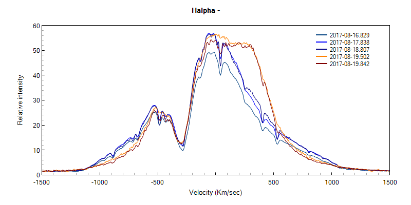

An update with Terry's spectrum which confirms and precises the fast change of the Balmer lines profiles

Joan,
- Could you explain the treatment with Umberto's spectrum?
- Yes, the emission of Balmer, almost null at maximum luminosity, strongly increase during the decline
(The photosphere receeds, its temperature increases, thus shift of the peak to UV and decrease of the visual luminosity at constant bolometric luminosity - this is the general behavior of the nova decline - the ionisation rate increases (followed by recombination and thus emission)
- The general appereance of the evolution of one line strongly depends of the wavelenght choosed for normalisation
- The best way to show the evolution should be to convert the spectra to flux using aavso database (and also Paolo's photometry)
- I think that the most important aspect of this wonderfull series is the profile of the lines (Balmer and Iron) and the fast change, now clearly established, between Paolo and Terry spectra
- The best way to study the evolution of the shape should be to normalize *also* the maximum intensity of the lines
- The ejecta remains optically thick and forbidden lines are still missing 2,4 mag under the maximum

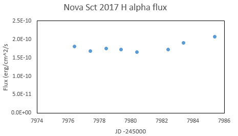

Posted: Mon Aug 21, 2017 5:39 pm
Hi Joan,

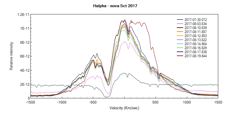

Here's a first attempt with flux calibrated spectra (using AAVSO V Band)
The emission increased strongly just at the begining of the optical decline, then the fux is almost stable until the fast change which occured between 2017-08-18.807 and 19.502
H alpha flux
Error ~ 5%

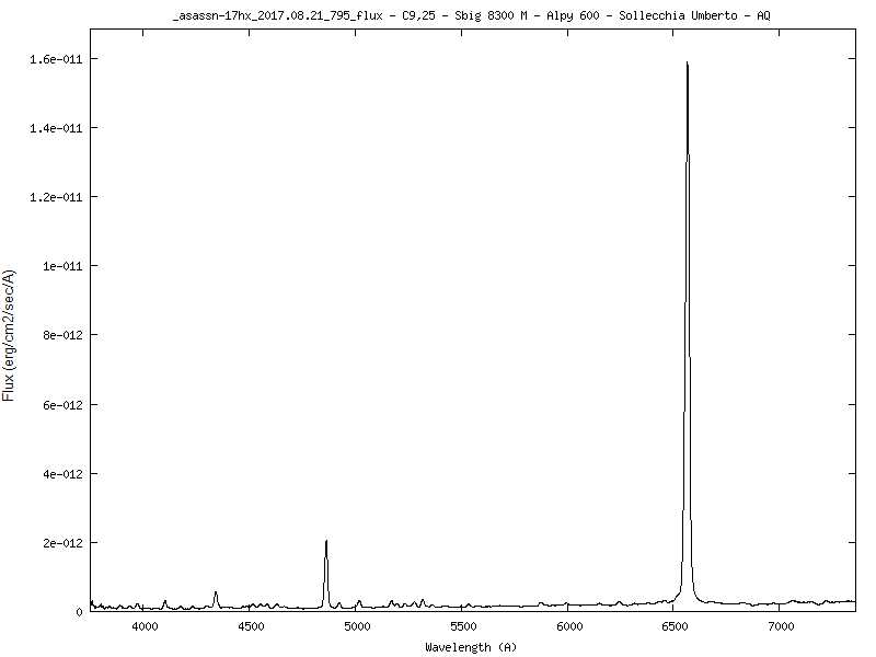

by umberto sollecchia
Bonjour à tous, il profilo della nuova osservé le soir du 21/08/2017. Umberto
Profilo Flux.jpg (23.71 KiB) Viewed 10210 times

Hi to all, ( Buongiorno Umberto !! ),
Hydrogen has started a downward phase.
Cheers, Joan.

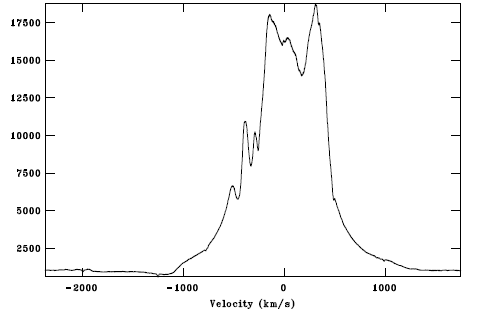

Posted: Sat Aug 26, 2017 10:06 am
A spectrum obtained by a professionnal team on 22th with UVES
H beta line
H alpha is saturated in their spectrum, thus they are very interested by the spectra in ARAS data base around this observation

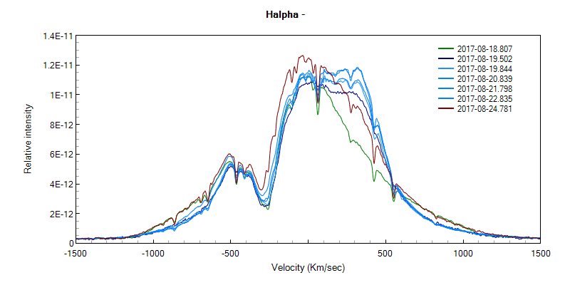

Paolo detected (on Aug. 24) the decline of the emission detected in the red part of Halpha
Evolution with spectra obtained by Joan, Paolo and Terry
normalisation of the continuum at ~ -1500 km/s
Note that the wings (> 500 km/s) are recovering the same shape than before the transcient emission detected on Aug 19.502
Congratulations for this excellent monitoring!

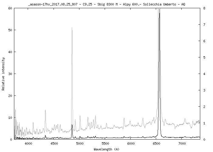

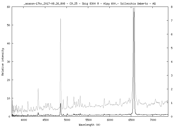

Posted: Sun Aug 27, 2017 6:33 pm
Bonsoir à tous, les profils de la nova observé le jour 25/08/2017 et 26-08-2017. Umberto
