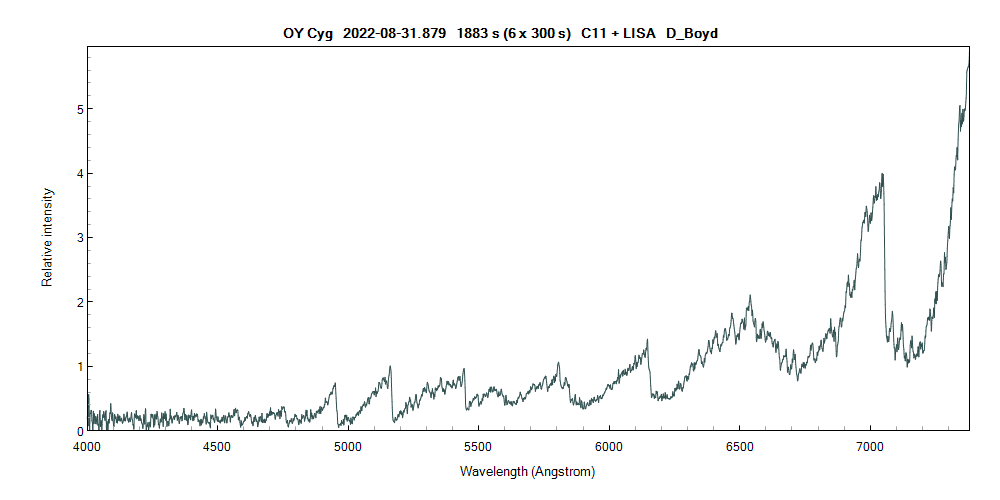

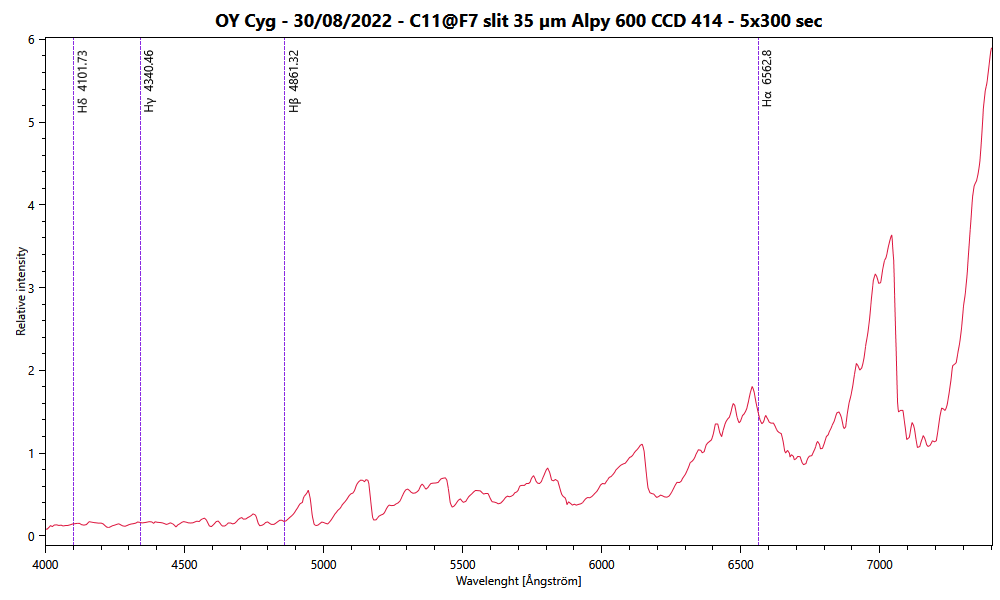

Posted: Thu Sep 01, 2022 11:27 am
by David Boyd
Guider image of OY Cyg
OY Cyg guider image.png (20.97 KiB) Viewed 27843 times
Spectrum of OY Cyg
OY Cyg.png (35.48 KiB) Viewed 27843 times
Looks like a M6III - M7III spectrum.
Posted: Thu Sep 01, 2022 8:08 pm
by JP Nougayrede
Same result as David and Vincent on OY Cyg, albeit in low resolution

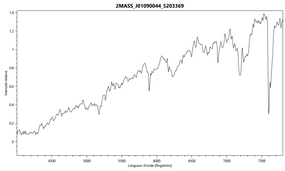

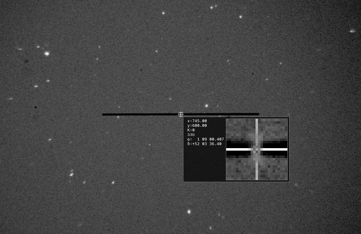

Posted: Thu Sep 01, 2022 9:29 pm
by JP Nougayrede
2MASS J01090044+5203369 in Cassiopea
C11@F7 Alpy 600 slit 35 um CCD 414 5x300s
Guide image and astrometry
Jean-Philippe

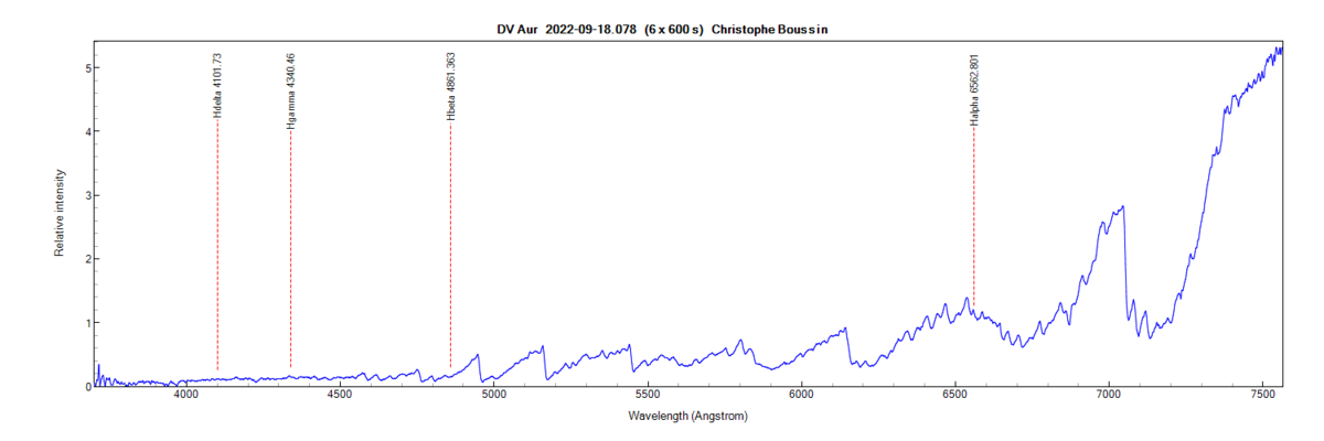

Posted: Sun Sep 18, 2022 5:19 am

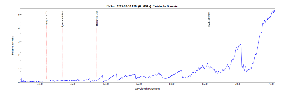

by Christophe Boussin

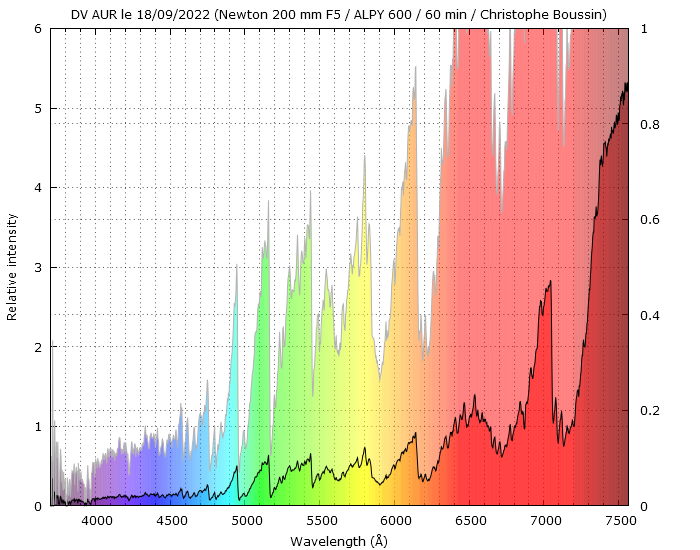

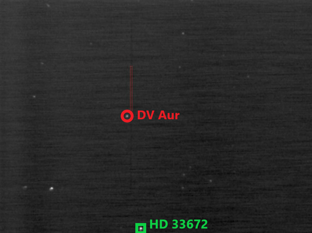

Here is my new contribution to this classification program with DV Aur which is identified as a long period variable in the Simbad database.
I obtained the following spectrum of DV Aur the 18th of September at 1 h 52 TU with my Alpy 600 (resolution of 509, JJ = 2459840.5781) and an acquisition time of 60 min (6 x 600s) :
DV Aur on September 18th, 2022
_dvaur_20220918_078_Christophe Boussin_3700_7565.png (92.15 KiB) Viewed 27450 times
Guiding field
Guiding field
CHAMP DV Aur_legende.png (453.88 KiB) Viewed 27450 times
Image of the field (Aladin)
DV Aur on September 18th, 2022 (identification from PlotSpectra)
No balmer lines are visible in emission in the spectrum.
Clear skies,

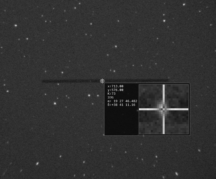

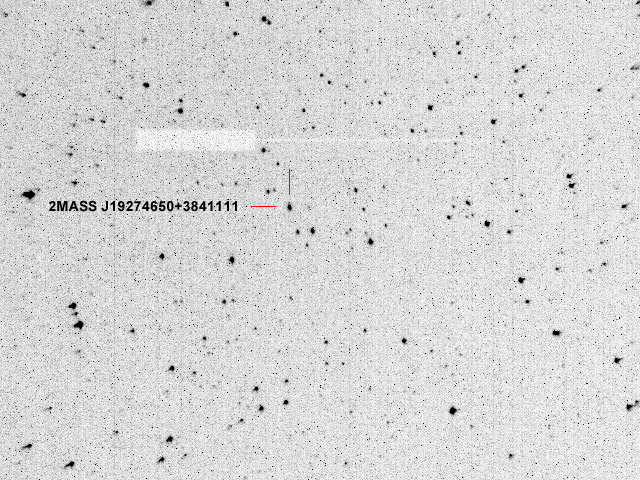

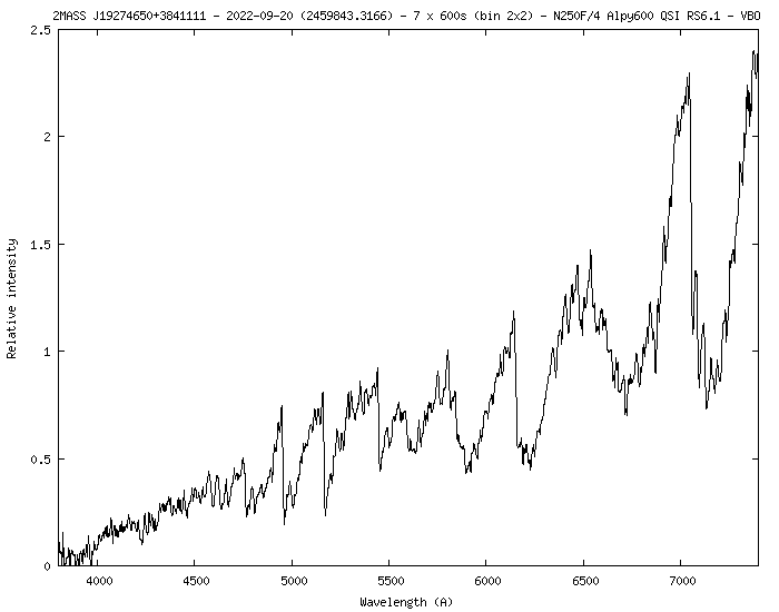

Posted: Thu Sep 22, 2022 9:59 pm
by Vincent Bouttard

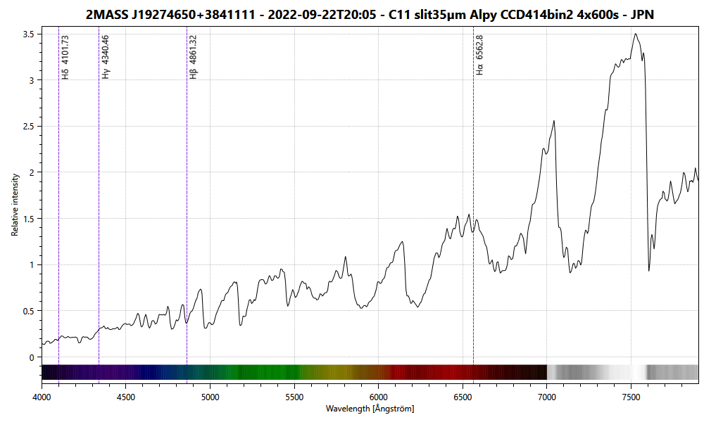

A spectra of 2MASS J19274650+3841111 with my autoguider FOV.
Vincent
Posted: Sat Sep 24, 2022 8:45 am
by JP Nougayrede
Bonjour everybody,
Another spectrum (low rez R300) of 2MASS J19274650+3841111, which seems to confirm Vincent's observation
2MASS J19274650+3841111_20220924T082205.png (63.55 KiB) Viewed 27322 times
Bon ciel,
Jean-Philippe
