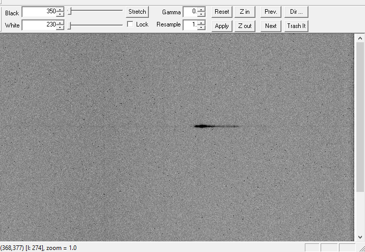

Francois Teyssier wrote: Do tou think that it would be possible to get the OI 8448 line?
It is clear here tonight but with a bright moon nearby so I am trying this (LHIRES 1200) This is a stack of 6x600s raw exposures.
The line is clear (very intense at blue edge) but the continuum is almost invisible.

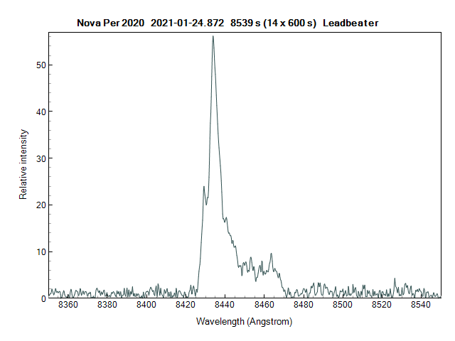

Hi all, congratulations for your spectra. My attempt tonight to capture the oxygen line in the NIR, as suggested by François.
Very noisy profile...
Posted: Tue Jan 26, 2021 11:49 pm
Nice ! I think you beat me on SNR. Good agreement so we know what is real and what is noise :-)

Hi Robin, the SNR seem to me similar but my exposure time was much longer. Maybe there was a balance between integration time and telescope aperture.
