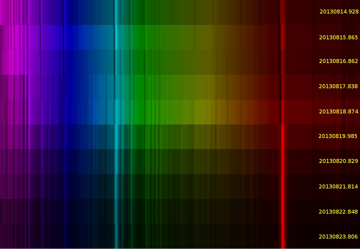

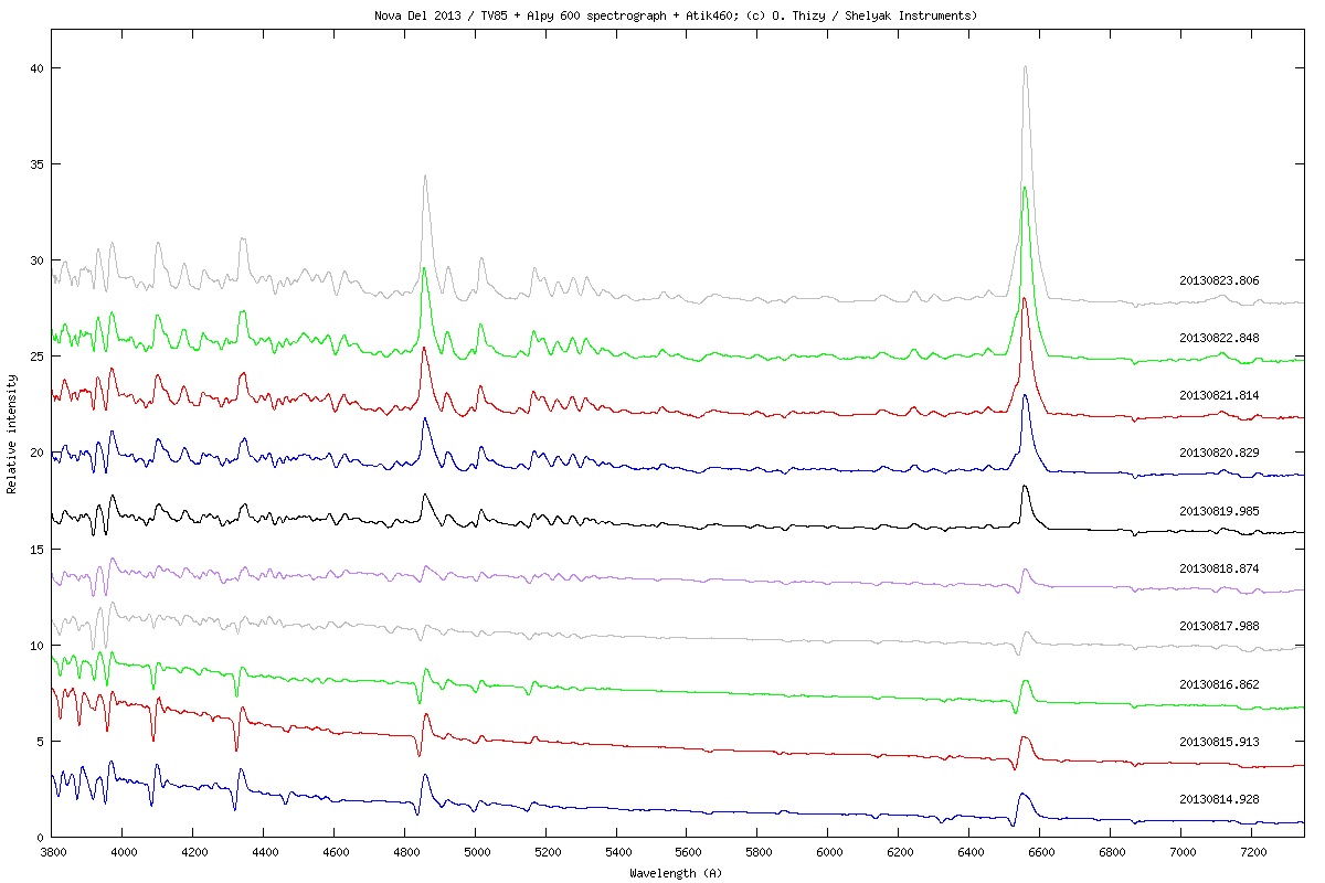

well... I must have some weather's god attention or some luck at the moment... here is my 10th night in-a-row on the nova!!!
Here is the update of the graph with 10 spectra (one per night):
I also updated my colored graph with the 10 spectra, it shows very nicely the evolution:
Equipment is:
-Televue 85mm refractor
-Alpy 600 spectrograph
-Atik 460ex camera for acquisition
http://www.shelyak.com/en/
