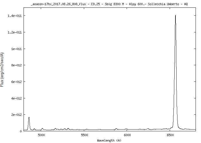

Posted: Tue Aug 29, 2017 10:23 am
by umberto sollecchia
Bonjour, placez le profil spectral de la journée 26-08-2017, calibré en Flux absolu.
Profolo nova flux.png (6.42 KiB) Viewed 10164 times

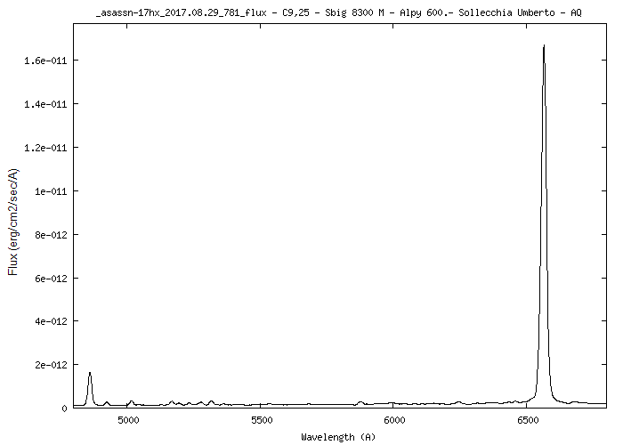

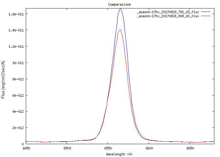

Posted: Thu Aug 31, 2017 2:47 pm
Bonsoir du tout, le profil de l'observation sur la nuit du 29-08-2017.Je joint également une comparaison entre le 26-08-2017 et le 29-08-2017 où il y a une légère hausse du H-alpha le jour 29-08-2017.

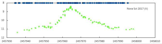

Posted: Sat Sep 02, 2017 2:59 pm
Excellent survey of a very interesting and peculiar nova
The light curve (AAVSO V) and ARAS Spectra
Now a plateau at mag V ~ 11

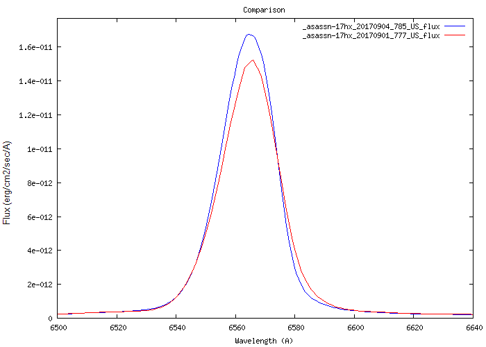

Bonne journée pour tous, le profil spectral du jour 01-09-2017.Umberto
Posted: Tue Sep 05, 2017 1:23 pm
Bonjour, le profil de la nuit dernière et une comparaison dans la région H-alpha avec le jour 01-09-2017. L'hydrogène monte encore. Umberto

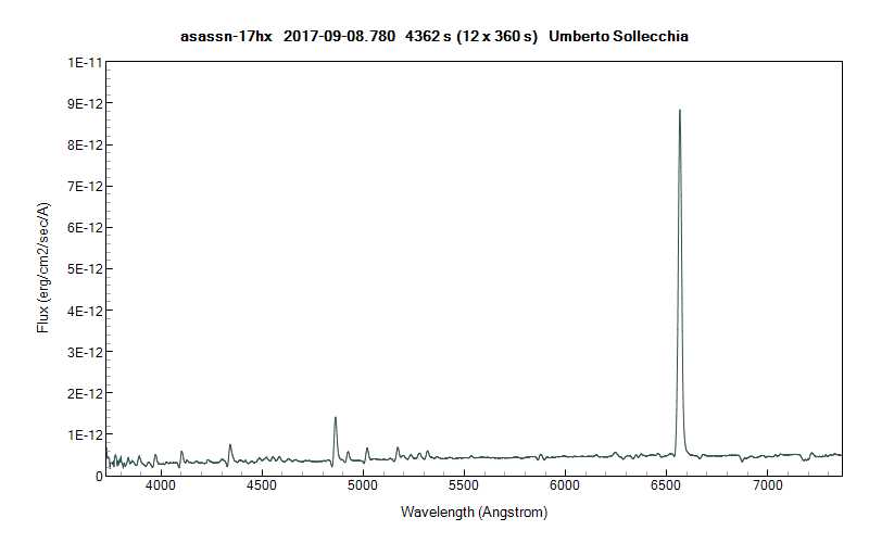

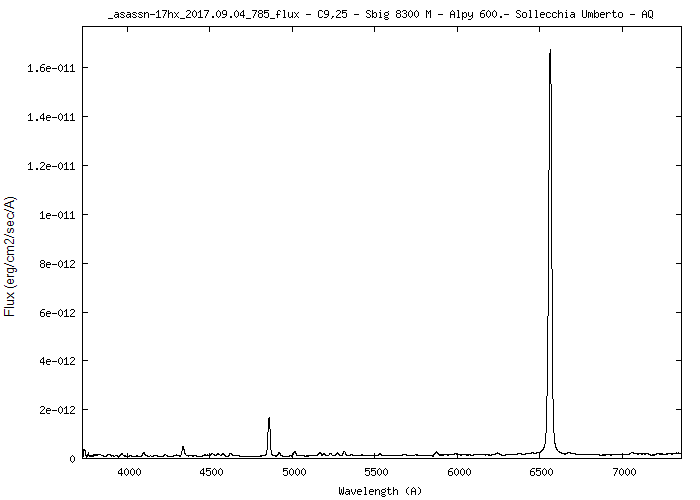

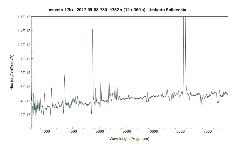

Posted: Fri Sep 08, 2017 10:07 pm
by Paolo Berardi
Hi all, the nova is undergoing a strong rebrightening. During my last observation, Sep 4, was shining at V mag 10.86 while this evening (Sep 8, ~ 19UT) V mag is 9.76.
The actual H-beta region spectrum exhibits lines (hydrogen and iron - helium?) with a complex P-Cyg profile.
On a low-res spectrum used for flux calibration (by Umberto, same night), I can see P-Cyg profiles on all the Balmer, helium and metals emission lines.
Heliocentric radial velocity of H-beta line (two main velocities, ~-500 and -1000 Km/s):
The comparison with Sep 4 spectrum:
Posted: Fri Sep 08, 2017 10:13 pm
Bonsoir, voici le profil de faible résolution pris en même temps que celui de Paolo Berardi.Umberto
asassn-17hx_20170908_780_Umberto Sollecchia flux.jpg (22.21 KiB) Viewed 10057 times

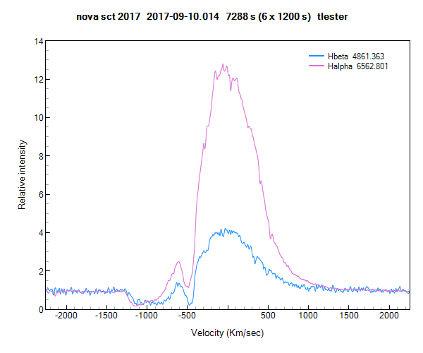

Posted: Sun Sep 10, 2017 7:57 pm
by Tim Lester
Here is nova sct on the 10th captured with my echelle spectrograph at R = 12000. It is still brightening (V mag = 9.5 on AAVSO) but it is low in the sky and difficult to get good S/N at the blue end..
