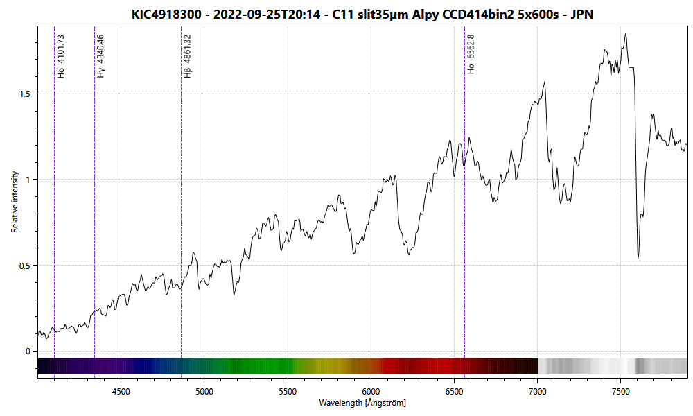

Hello tout le monde,
A spectrum of the symbiotic candidate KIC 4918300 that seems to confirm Vincent' observation (his post on 11 sept of this thread)
Bon ciel,
Jean-Philippe

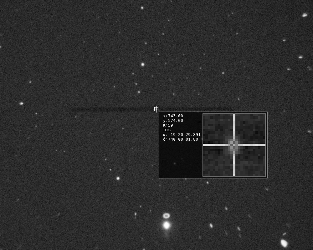

by 2SPOT
Another symbiotic candidate taken this morning with our setup in Chile
An easy target of magnitude V=12.4 taken with an Alpy 600
