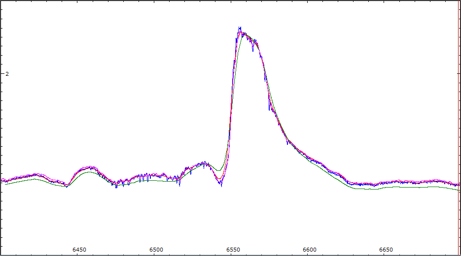

Posted: Mon Aug 26, 2013 6:17 pm
Comparaison de différentes résolutions
H alpha
Le 19 08 2013
- Thierry Lemoult R = 11000 Bleu
- Paolo Berardi R = 2500 Violet
- François Teyssier R = 1000 Rouge
- Olivier Thizy R = 600 (décalé de + 2 A) Vert
Posted: Mon Aug 26, 2013 6:37 pm

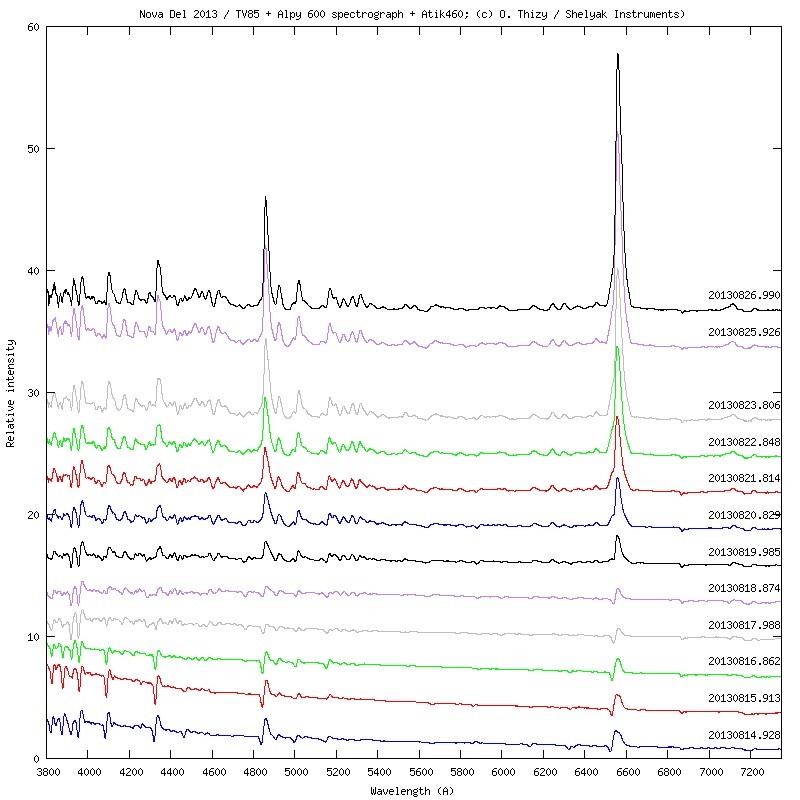

Evolution of the nova - Halpha continues to rise...
http://www.shelyak.com/en/

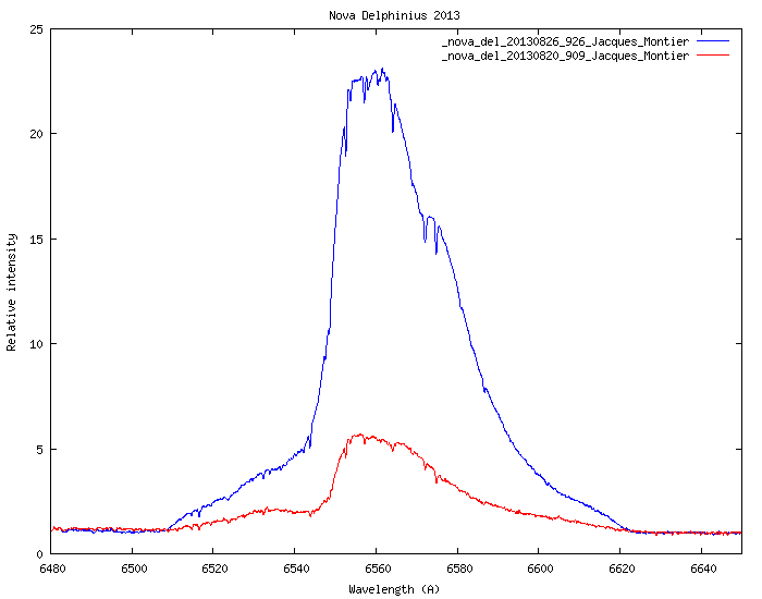

Posted: Tue Aug 27, 2013 10:36 am
by Jacques Montier
Hello everybody,
Halpha spectrum of the last night with Lhires III 2400 t/mm and comparison with the 20130820 H alpha.
H alpha rising is very spectacular !
Jacques Montier
