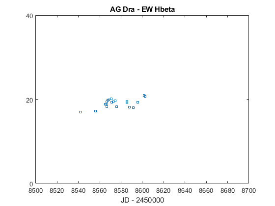

Posted: Mon Apr 29, 2019 10:45 am
An update.
AG Dra is still in quiescent state (photometry and spectroscopy)

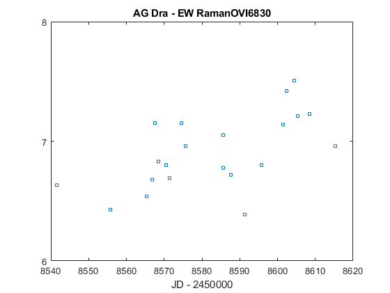

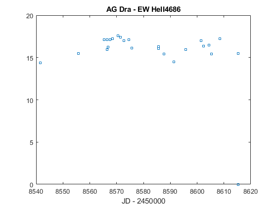

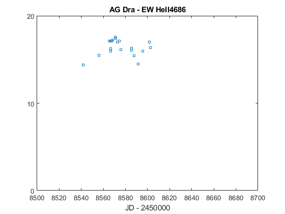

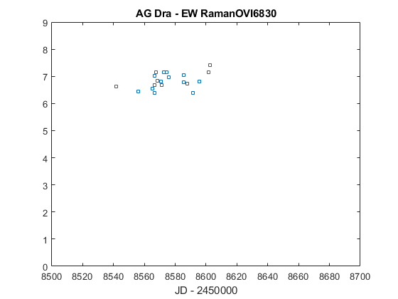

Last results from spectra (Echelle) gathered in ARAS base:
Interesting: the light curve is steady at Mag V ~ 9.7. The EW of the main lines is increasing slowly.
Good coverage, Excellent results, thanks to all.
We are undergoing the observations at a low cadency (low and higher resolution).
Even if, this year, the target doesn't produce an outburst event, the data will be very important to produce a baseline (Joroslav's communication).

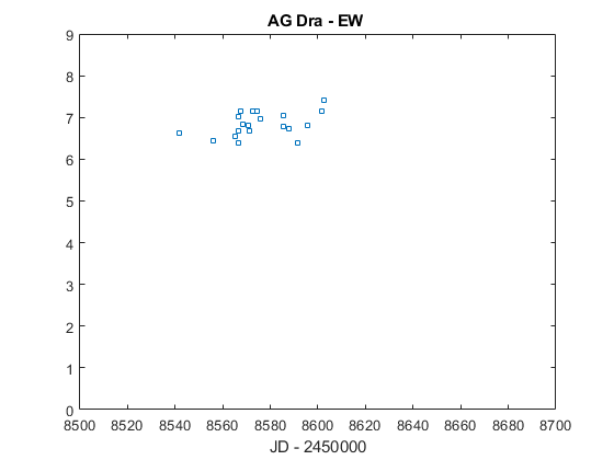

Posted: Tue Apr 30, 2019 10:11 am
Joroslav's comments:
The behavior of AG Dra is quite interesting. The brightness doesn't seem to change significantly. Absorption in the blue wing of H alpha is still quite prominent. However, EWs are slowly increasing (not only for low excitation lines, for which the changes with the orbital period are expected). As I said previously, we will see how the evolution will continue. Everything is possible, this is a very unusual activity stage.

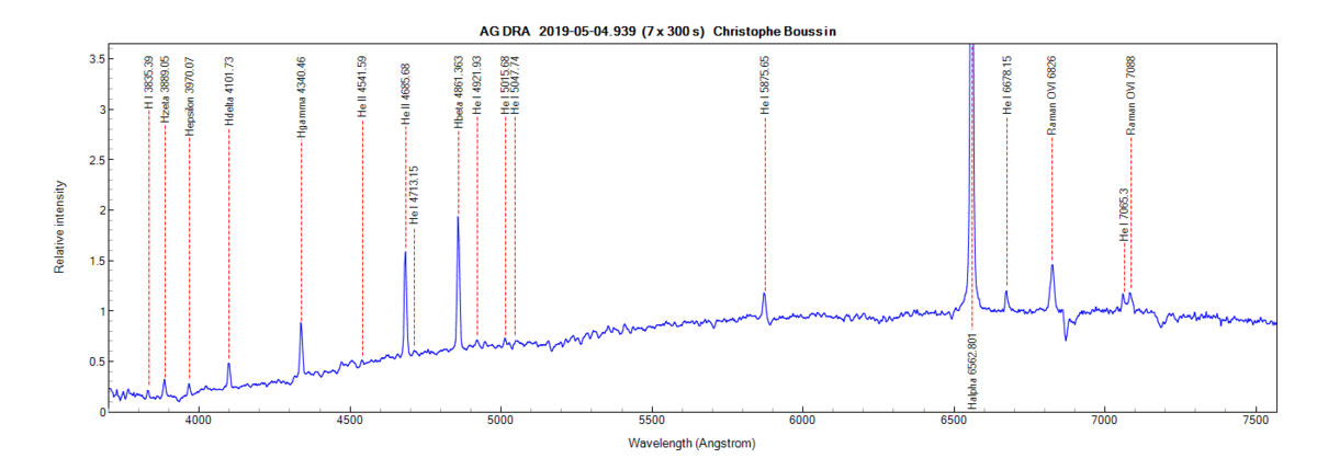

Posted: Wed May 08, 2019 5:13 pm
by Christophe Boussin

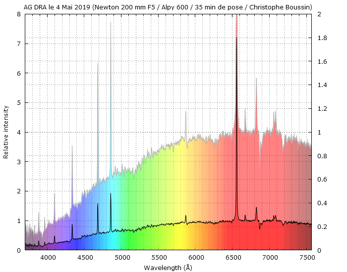

Here is my last contribution to the AG Dra monitoring.
I obtained the following spectrum the 4th of May at 22 h 31 TU with my Alpy 600 (resolution of 506, JJ = 2458608.4388) and an acquisition time of 35 min :
AG Dra on May 4th, 2019
_agdra_20190504_939_Christophe Boussin_3700_7570.png (76.96 KiB) Viewed 9211 times
AG Dra on May 4th 2019 (identification from PlotSpectra)
Clear skies,

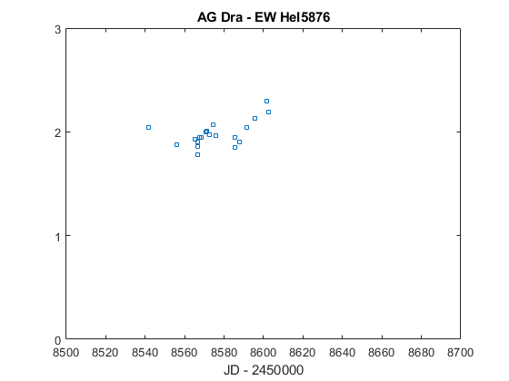

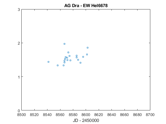

Posted: Sun May 12, 2019 4:30 pm

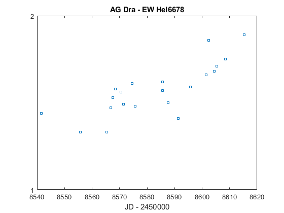

Still quiescent
Only the singlet He I 6678 is sllghtly increasing:
Ongoing observations until late May, the outburst remains possible.
