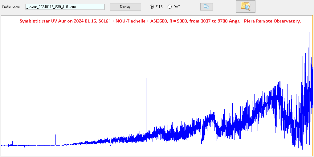

Posted: Tue Jan 16, 2024 5:40 pm
by Joan Guarro Flo
Hello at all,
It's a pleasure to come back to show here new results of my observations again, after this long break time.
I started today to show this graphic by the Piera Remote Observatory, which is in the training phase.
Furthermore, there is starting to mend the Piera second dome this year, this belongs to the first phase of the project with the intention to equipate it with a 40cm. telescope and another echelle NOU_T. We will see...
Cheers; Joan.
_UVAUR 20240115.png (28.61 KiB) Viewed 22319 times
