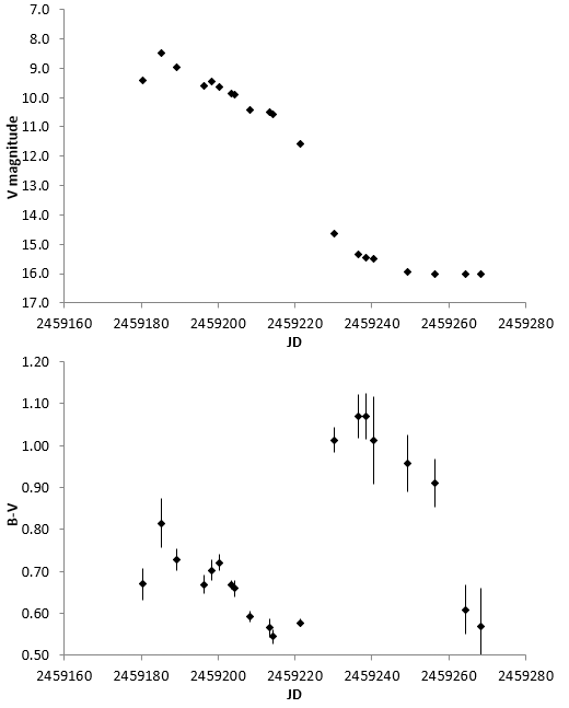

From my B and V photometry of the nova, it appears that it has now recovered from the reddening episode which began as the nova faded around JD 2459225. Were the fading and reddening the result of dust emission?

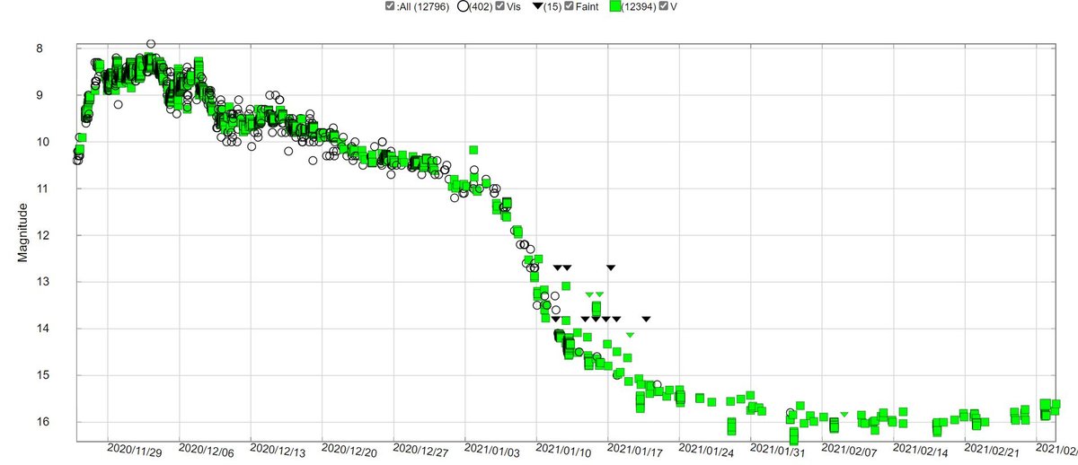

As David noted, the magnitude of the Nova, still close to 16, now appears to be very slowly decreasing...
Light curve of the Nova PER 2020 (AAVSO)

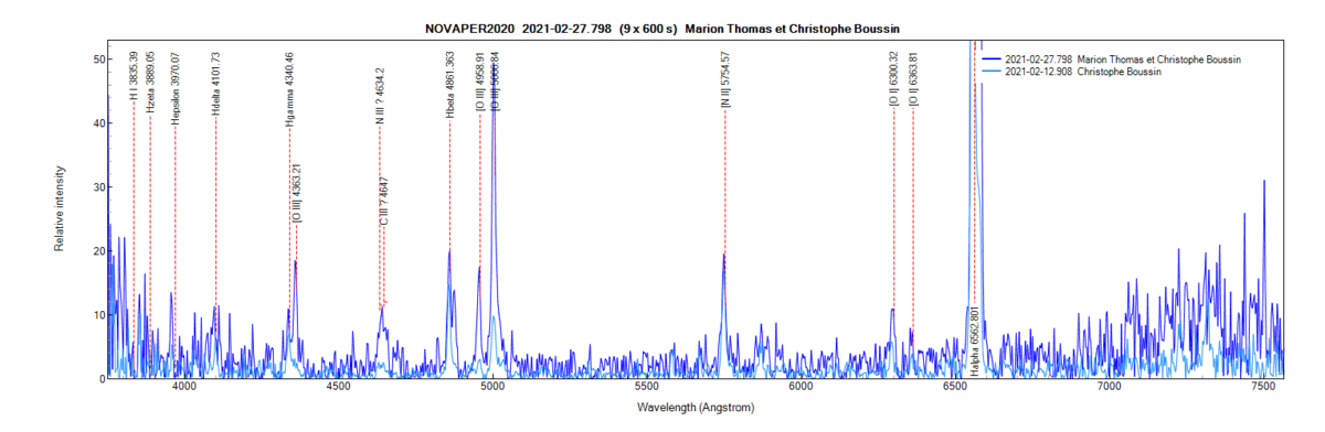

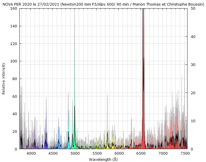

The following spectrum of the Nova Per 2020 was obtained the 27th of February at 19 h 08 TU with an Alpy 600 (resolution of 506, JJ = 2459273.2976) and an acquisition time of 90 min (9 x 600s) :
Nova Per 2020 on February 27th, 2021
_novaper2020_20210227_798_Marion Thomas et Christophe Boussin_3750_7565.png (83.69 KiB) Viewed 13901 times
Due to the presence of the full moon, the acquisition conditions were much less favorable than on February 12th !!
Nevertheless, we can notice several notable changes in the spectrum ...

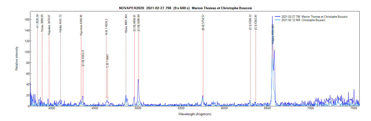

Nova Per 2020 on February 12th and 27th, 2021 (identification of some lines from PlotSpectra)
Nova Per 2020 on February 12th and 27th, 2021 (zoom)
The double peak shape of the Halpha line is very obvious and seems to be visible in the Hbeta line as well. It's more difficult to say with the Hgamma line since it must be blended with the [OIII] line at 4363A...
The [OIII] lines at 4959 and 5007A are now clearly visible and the relative intensities of these lines have increased notably since February 12 !
Could it be that the NIII and CIII lines become visible ?
