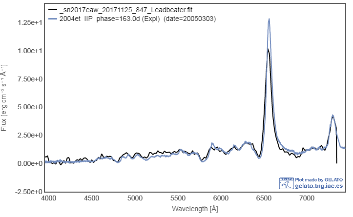

Re: Probable SN in NGC 6946
Posted: Sun Nov 26, 2017 9:26 pm
SN2017eaw is now V mag 16.3 according to this light curve
https://sites.google.com/view/sn2017eaw.
Here is an R~130 spectrum from last night using the ALPY200, (black) overlaid on a spectrum from GELATO of another IIP supernova at approximately the same age, SN2004et, which was interestingly in the same galaxy and was one of the first supernovae I ever measured, using a 100 l/mm grating (before the Star Analyser)
Posted: Wed Nov 29, 2017 1:16 pm
by etienne bertrand
Bravo Robin !
Déjà qu'en Octobre elle n'était pas brillante, là c'est un exploit que de la faire !
