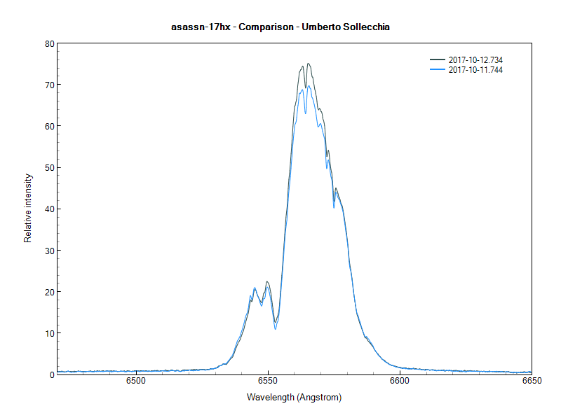

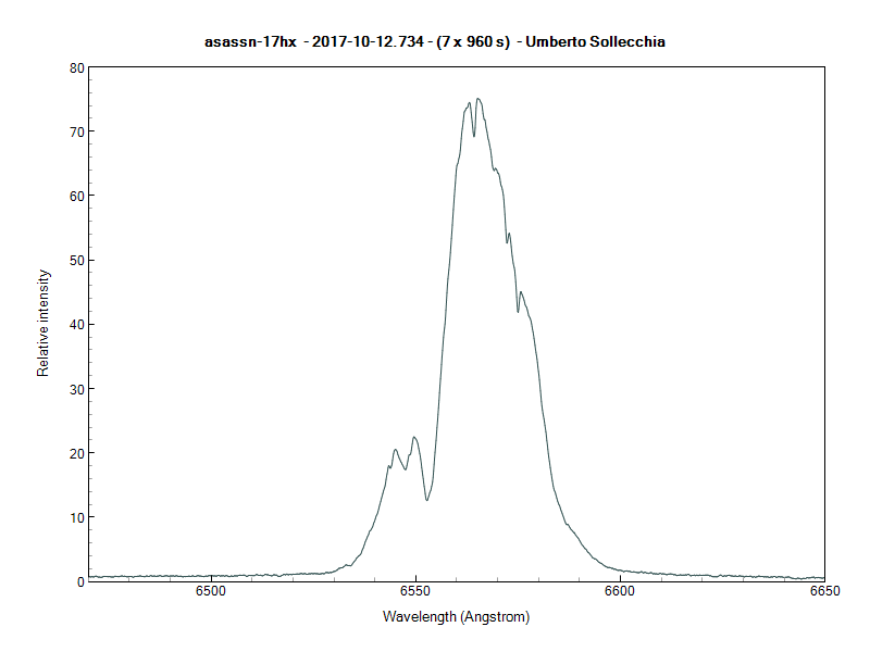

Posted: Fri Oct 13, 2017 1:59 pm
by umberto sollecchia
Bonne journée à tous, placez le profil de la nouvelle observé le 12-10-2017 une comparaison avec ce qui précède.Umberto
asassn-17hx_20171012_734_Umberto Sollecchia.png (22 KiB) Viewed 18674 times
asassn-17hx - Comparison - Umberto Sollecchia.png (29.37 KiB) Viewed 18674 times

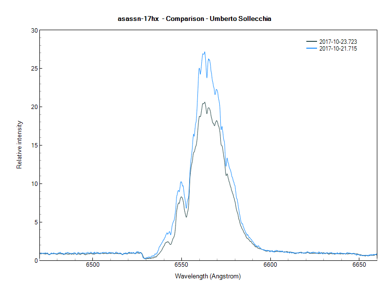

Posted: Sat Oct 21, 2017 9:39 pm

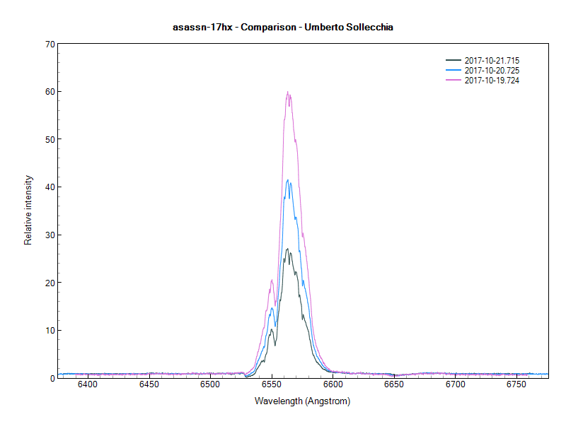

Bonsoir du tout, voici une comparaison des profils des trois derniers jours.
umberto
asassn - Comparison - Umberto Sollecchia.png (33.52 KiB) Viewed 18627 times

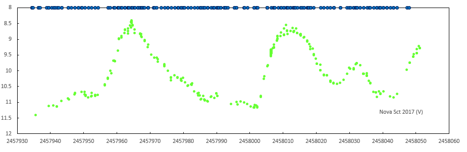

Posted: Mon Oct 23, 2017 3:26 pm
by Joan Guarro Flo
As it can also be seen with the graph of Umberto. It is very possible that there is a reverse relationship, between, the increase in brightness of the Nova and the decrease in the intensity of the Halpha.
Joan.

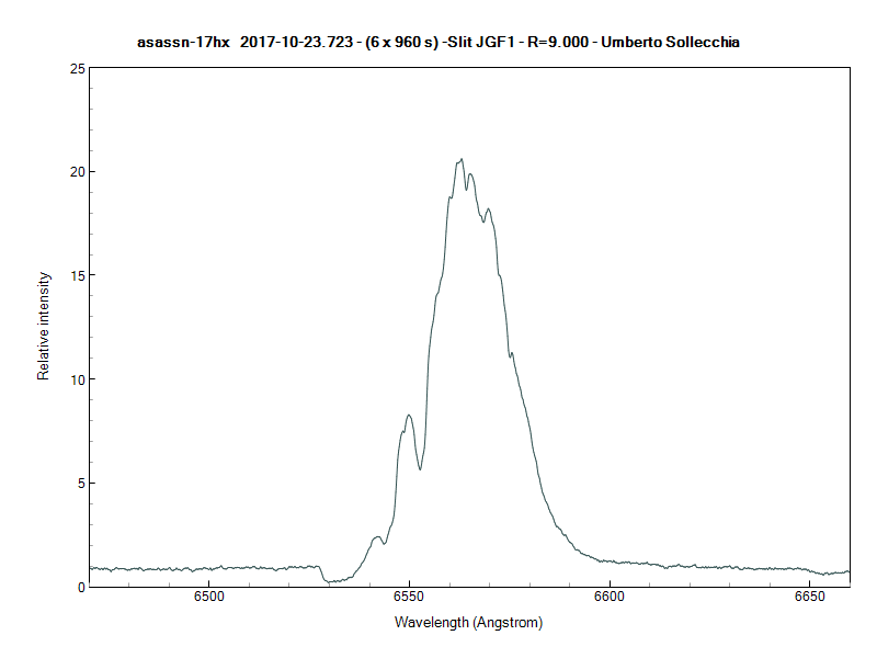

Posted: Tue Oct 24, 2017 6:16 pm
Salut, juste Joan, même la nuit dernière 23-10-2017, avec de nombreux problèmes météorologiques, j'ai réussi à faire un spectre à la nova.Voici son profil spectral et une comparaison avec 21-10-2017.
Salutations -
asassn-17hx_20171023_723_Umberto Sollecchia.png (21.15 KiB) Viewed 18572 times
asassn-17hx - Comparison - Umberto Sollecchia.png (29.8 KiB) Viewed 18572 times

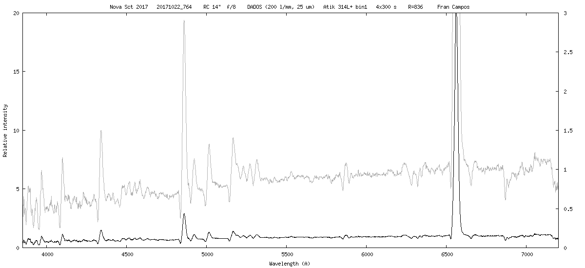

Posted: Tue Oct 24, 2017 8:51 pm
by Francisco Campos
Joan Guarro Flo wrote:Hi,
Joan.
Yes, Joan, the nova is again rebrightening. Outstanding!
Here is a spectrum from two nights before- the nova is getting more and more difficult to observe. Again P-Cyg profiles but now the bands are broad.
Salut!
Fran
Posted: Wed Oct 25, 2017 5:50 pm
Update of the lightcurve and spectroscopic coverage
Impressive!
A few more spectra of this new brighning are welcome. Yes, the nopva is lower and lower.
