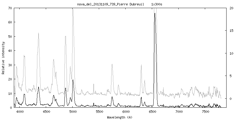

Bonsoir
Juste le temps de faire une pose de 300s pendant la venue des nuages.
Demain pluie sur la Cote d'Azur !
nova_del_20131109_739_Pierre Dubreuil.png (7.34 KiB) Viewed 9592 times
Bon weekend à tous et bon wetal

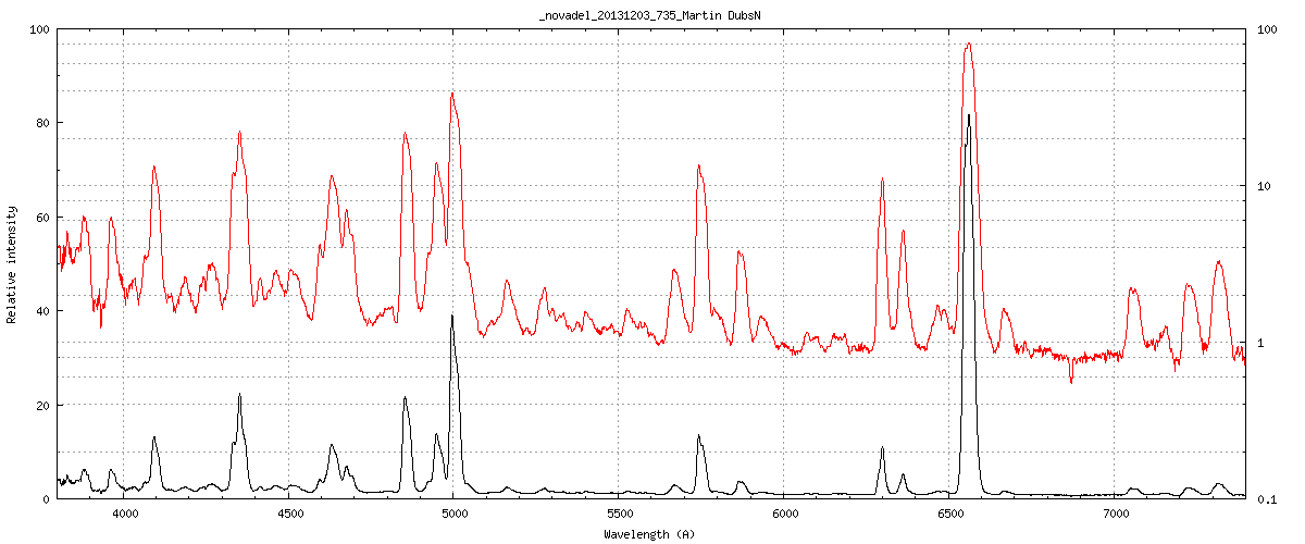

Posted: Wed Dec 04, 2013 9:04 pm
by Martin Dubs
Hello Jacques,
too bad you cannot try it. I was luckier, got a spectrum of the Nova last night with the telescope at the observatory of our astronomy club at Falera, a 90 cm Cassegrain and a LISA (see: http://www.mirasteilas.ch/index.php/ste ... instrument). Here the result after 4800 sec:
black curve: linear scale left, red: log scale right hand axis
_novadel_20131203_735_Martin Dubs.png (13.31 KiB) Viewed 9461 times
Unfortunately it was quite hazy, so the instrument response might not be as good as it could be. Also the seeing was not very good, so a lot of light did not go through the slit at 6 m focal length with a reducer.
Clear skies,
Martin
