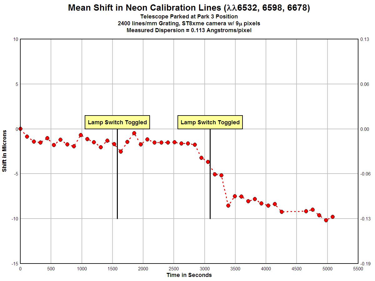

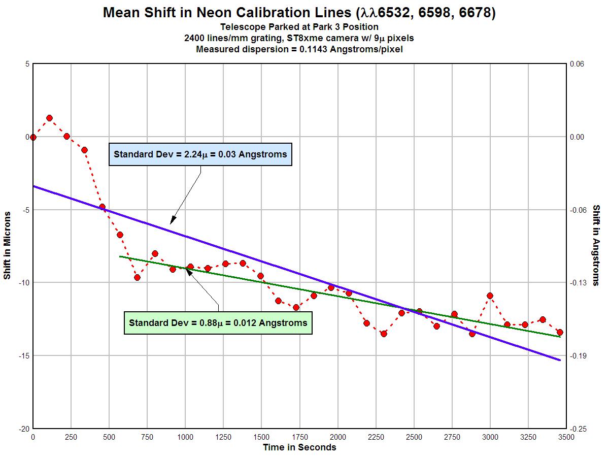

So I had a chance today to re-run one of the test I'd done with the LHiRes III - this time with the new upgrades. The test is very simple - just turn on the lamp and take a calibration lamp exposure every couple of minutes. The telescope is parked and not moving - and has been in that position for at least a day. I've included a plot done with the new apparatus (the plot with yellow labels) as well as the one done a month or so ago (blue and green labels). Basically the results are substantially the same. Note that in both cases there was a fairly stable region where the mean line positions migrated in a fairly linear fashion - but also there was a "jump" (of about the same magnitude) in the curve in each case. In both cases the images were acquired while the outside temperatures were falling. I don't have a way to measure temperatures in the dome but the temperature differences from start to end should be about the same in each case. My working theory is that the slow movement is due to the micrometer shaft shrinking as the temperature drops, and that there is some "stiction" - as the micrometer slowly pulls away due to shrinkage and there isn't enough spring tension to keep the point on the grating carousel tightly against the micrometer until it gets far enough away - then it moves relatively quickly. These tests were both done with the 2400 line/mm grating, and at 6600 Angstroms (the approximate central wavelength for the images) the micrometer is turned almost completely "out" - there is only a very little spring tension in that range. So I'm thinking I may put a stronger spring in there - or some other way to assure solid contact between grating housing and micrometer.
One thing to note in the more recent test - because the lamp would only stay lit for 30 minutes at a time I had to toggle the NeAr on/off switch twice during the test. Those points are marked. There seems to be little or no effect, which is also what I had determined with the old setup. Now to do the more "real world" test of measuring wavelength stability on a real target. For that I'll need clear skies! And it would also be nice if it was not below zero F at the same time.
