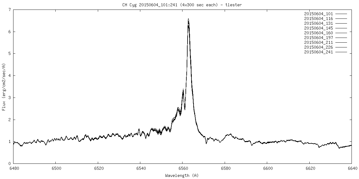

After posting my animation for the night of June 4th I was worried that possibly the variations were just noise.
To check this I grouped them into 9 4x300 sec spectra to reduce noise and plotted an overlay. Same normalization as before (6600A - 6620A).
It still looks like the complex Ha line may be varying a small amount all the time on a relatively short time scale.

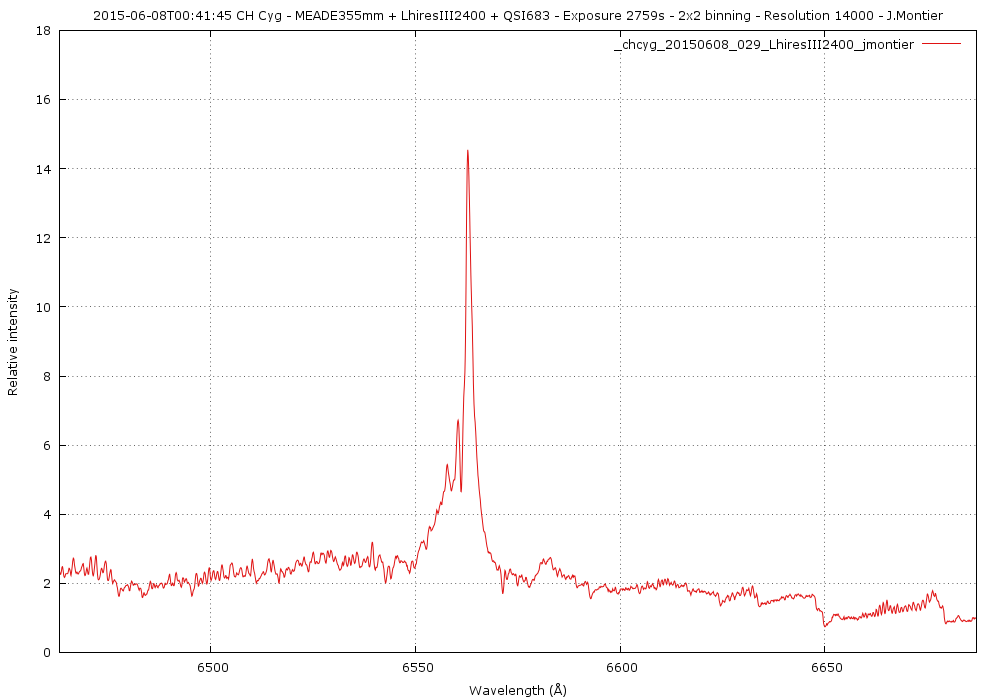

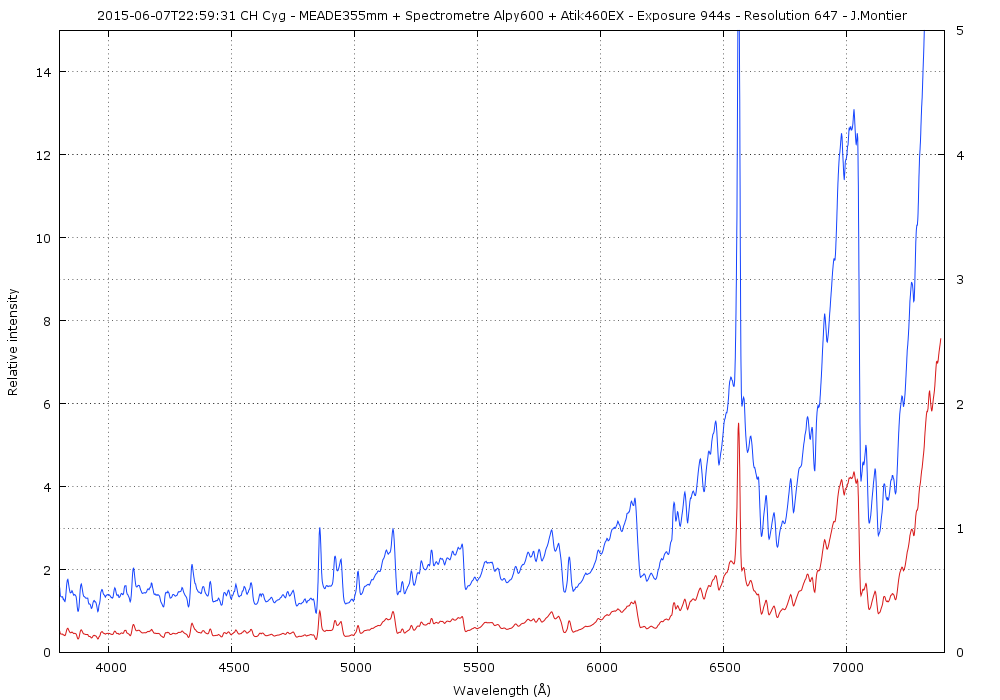

Low resolution spectrum of CH Cyg with Alpy 600
Hight resolution spectrum (Halpha line) with LhiresIII 2400 t/mm
Best regards,

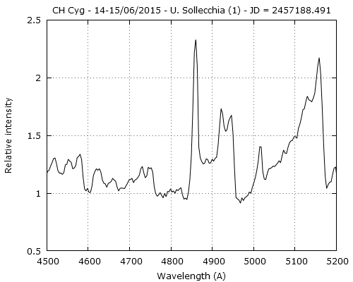

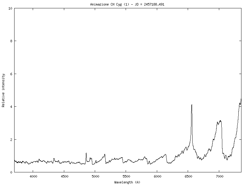

Bonsoir à tous,voici mon animation où il y avait un effet significatif P-cyg sur le H-bêta de heures 2,35 à 2,43 TU.
Range H-beta
Cordialement Umberto

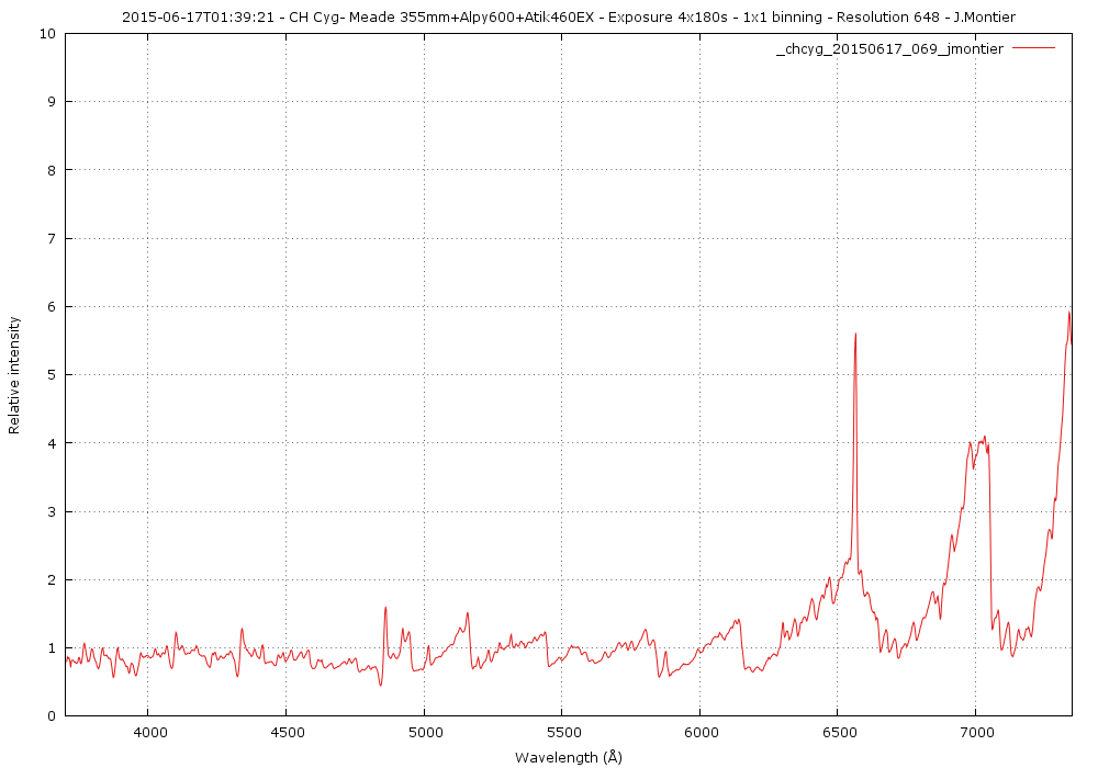

CH Cyg profile with Alpy600 on 2015/06/17

by umberto sollecchia

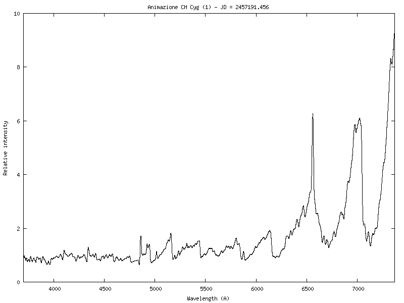

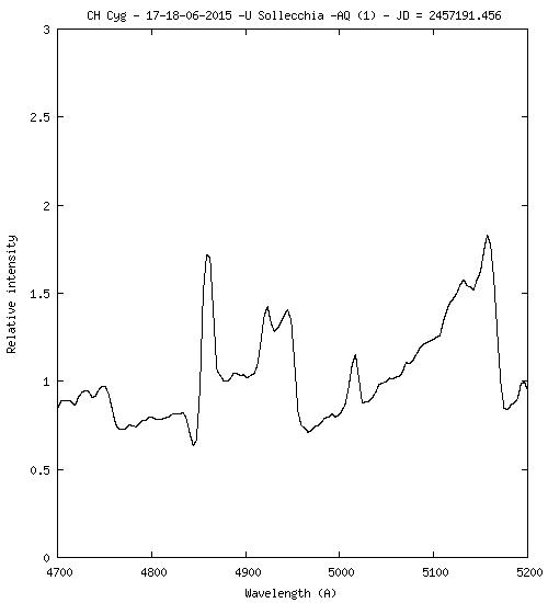

Salut, je l'ai enregistré un nouvel effet de P-Cyg sur le H-bêta avec une observation dans la nuit du 17 et 18/06/2015 à partir de 22:55 heures à 00:07 heures TU, voici le film.
@CH Cyg H-beta.gif (317.67 KiB) Viewed 14243 times
