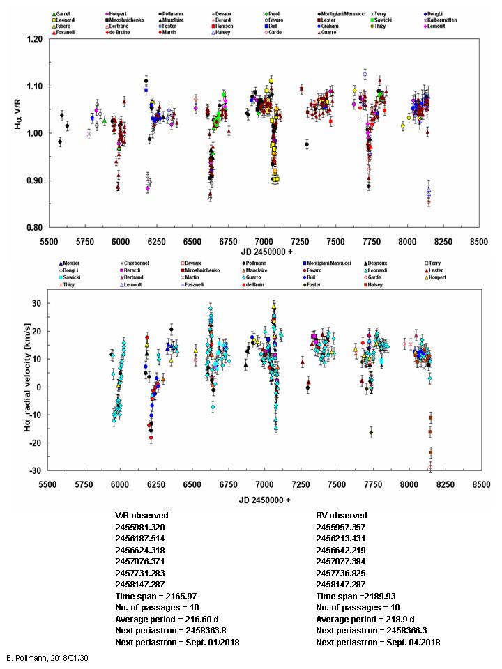

Dear colleagues,
it seems that the next periastron passage of 28 Tau is coming somewhat earlier than the ephemerides says.
Normaly we should to expect it around February 18th (this year), but current spectra of Alun Halsey and Joan Guarro are showing a quick change of radial velocity as indicator for that event (see attachment).
It would be great, if further observers could dedicate to this event too.

Congratulation Alun Halsey & Olivier Garde !
Obviously you was able to catch the last "very sharp" periastron passage of 28 Tau with the V/R ratio and radial velocity in your spectra.
A really great result which enables to calculate the next periastron passage now with new precisely time reference.
Re: 28 Tau ARAS monitoring
Posted: Tue Jan 30, 2018 7:46 pm
by Ernst Pollmann
Dear colleagues,
during an observation period of about 6 years, we always observed in the community a synchronous variation of the V/R ratio with the radial velocity RV. Within this period, 10 periastron passages have occurred with an orbital period of 218 days (Nemravova et al., A & A, 2010), of which we can document 6 passages with our observations.
The observed V/R variation correspond to a deformation of the central absorption core as it also to see in Fig. 6 of Nemravova et al. 2010. This systematic V/R variation during each minimum of radial velocity might confirm new aspects of the structure of the growing disk. Is striking that the V/R period is somewhat smaller (approx. 2 days).
The next periastron passage will take place at the beginning of September this year and should be observable.
