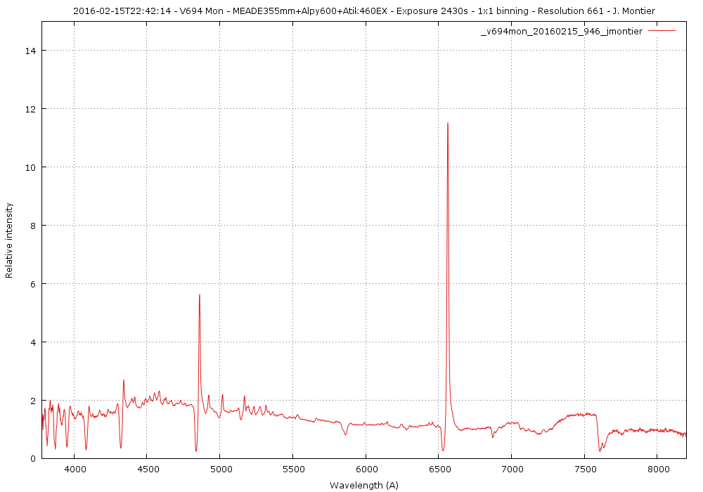

Posted: Tue Feb 16, 2016 5:14 pm
by Jacques Montier
The spectrum of the last night.

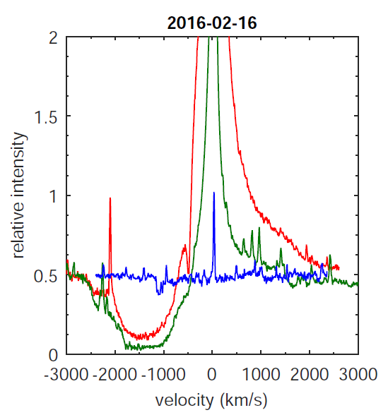

Posted: Wed Feb 17, 2016 5:25 am
Finally, a clear night
Ha = red
Hb = green
[OI] 6300 = blue
V max ~ 2700 km/s
Number lines of metals

Hi François, the H-alpha absorption shape now seems more "rounded" and red side of H-beta one has not continued to rise. From AAVSO observations I saw that the brightness in V band is decreased (until about mag 9.6).
The spectrum with eShel is great!
I had several nights with rain and clouds...

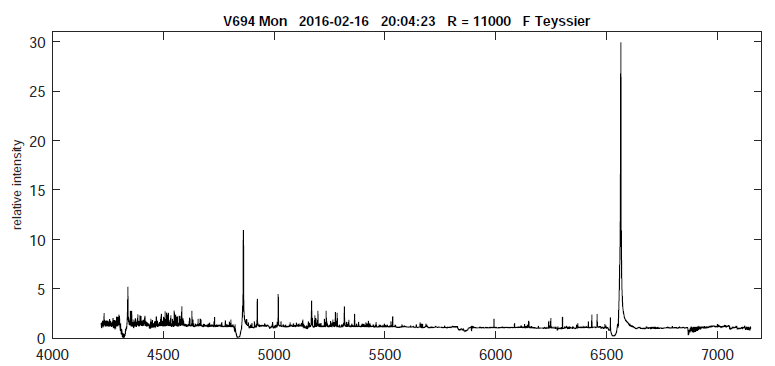

by Tim Lester
Here is my result for 2016/02/19. 6000 to 7100 ang, R = 9000. (Ambient temp. -19C!)
I used the Cflib spectra for the star HD59984 to calibrate response. It is a mag. 5.9 F5V star that is 2 degrees away from V694 Mon.
The average altitudes differed by less than 1 deg during acquisition.

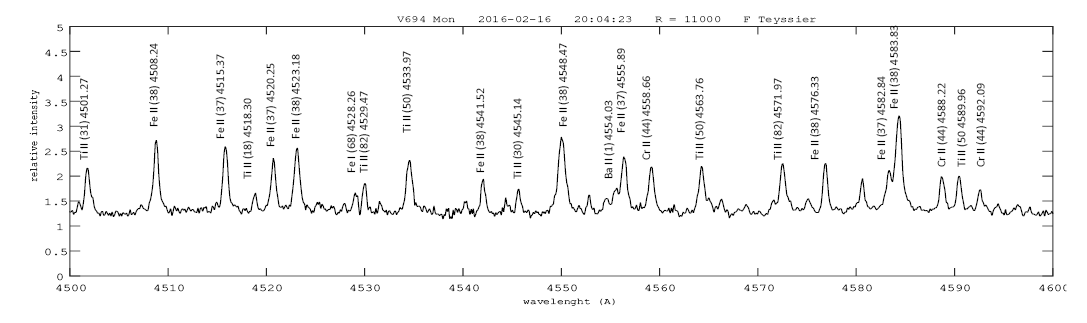

Nice Tim !
The star looks quiet in term of velocity of the jet despite the visual outburst.
So let's go on.
Here's an identification of the metal lines for 4500-4600 range.
Fe I, Fe II, Ti II, Cr II, Ba II
All are narrow, about 30 km/s
Emitted by the disk according to the models, while the absorptions are formed in the jet

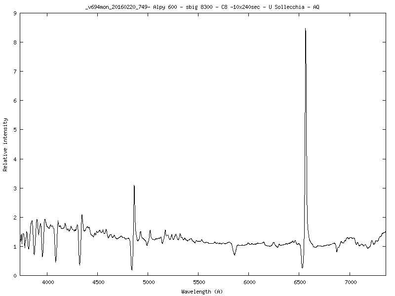

by umberto sollecchia
Salut, Voici un nouveau profil d'observation 20.02.2016.
