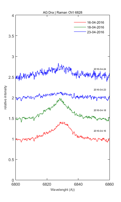

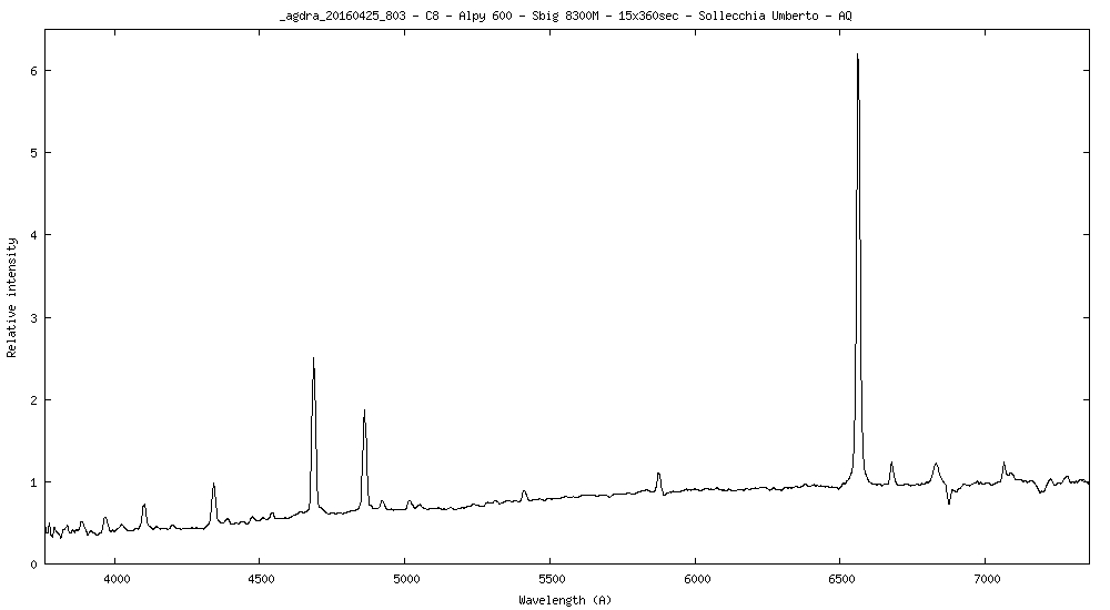

Salut, voici un nouveau profil de l'étoile observée 25-04-2016 et une comparaison entre le jour 19/04/2016 et 25/04/2016.Umberto
Profilo Ag Dra.jpg (66.74 KiB) Viewed 11599 times
Re: AG Dra brightening
Posted: Tue Apr 26, 2016 7:54 pm
That's great, Umberto,
We can say when OVI vanished and when it reappers.

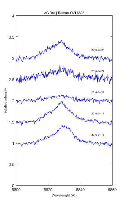

Tonight spectrum
Clear night after several failures this week
_agdra_20160427_852_full_Raman OVI 6828_1.png (29.23 KiB) Viewed 11556 times

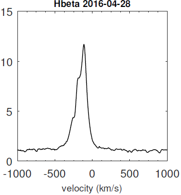

There's now (since 2016-04-17) a double absorption in the blue side of Balmer lines
Perhap's a shock in the red giant wind

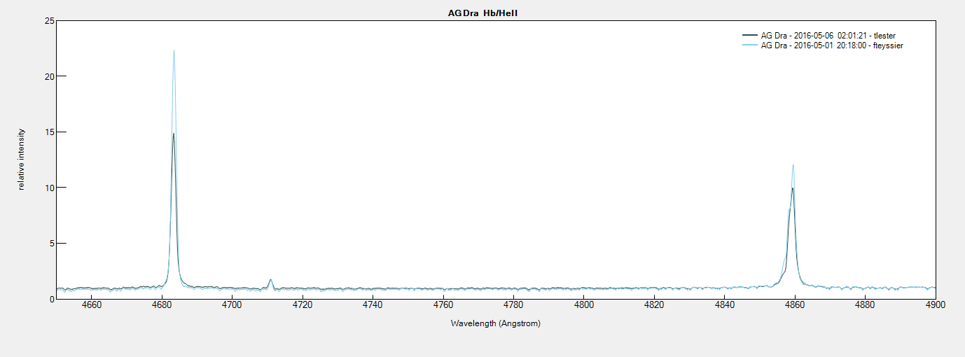

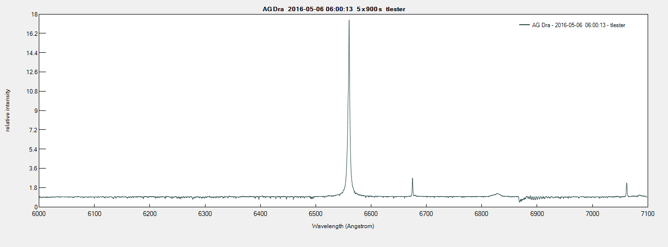

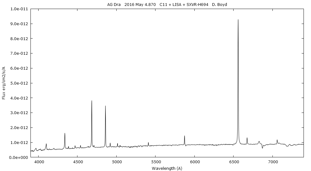

Here is AG Dra for May 6th at Hb and Ha.
Hb/HeII compared to fteyssier's result on May 1st. Shows the fairly rapid drop in ratio and line intensities.
Posted: Fri May 13, 2016 2:41 pm
Interesting, Tim !
You took it just during a second peak
Unfortunatly, we have poor coverage of this second event.

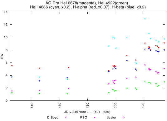

Posted: Sat May 28, 2016 3:15 pm
by Peter Somogyi

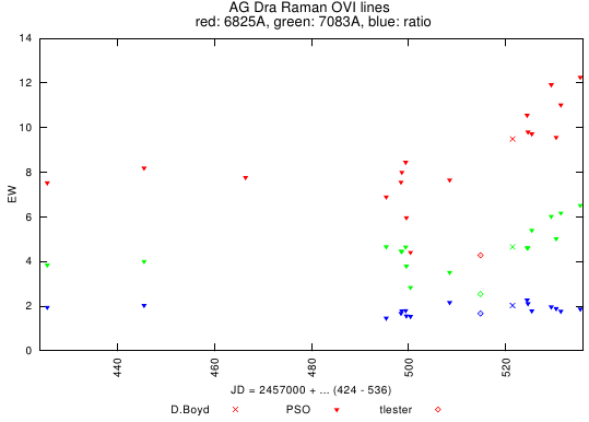

After last weekend's clear night (= 3 day incl. Friday) + taking exceptionally this Thursday, let me summarize where I am with the +4 spectra within a week I've gathered, borrowing Tim Lester's and David Boyd's spectrum just from the edges of the critical observation hole (JD=2457515 - 2457521) when something important must have happened:
Raman looks to be at peak compared to longterm with a raising trend, and last weekend it was still flickering. (Each had at least ~1.2 hour exposures so noise should be less than 0.05, based on my earlier per-exposure variations.)
The reason chosing this unusual time window is to see whether things are settled or not. At least Balmer and HeI lines have jumped (compared to continuum) only within a week.
Hope you can continue, rainy season here.
