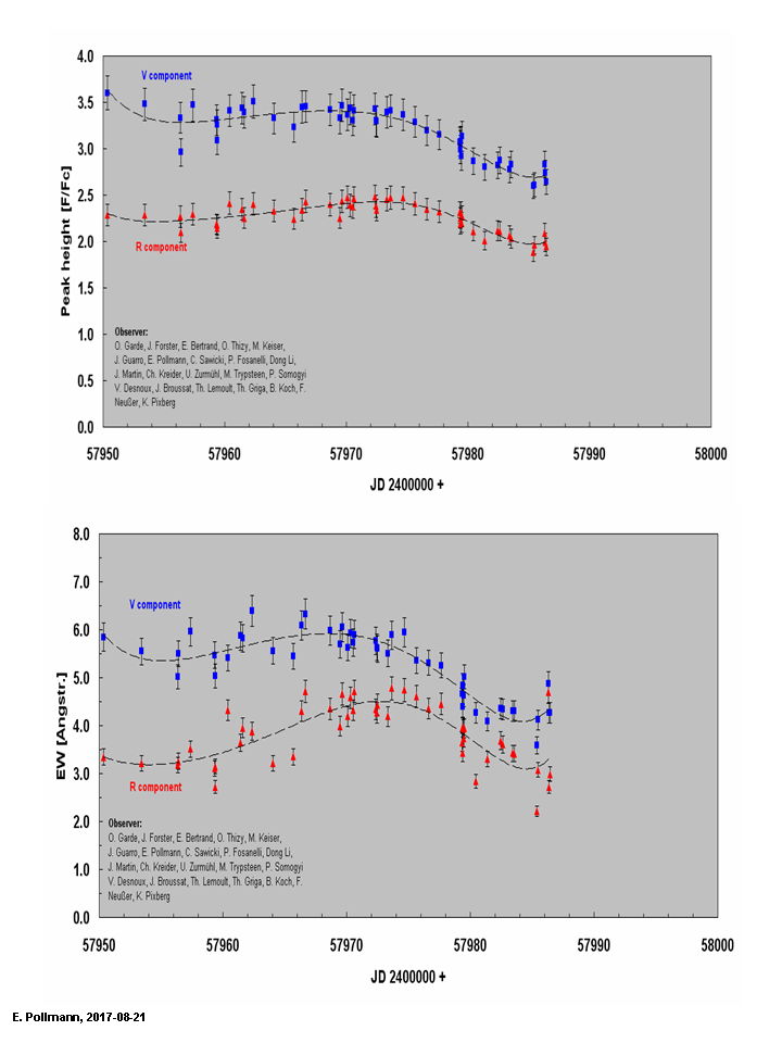

Hi Marc,
irregular pulsations seem to be typicaly for late-type super giants. In our IBVS paper (No. 6198) we described our found period of 145 days and could confirm the 150 day period (first proposed by Hayasaka 1971) which causes by irregular pulsation of the M star. Of course we could imagine some different "fitting" scenarios, but all of them would be speculation in the current situation.
Another open question could be, why also the R component during the present eclipse (it take place right now?) does show nearly the same intensity variation of the V component, and why it decreases at present, despite its formation diametrically to the other side of the accretion disk? It should remain stable and only show an intensity reduction with a time delay, when the other edge (side) of the disk is eclipsed.
Ernst

Dear colleagues,
the somewhat different form of the diagrams (logarithmic ordinate, longer time base) shows for V&R EW and PH from my point of view that we are already in eclipse at least since end of May this year (JD 2457900).
Comments are welcome!
Ernst

Re: Observation state of the campaign
Posted: Fri Aug 25, 2017 9:29 pm
by marcoastro+
Dear Ernst,
This analysis gives a remarkable turn in the project. This points towards your latest re-calculation of the beginning point of the eclipse, which I think was in the beginning of June. With this latest graphical presentation it seems to be even earlier. What is the standard deviation of the measurements in respect to the mean values of R and V (PH and EW) ? Perhaps also an R to V plot? Perhaps another refined calculation of the date?
Posted: Sat Aug 26, 2017 9:42 am
by Ernst Pollmann
Dear Marc,
from my point of view it seems to be not easy and not meaningful too, to define average values or standard deviations, since the variability of V&R seems to be (out of eclipse) stochastically.
That´s why our out of eclipse base line is not explicit a strict straight line. It is more or less a tendency line, smoothed on the variability. And our V&R values fit very well in that tendency. Because of that I think we can speak only of a qualitative assessment than of a statistical evaluation. So the question is at all, whether a statistical statement makes sense in this certain case.
Nevertheless, there are error ranges, at least in evaluation, that´s clear. The overall accuracy of the EW and PH determination of V&R depends on:
1) the quality of the spectra taken during the observed night
2) the reduction process (spectrum processing) of the individual observers
3) the determination in the normalized spectrum.
To 1):
I am not able to estimate this order of magnitude, but my own experience says, this is approx. in the order of magnitude (+/-) 3% in EW for one single observation.
To 2):
I am also not able to estimate the accuracy of the spectrum processing of the given observer. This will remain an unknown factor (at least for me).
To 3):
Here I can speak only about the reproducibility of normalization, and about the accuracy in definition of the integration wavelength area. This reproducibility lays in the order of magnitude (+/-) 5% in EW. This is the only thing I can do when drawing the monitoring diagrams: to insert that kind of error bars in EW and PH.
OK, a V/R plot will comes in the afternoon or tomorrow. Concerning to recalculate some ephemeries we should wait what our further observations will say.
Ernst
