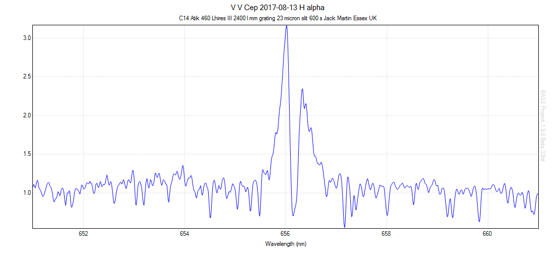

Posted: Tue Aug 15, 2017 7:13 pm
by Jack Martin
vv cep.png (33.19 KiB) Viewed 15612 times
No changes in H alpha emission as of 2017-08-13, I am continuing to monitor.
Jack
jackmartin781@gmail.com
Essex UK

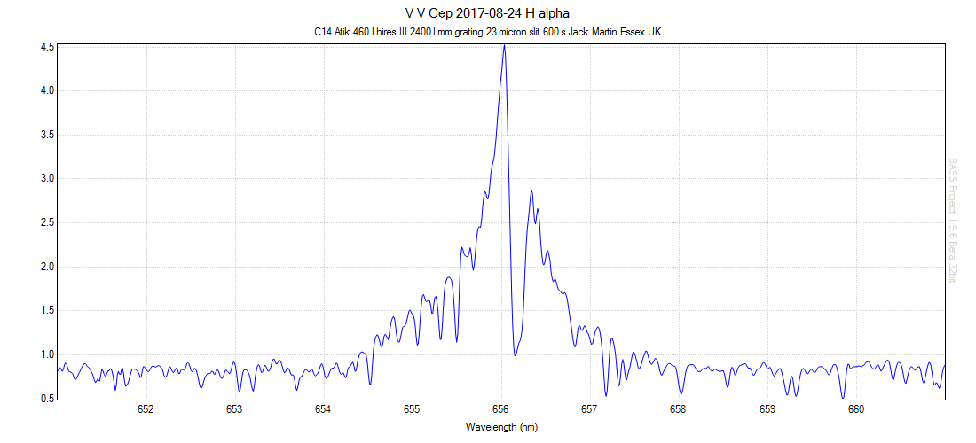

Posted: Fri Aug 25, 2017 5:01 pm
by Jack Martin
vv cep.png (32.23 KiB) Viewed 15570 times
Latest H alpha emission profile as of 2017-08-24.
Regards,
Jack
Essex UK

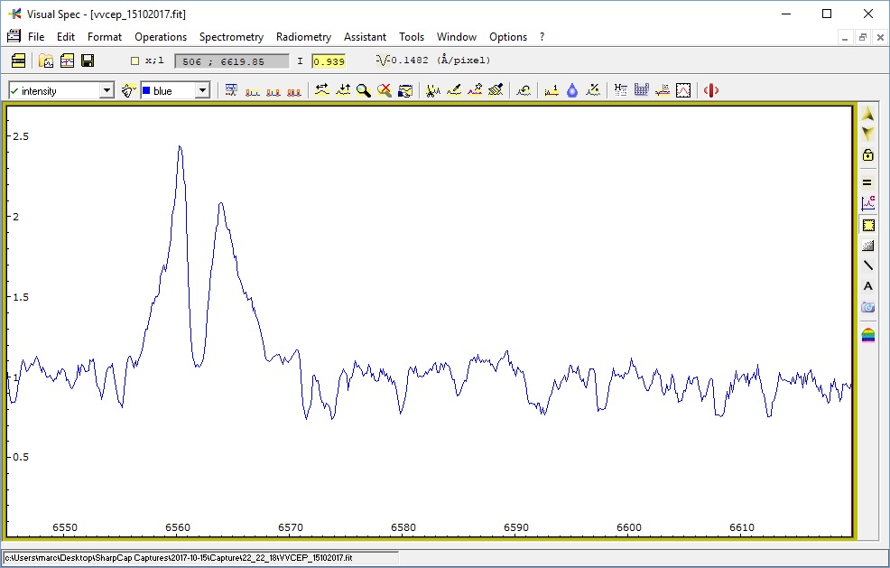

Re: VV Cep this night
Posted: Mon Oct 23, 2017 10:39 am
by marcoastro+
After six (!) weeks of clouded night skies at last one clear night on Oct 15th...
Kind regards,
Marc
