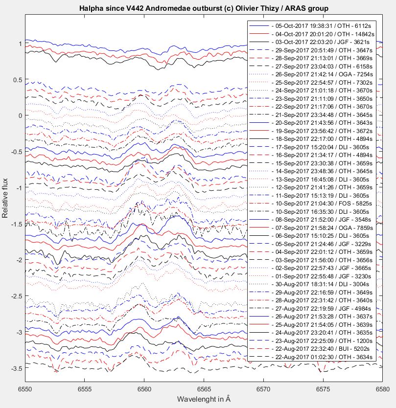

by Olivier Thizy
I have updated the graphs:
https://observatoire-belle-etoile.blogs ... burst.html
V442And daily Halpha evolution aug21-oct05.JPG (210.07 KiB) Viewed 21072 times
Olivier
Re: V442 And Be star in outburst
Posted: Thu Oct 12, 2017 3:58 am
by Olivier Thizy
V442 And is still showing emission in Halpha. While the V+R seems now more stable, the distance (speed) between the two peaks seems to increase.
Updated graphs on my blog:
https://observatoire-belle-etoile.blogs ... ctive.html
Olivier

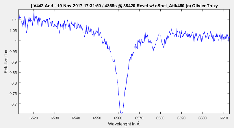

V442 And Be star in outburst - update
Posted: Mon Nov 20, 2017 3:49 pm
by Olivier Thizy
a quick update on V442 Andromedae which went into outburst end of august. The outburst seems done now (to be confirmed) but one spectrum per week would confirm it. Here is the spectrum from last night with no emission visible:
Once the outburst end if confirmed, it would be great to have an intensive two weeks monitoring to get the quiescence phase monitoring folded over the 2.6 days period. I have the feeling that this intensive monitoring whould be done soon so be ready... :-)
Olivier
