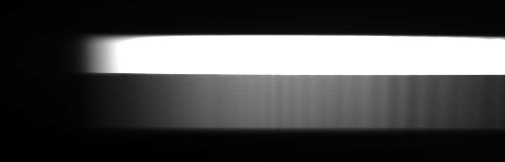

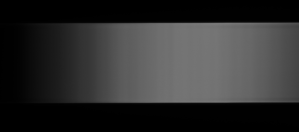

Hi Christian
I have purchased one of these cameras mostly to use on my LISA rather than on a LHIRES.
I was very interested in your comment about minimal rippling.
Unfortunately I have found that there is still rippling at least with the LISA.
Below are 2 flat frames taken with the internal lamp of the LISA. The first was taken some time ago with a ATIK314+ and a regular slit.
The second is with the ASI183MMpro. They are not exactly comparable as the second one was taken through a different slit- a photometric slit with the wide end. The narrow part should be the same though.
The rippling is similar in both cameras. Maybe slightly more pronounced with the ASI183.
This is annoying but it is easy to remove on the LISA with the flat frame.
ATIK314+ flat frame LISA
ATIK314+
ASI183MMpro flat frame LISA
ASI183MM pro
Terry

Hi Terry,
These low resolution ripples are from a different source, most likely interference fringes between much thinner layers in the sensor itself. (Most sensors show these to a varying extent. The sensor used in the ATK314 is one of the best in this respect, it is very severe in the Kodak KAF chips). The ripples in high resolution spectra are interference fringes from the cover glass which apparently depends on whether the sensor cover glass is AR coated. (for example the ATK314 is very good, the ATK414 is terrible)

Terry,
I have a comparison set of flats showing the relative severity of low resolution fringes. If you send me your asi183mm flat as a fits I could compare it with other sensors.

Hi Terry,
I confirm the Robin discussion. Low resolution ripple are induced by detector layers.
The ASI183MM detector ripple is well visible on my graph "ASI183MM vs ATIK460EX absolute quantum efficiency" on the web page:
http://www.astrosurf.com/buil/asi183mm/
This quantum efficiency spectral modulation is very classic with silicon-based detectors. We must not worry about it.
If the flat-field is correctly obtained and applied, there is no problem, this type of instrumental modulation disappears perfectly after post-processing.

Hi Terry, Christian
Here is Terry's flat added to the bottom of my collection of low resolution ripples. (the ASI183MM is not calibrated in wavelength) The ASI183MM is definitely poor in this respect. A problem for slitless spectroscopy (eg with the Star Analyser). A good flat would be definitely needed for slit/fibre spectrographs. (I can still see some residual ripples ~2%pp with my ALPY600 and ATK428 camera even after flat correction using the internal flat lamp.)

Hi Etienne,
etienne bertrand wrote:With this ripples, you think that this CMOS ASI183MMPro is possible to use with LhiresIII ?
You will see these ripples at wide wavelength spacing in low resolution spectra with the LHIRES but a good flat should remove them. The very narrow ripples in high resolution spectra (with the 2400 grating at H alpha) come from the the cover glass, not from the sensor material. Christian's measurements confirm that this camera does not show this problem (probably because the cover glass is AR coated)
