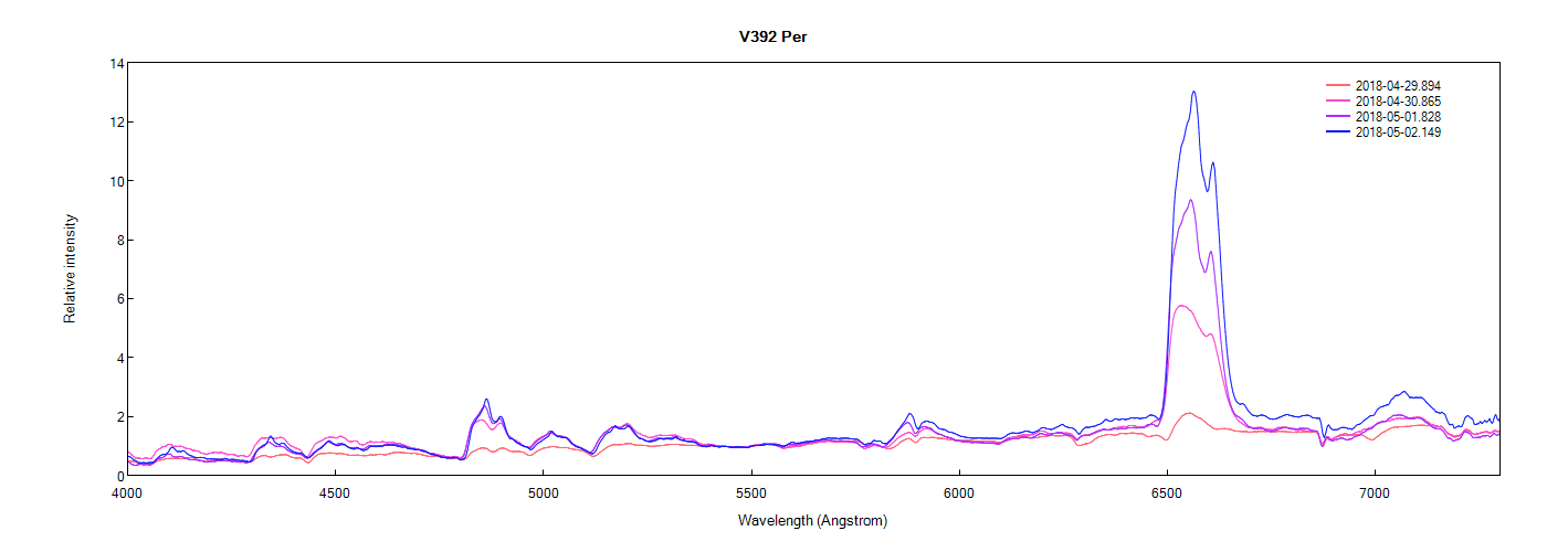

The ARAS group is always very active! Congratulations for your readiness and the excellent spectra. I was just able to observe it, during a brief clear sky moment between clouds and rain.
Lhires III and 1200 l/mm grating, very short total exposure for H-beta region. A little longer for H-alpha region.
The same line profiles (but heliocentric corrected) as a function of radial velocity.
From my observing site the nova will be visible not for long due to a building covering the north-west horizon. Very bad forecasts for the next days... It's a pity!

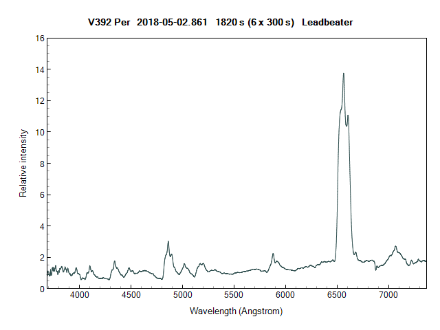

Nice line profiles Paolo ! Here is my ALPY spectrum from tonight, also showing the features developing in the line profiles.
The target is circumpolar from here at 55 North and I have a good north horizon so it may be possible to follow it for some time. Unfortunately it does not get completely dark in June/July though.

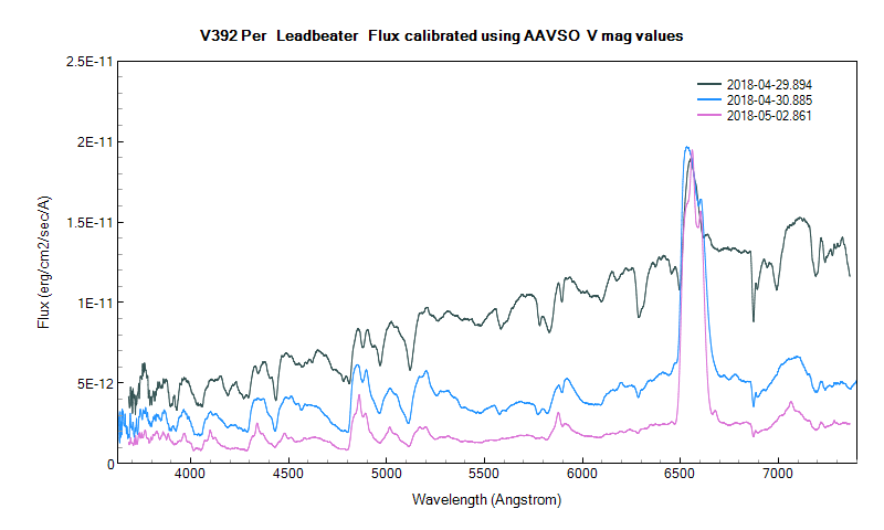

Spectra plotted in absolute flux using V mag values from the AAVSO database. It is interesting to see how the peak flux at H alpha has remained constant as the continuum has fallen away
