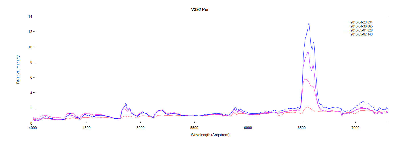

Dear All,
The page is created: http://www.astrosurf.com/aras/Aras_Data ... er2018.htm
Thanks to all and Congratulations!
Daily evolution:

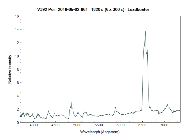

Posted: Wed May 02, 2018 10:26 pm
Nice line profiles Paolo ! Here is my ALPY spectrum from tonight, also showing the features developing in the line profiles.
The target is circumpolar from here at 55 North and I have a good north horizon so it may be possible to follow it for some time. Unfortunately it does not get completely dark in June/July though.

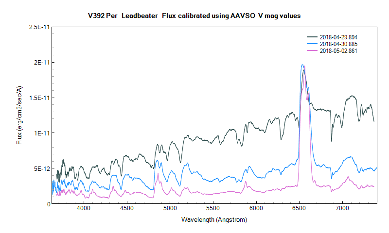

Posted: Wed May 02, 2018 11:15 pm
Spectra plotted in absolute flux using V mag values from the AAVSO database. It is interesting to see how the peak flux at H alpha has remained constant as the continuum has fallen away
