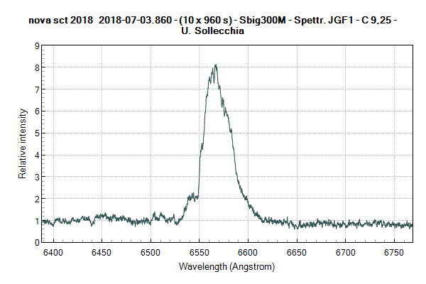

Bonjour, le profil de la nova observé la nuit dernière 03-07-.2018.
umberto
novasct2018_20180703_860_Umberto Sollecchia.png (23.02 KiB) Viewed 28876 times

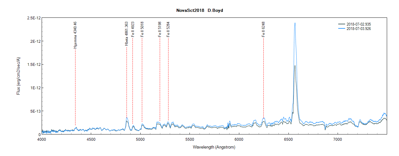

Spectrum last night (3 July) very similar to the night before except H-alpha stronger. The star is also slightly brighter V=10.76 compared to V=10.92 on 2 July.

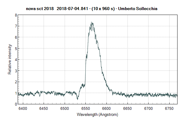

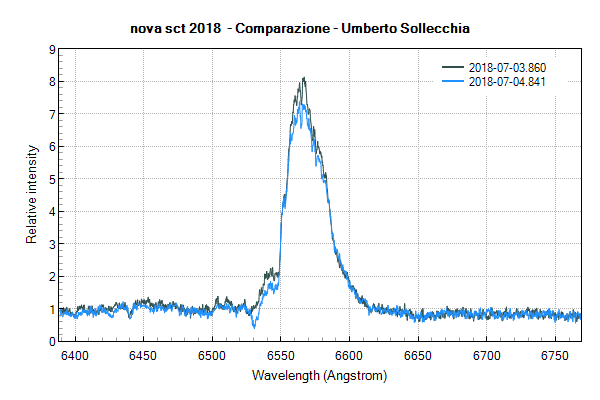

Bonjour à tous, placé le profil de la nova observé hier soir 04-07-2018 et une comparaison avec le jour précédent qui montre la variation de l'absorption du second P-cyg.
novasct2018_20180704_841_Umberto Sollecchia.png (23.43 KiB) Viewed 28837 times
novasct2018 -Comparazione -Umberto Sollecchia.png (30.97 KiB) Viewed 28821 times

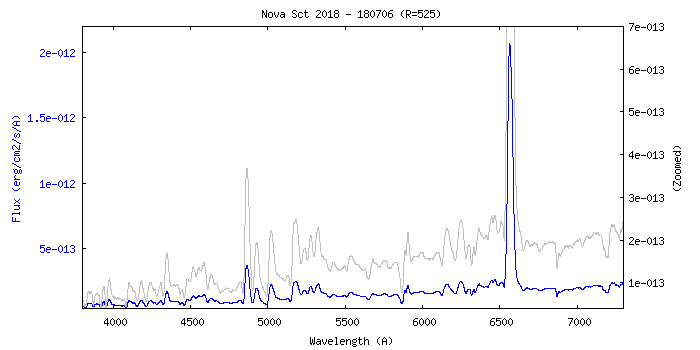

A low resolution spectrum, flux calibrated using an average transformed V mag = 10.934 (from photometry acquired at the same time).
Paul
Nova Sct 2018.png (6 KiB) Viewed 28666 times
