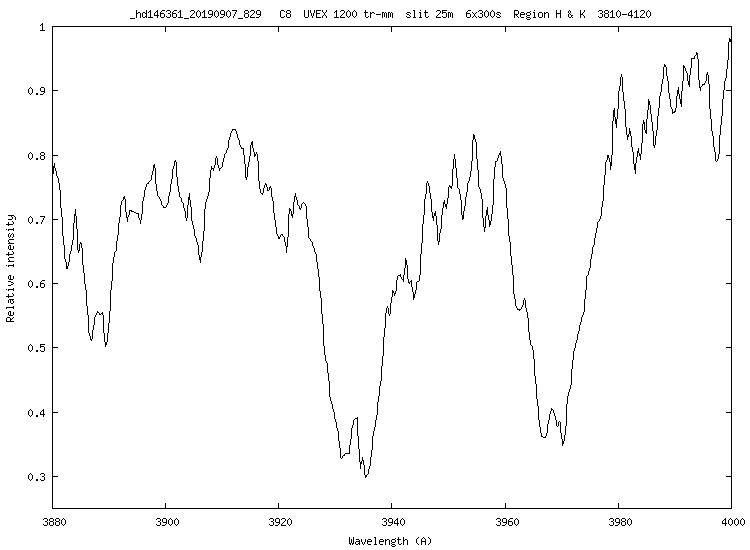

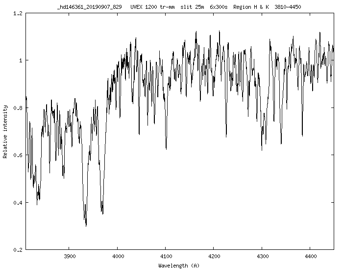

Samedi soir, avant de lancer une série Rr_Lyr j'ai pointé le C8 sur HD 146361.
La prochaine fois je poserai plus longtemps.
region UV  H & K

ZOOM sur la région H & K
HD146361 zoom H & K.png (7.04 KiB) Viewed 167499 times

Re: Chromospheric active stars: a key program for amateurs
Posted: Wed Sep 11, 2019 12:16 am
Pas mal du tout pour une étoile de magnitude V=5,5 avec un C8 ! Belle mise en évidence de l'émission.

Salut,
A combien estimes-tu l'amplitude de l'emission ?
A combien estimes-tu l'amplitude du bruit du continuum proche ?
Benji

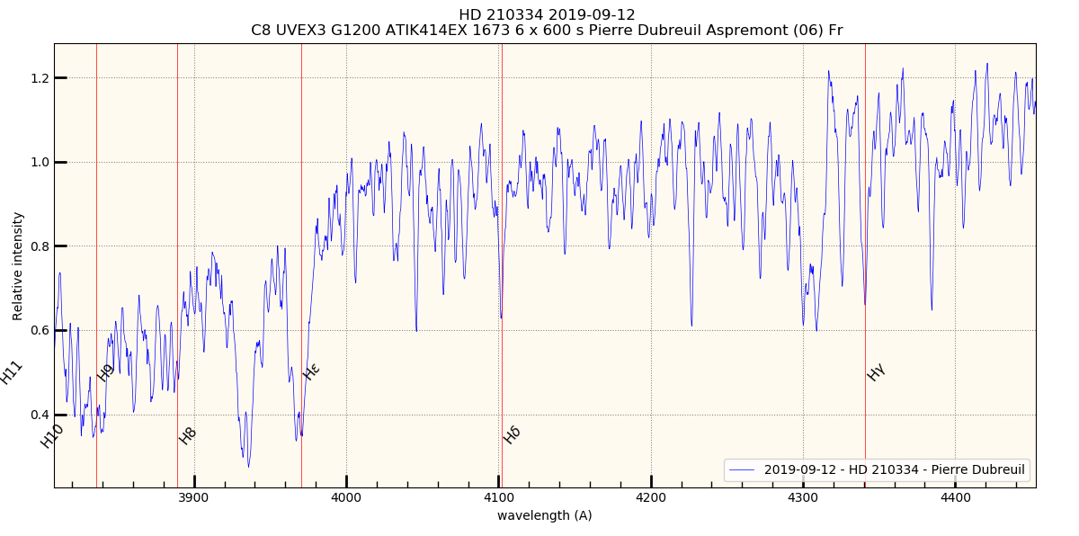

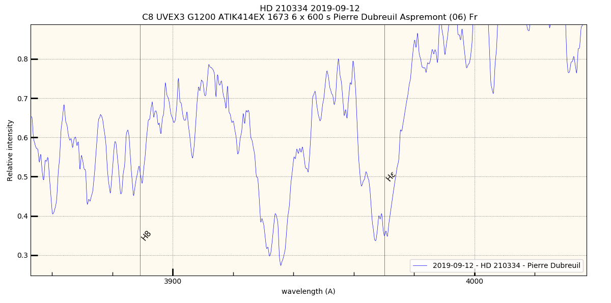

by Dubreuil Pierre
Bonjour à tous
Quelques détails dans H et K pour HD 210334 avec UVEX G1200 slit 25µ
HD 210334 région H & K
HD 210334 chromospherique UV 1200.png (135.49 KiB) Viewed 167414 times
zone H & K
zone H & K
HD 210334 Zoom UV 1200.png (94.56 KiB) Viewed 167414 times
Le SNR est semble-t-il OK mais je ne sais pas l'estimer ! comment faire sous ISIS ?

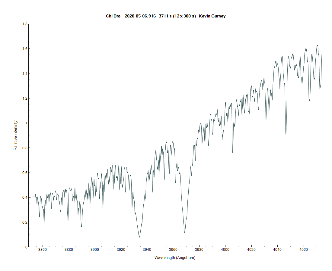

Posted: Sat May 16, 2020 7:52 pm
by Kevin Gurney

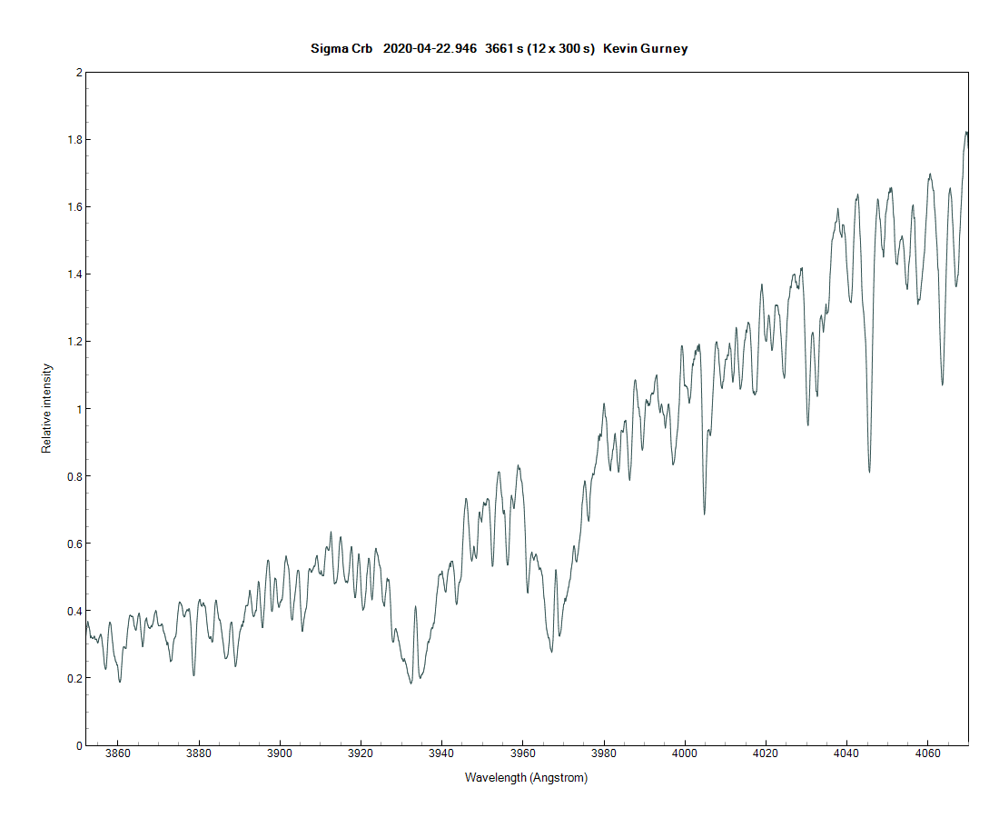

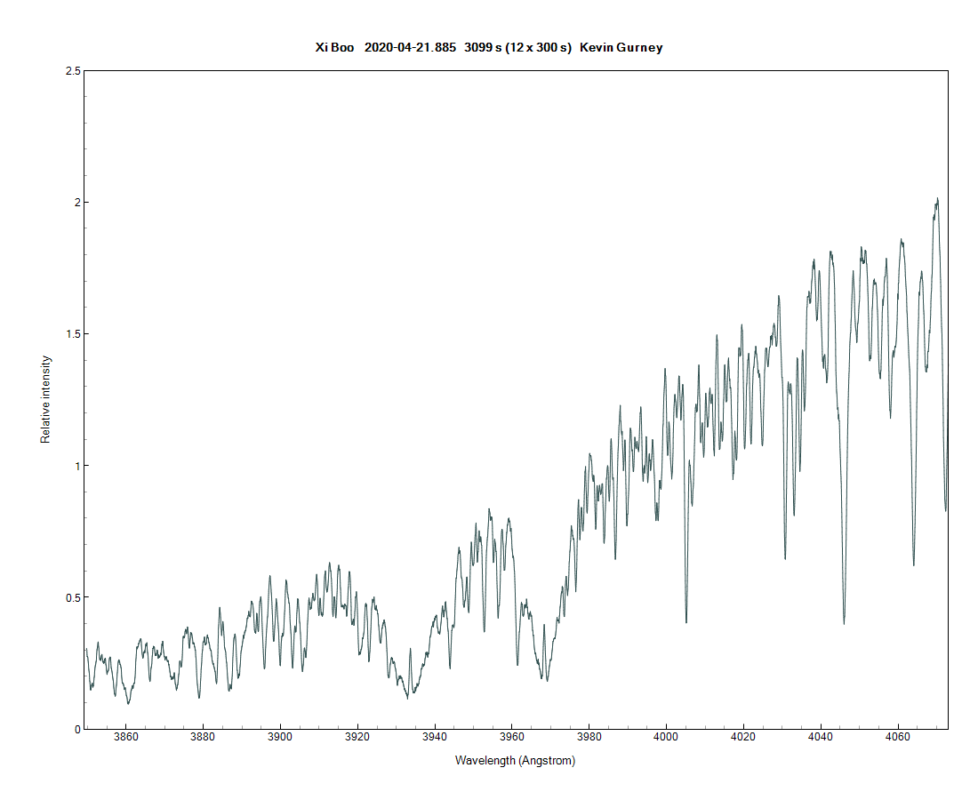

Hi there
My interest was piqued by this project so I tried a few targets....
sig Crb (HD 146361), Xi Boo (HD 131156) and Chi Dra.
My first post here, and not sure how to supply images (FAQ says they have to be on a public server...? Agh - I see you can attach and place inline)
I used two calibration lines (3948.979A, and 4044.418A) in the Lhires Neon lamp which are due to traces of Argon I believe (I hadn't changed to the Argon/neon lamp). I reverse engineered them from the spectral features, and the NIST database.
If I follow this further, I'll change the lamp!
I used a C11 with Atik460EX. Location is suburban area.
Xi Boo 21 April
Xi Boo 21 April
Chi Dra 6 May
Chi Dra 6 May
sig Crb 22 April
sig Crb 22 April
best regards
Kevin
Posted: Sat May 16, 2020 9:16 pm
Hi Kevin, excellent H&K spectra. I suspect you use a Lhires III 2400 l/mm + 23 microns slit. It's OK ?
(not easy to calibrate, fine use of faint argon lines)
