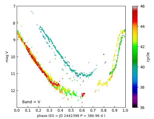

V mag according to phase (AAVSO data)

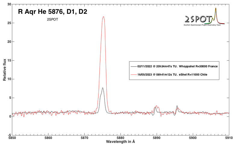

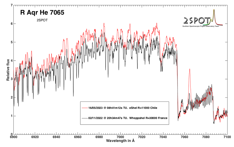

R Aqr taken this morning from Chile with a window of only 2 hours before dawn.
the full spectrum with an eShel (R=11000), the target is about mag. V=11,5
and some evolution from our last spectrum taken in november 2022 with a whoppshel (R=30000)
