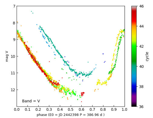

Posted: Sun Apr 23, 2023 5:37 pm
The Mira Symbiotic R Aqr, is still in a peculiar state. The absorption in B and V band remains strong.
Margarita Karovska continues the study of the target and obtained observation time with HST scheduled May 5-8 2023.
She requests spectrocopic observations in visual range during and around the HST run.
Send spectra to francoismathieu.teyssier at gmail.com and copy to arasdatabase at gmail.com for inclusion in the database.
Best,
V mag according to phase (AAVSO data)
