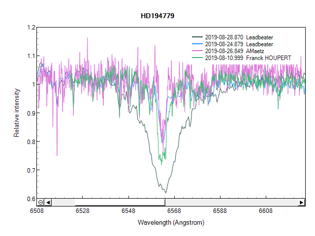

Here's the evolution of HD 194779 with two others spectra in Bess
Posted: Fri Aug 30, 2019 12:56 pm
Very interesting! Thanks for the confirming spectrum. Here is the spectrum I took on 28th. (zipped fits file) It looks so different that I am not sure it is the right star. How does it look superimposed on the other spectra ?
EDIT: now confirmed. the observation 20190828 is of a nearby A3V star, not HD194779
Posted: Fri Aug 30, 2019 2:46 pm
Olivier GARDE wrote:Here's the evolution of HD 194779 with two others spectra in Bess
Jon has updated the table requesting priority higher cadence monitoring of HD194779 until the end of this TESS sector
"Recent spectra show Halpha activity beginning on Aug. 28-29.
Continue to monitor. If possible, get 2 spectra per night- one early and one late until Sept. 11 2019. High SNR will be useful to compare to TESS data."

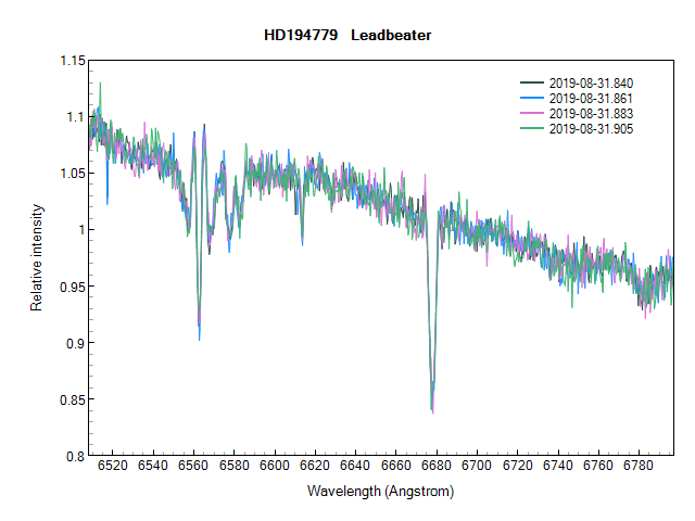

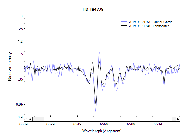

HD194779 last night (R~5500, SNR ~300).
There has been some small evolution in the last 2 days. (The profile is now symmetric.) Valerie's book of spectra shows a similar event in 2014
(Tellurics removed, rectified, filtered to match resolution)
No short term variation above the noise between 4x 30min spectra (SNR~150)
