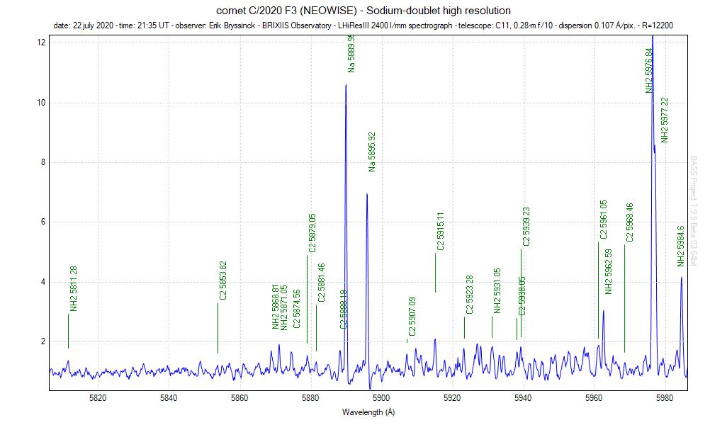

On 22 July I was able to take a spectrum of the comet c/2020 F3 (NEOWISE) in a narrow observation window (understandable in time) with the LHiRESIII and 2400 l/mm. The comet was followed on the core and the slit was positioned on the photocentric core. slit 32µm and C11 telescope on f/10. The aim was to observe the Na-doublet. An instrument response was performed on a nearby suitable star. Exposure time was 4 x 600 sec. I could not detect a doppler shift.
best regards
Erik.

Erik Bryssinck wrote: I could not detect a doppler shift.
Nice result Erik. That extends the time of Na D emission beyond my 2020-07-20 result
The comet was just about at its closest to earth so low RV (JPL Horizons gives just -0.7km/s RV geocentric)

Robin Leadbeater wrote: The comet was just about at its closest to earth so low RV (JPL Horizons gives just -0.7km/s RV geocentric)
Can you see the NaD absorption lines in the scattered sunlight? These should have been shifted redward by a total of 38km/s according to JPL Horizons
