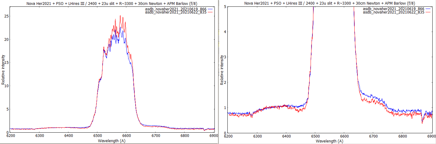

Hi Peter,
Your titles say 2400 grating and R~3300. Is this correct (600 grating?)
Re: Probable nova in Hercules mag 6.4 !
Robin Leadbeater wrote: Your titles say 2400 grating and R~3300. Is this correct (600 grating?)
Sorry, I've overlooked an old value in ISIS -> Gnuplot -> double plot (has to be filled manually), should have been 600/mm grating.
The .fit headers are correct.
