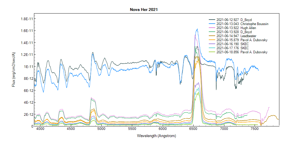

Here is a plot showing the evolution of the nova over the period 12-18 June using low resolution (R~500-1000) spectra from the ARAS database calibrated in absolute flux either by the observer or using V mags from the AAVSO database averaged in quarter day bins and interpolated to the times of the spectra.
Nova Her 2021 12 - 18 June.png (97.17 KiB) Viewed 13148 times
