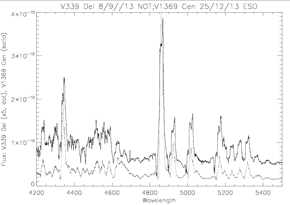

A spectrum from Steve Shore (comparison between Nova Del and Nova Cen)
Bonne continuation
François (waiting the fits ;) )

Hmmm
Some of the detail looks comparable...loss of detail/ resolution down around Hgamma - probably due to focus?
Re. the continuum - I see the rise in my spectrum above the Hb - camera response?

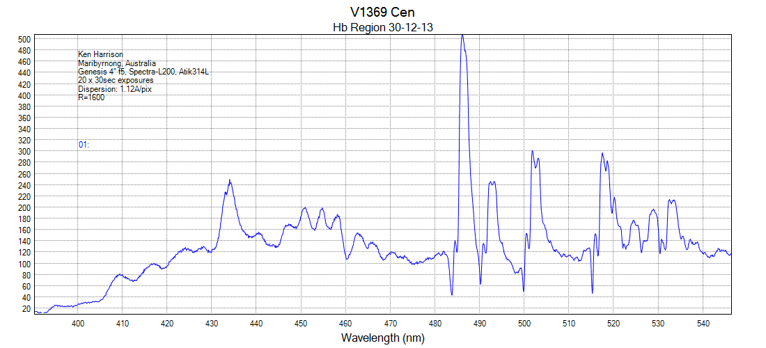

I managed to get a spectrum of the Hb region before the clouds moved in.
The Hb and Fe line profiles seem to be showing a "secondary" (P-Cygni?) dip.
Any comments??

Ken
My spectra from the previous day shows a similar structure. I note a big difference in the Hg region though comparing the 2 spectra.

Ken : this is the classical multi-absorption system, well discribed by the precurssors, as Mc Laughlin (1960) or Payne Gaspochkin (1959)
Premaximum spectrum : "broad, blue shifted- absorption lines, often with addition of P cygni profiles"
Principal spectrum, at visual maximum : stronger and more blue-shifted absorption lines. They often show multiple substructures and they evolve into emission lines
Diffuse enhanced spectrum : appears after the maximum light : similar to principal spectrum but about twice as broad and blue-shifted

Soft focus at the blue end in Ken's spectrum perhaps? The Achromatic doublet in my LHIRES for example would certainly struggle to keep things sharp from 5400 to 4000A. The optics in the ALPY (and LISA) are so much better in this respect.
