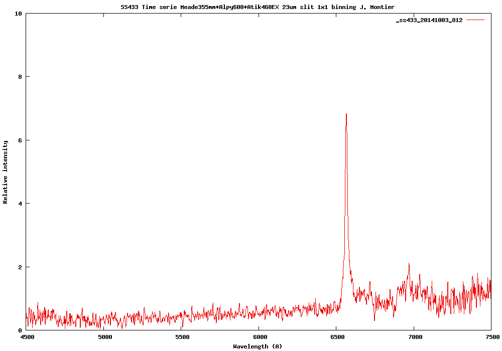

Posted: Sat Oct 04, 2014 1:14 pm
by Jacques Montier
A time series try of SS433 with 10 spectra of 600s exposure.

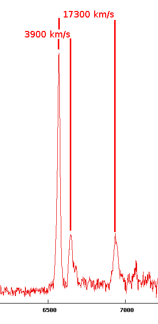

Re: SS433 micro quasar outburst
Posted: Tue Oct 14, 2014 1:27 pm
by Jacques Montier
Thanks François,
I estimated some Halpha speeds on 2014/09/30
Very impressing !
