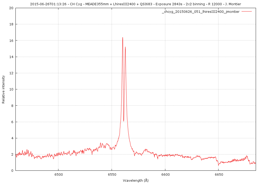

Posted: Fri Jun 26, 2015 12:40 pm
by Jacques Montier

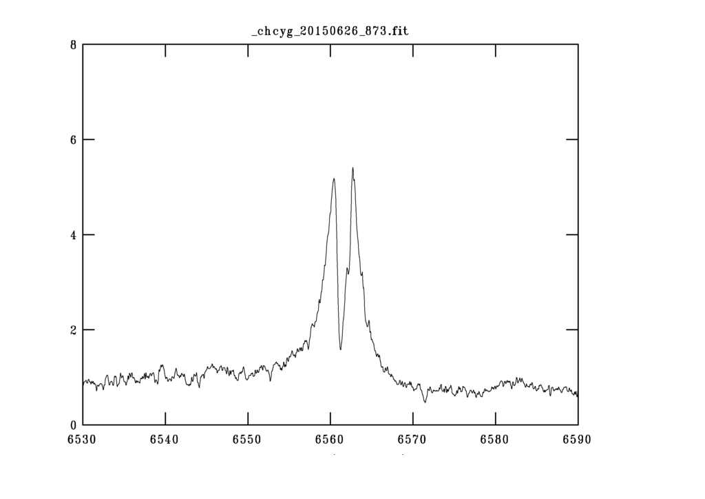

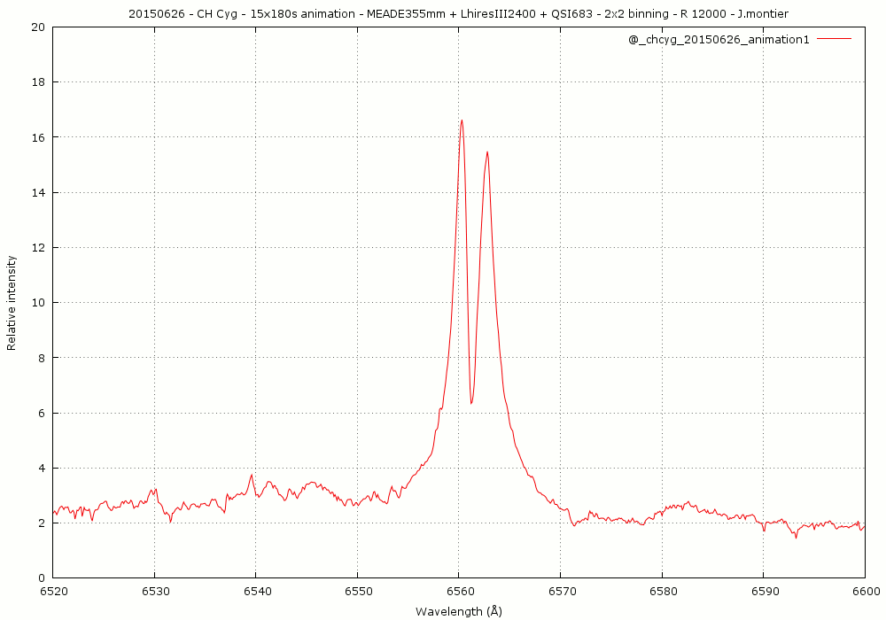

CH Cyg spectrum of the last night 2015/06/26
Animation of 15 profiles of 180s each.
The small Halpha line oscillation seems to go on.
Regards,

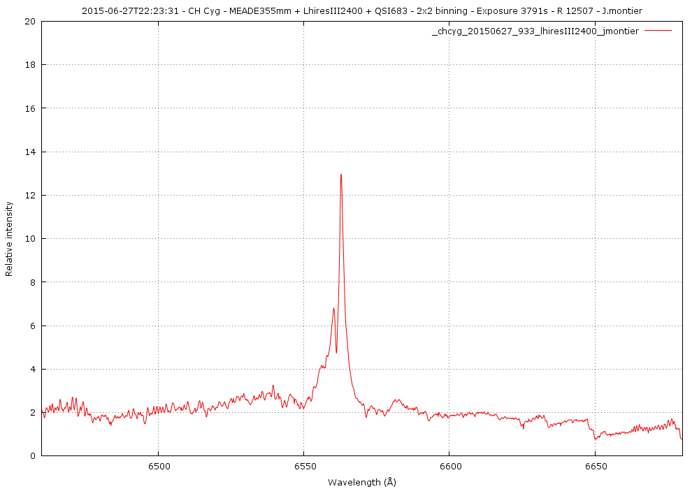

Re: Dramatic change of H alpha profile
Posted: Sun Jun 28, 2015 1:03 pm

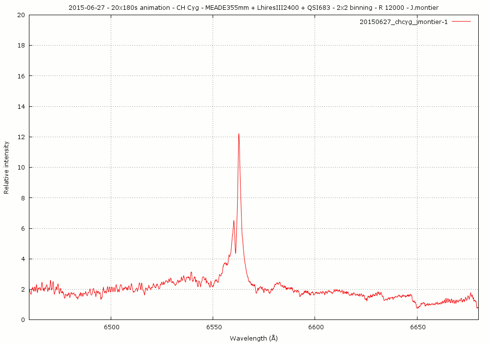

by Jacques Montier
On 2015/06/27, blue wing of Halpha line has decreased a lot.
Peter, you observed the beginning, so we missed the transition...
Here is the animation with 20x180s spectra.
The profile looks quiet.

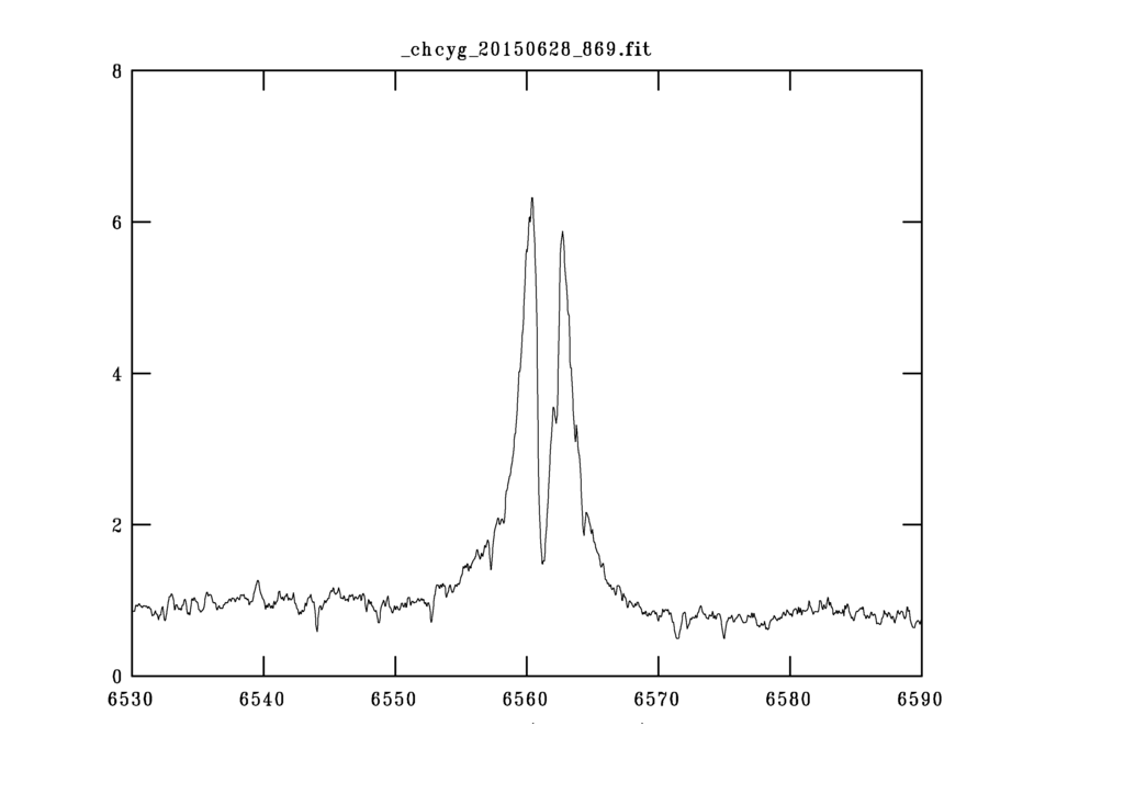

Posted: Mon Jun 29, 2015 8:31 pm
by Peter Somogyi
Yesterday it had double peak again (6:1 - 5:1 ratio of Ha/cont., Lhires 2400/mm, 15um slit, R~25K, 13 x 5 min):
Taken through randomly going over clouds (= variable SNR), finally had to give up.

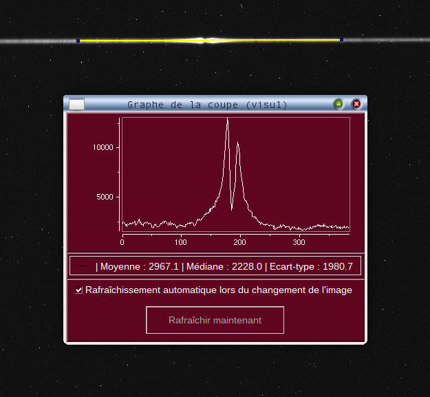

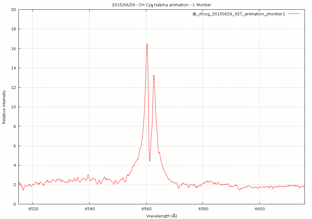

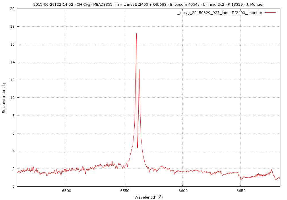

by Jacques Montier
CH Cyg spectrum of the last night on 2015/06/29
Animation with 24x180s spectra
Double peak again with a very impressive blue wing Halpha line.
PS : a strange and slight wavelength shift along the 24x180s spectra ; neon calibration lines moving during monitoring with LhiresIII ?

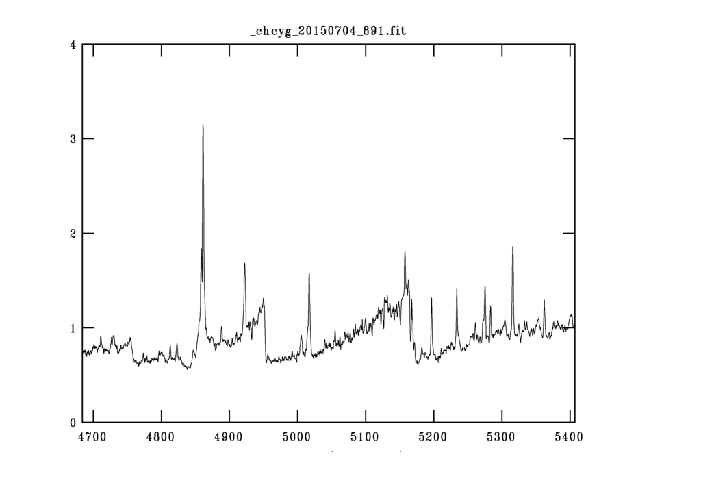

Posted: Sun Jul 05, 2015 9:14 pm
by Peter Somogyi
Yesterday I was experimenting around H-beta with LHires + 600/mm + 15um slit, got around R~3000 in blue (which I'm satisfied because blue is less good at res. - at blue end, I can't even focus properly all the range).
3 minute exposures, with a few cal. pauses:
Interpolated 3 times a ref.star Iot Cyg.
Took a bit few Ne/Ar manually (hopefully automated today...) but in return, exposures quite continuous with 3 bigger breaks.
Processed by ISIS, other than ref. star interpolation have not touched the continuum.
Note: this is also my lesson to get more precise calibration, after returning to lower it's more obvious...
