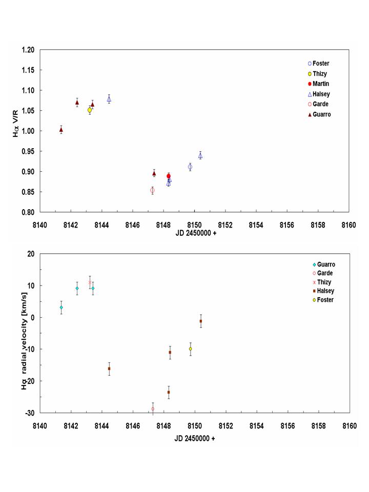

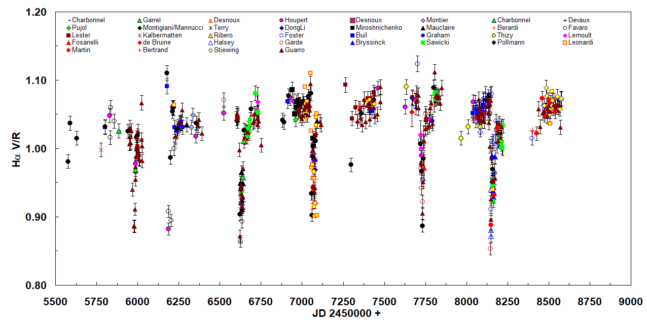

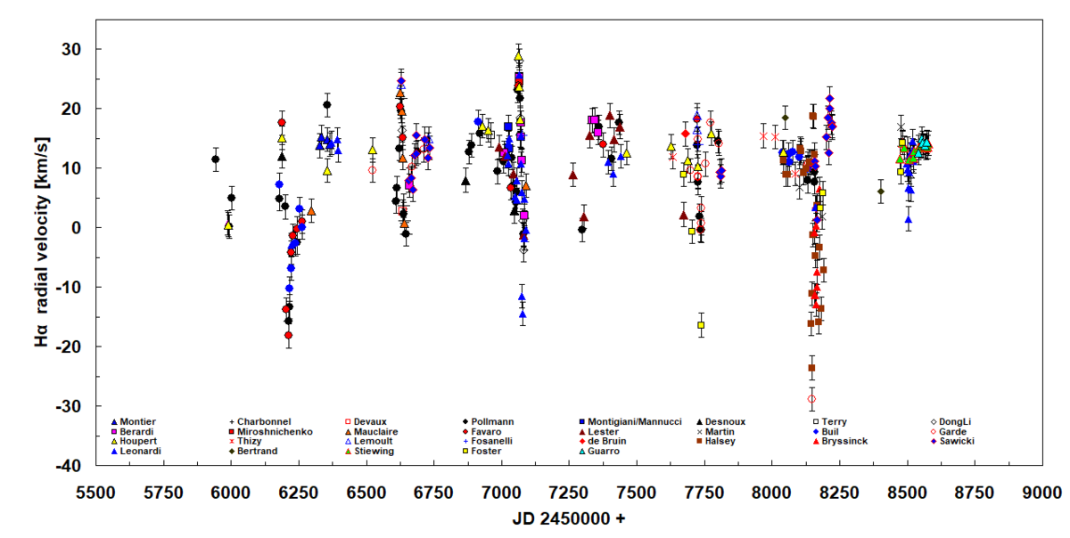

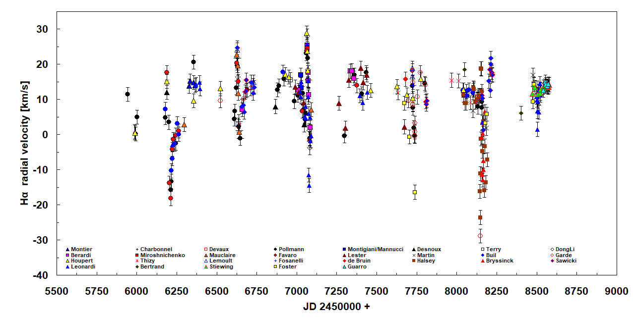

Dear colleagues,
here I want to show once more in detail the 28 Tau periastron observation of several members of the ARAS group.
The evaluation of V/R and RV allows very precisely the time determination of the periastron passage. This result shows impressively the advantage of campaign observations within a community. It shows also very clear the process of disk deformation at the V/R change during the minimum of the radial velocity, a phenomenon that could be observed for a first time since August 2011 (approx. JD 2455800), when the mass of the disk reached the minimum.
This disk minimum is reflected in our monitoring of the Halpha EW (see the following monitoring). Ernst Pollmann

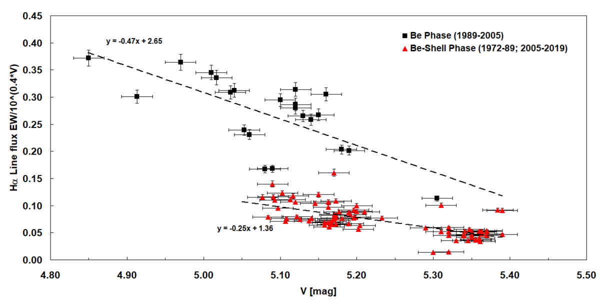

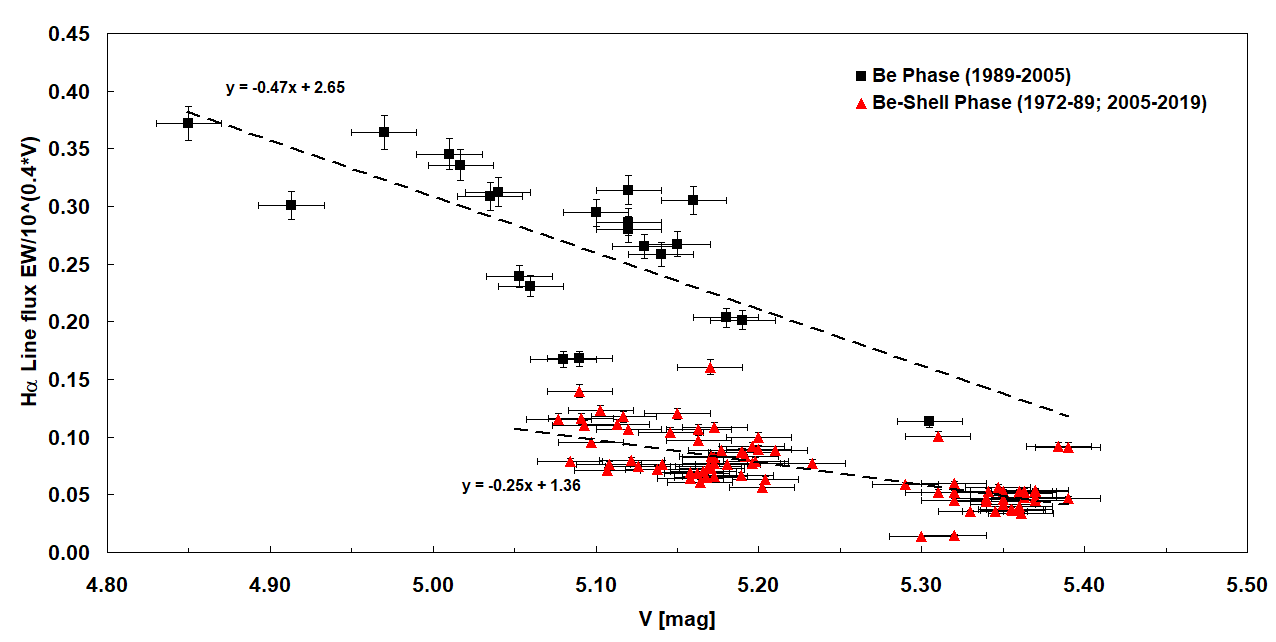

- Posts: 461
Re: 28 Tau ARAS monitoring

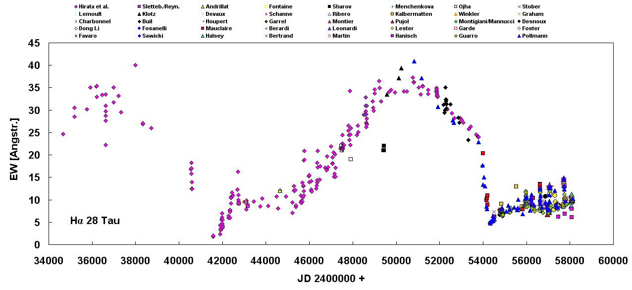

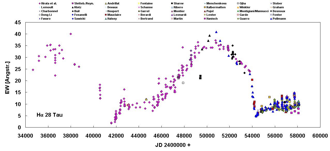

Dear colleagues!
Investigations by astronomers of the University "Western Ontario" (Canada) on the topic "Equivalent width of Be star disks and V-brightness" and related modelling efforts are the reason for our measurements on the same topic.
The attached diagram shows in our study the relationship between the Halpha line flux and the V-brightness of 28 Tau. Therein, the line flux is derived from the Halpha equivalent width (see definition on the ordinate; EW measured from spectra of ARAS observers; Vmag measured by W. Vollmann, Vienna).
It seems that in the Be-Shell phase, the steepness of the line is less than in the Be phase (see straight line equations).
What are the reasons?
I mean, the deeper central absorption dip (CA) in the Halpha emission and hence the corresponding lower line flux leads to a less steepness during the Be shell phase. In our monitoring, we also observe a CA variability that changes in the cycle of periastron passages with a period of 218 days (http://ibvs.konkoly.hu/pub/ibvs/6201/6239.pdf) A possible cause for this could be a libration of the disk rotation axis. It will be interesting to see how, in the future, this correlation changes from the Be-Shell phase to the Be-phase. Thanks to all the ARAS observers for their spectra which enables to study that phenomenon.

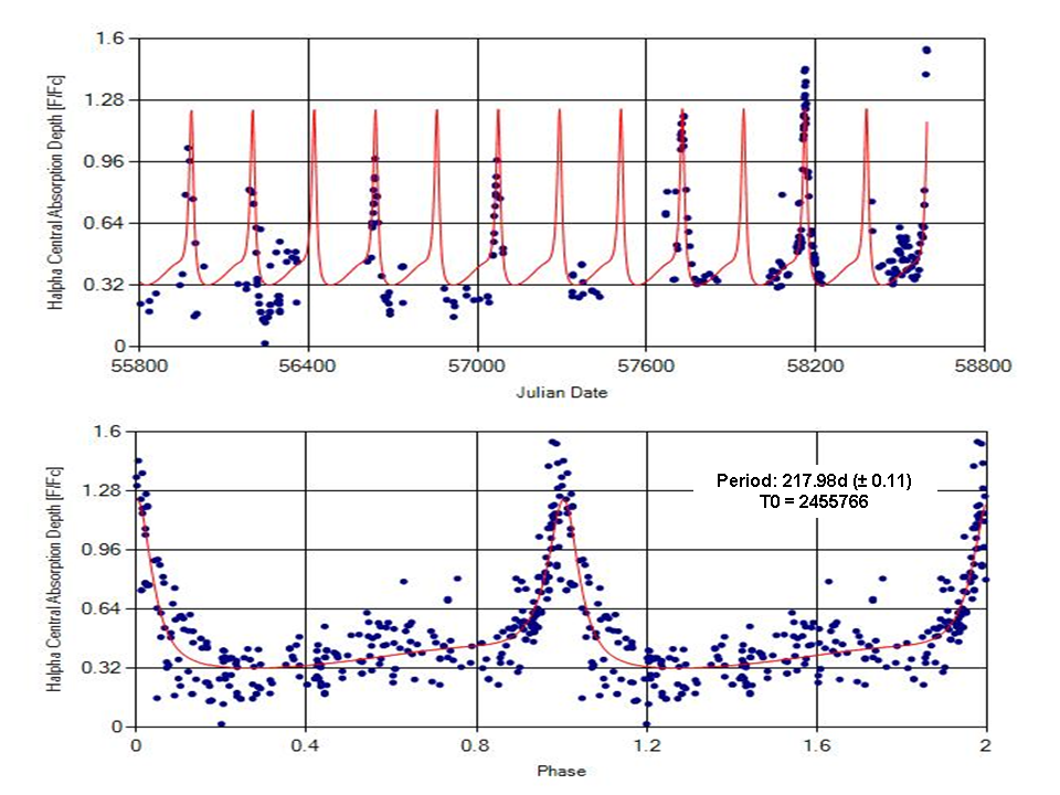

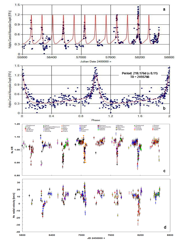

- Posts: 461

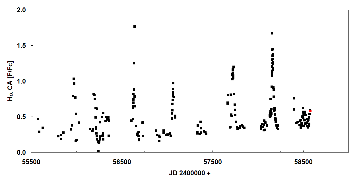

Dear colleagues,
thanks to tireless observations by A. Stiewing, J. Martin, J. Guarro and M. Leonardi, the periastron passage on April 9th 2019, has been captured by measurements of the parameter CA (central absorption depth of Halpha), the ratio V/R and the radial velocity RV.
Even if the passage because of the visibility conditions was not captured for 100%, the orbital period of the companion of that Be binary system have been confirmed with 218.176 days. See also:
Obviously the parameter CA seems to be particularly useful for such a studies (at least at Pleione). The next periastron passage will take place on November 19th 2019.
The attached Fig. a shows the time series of CA, Fig. b shows the phase diagram of the period analysis, Fig. c shows the ratio V/R and Fig. c shows the radial velocity RV. Ernst Pollmann
- Posts: 461
Further spectra of Al Stiewing (Arizona), which were the last possible in this visibility period, precises the orbital period (see phase plot).
Great engagement of Al, thank you so much. Ernst Pollmann
