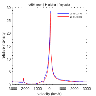

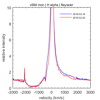

Variation of H alpha line
16-02-2016
23-02-2016
_v694mon_20160223_835_H alpha_1.png (13.68 KiB) Viewed 10818 times
crop
_v694mon_20160223_835_H alpha_2.png (14.03 KiB) Viewed 10818 times

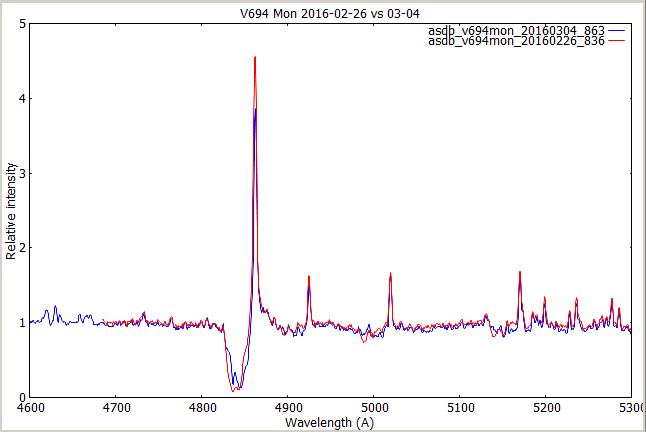

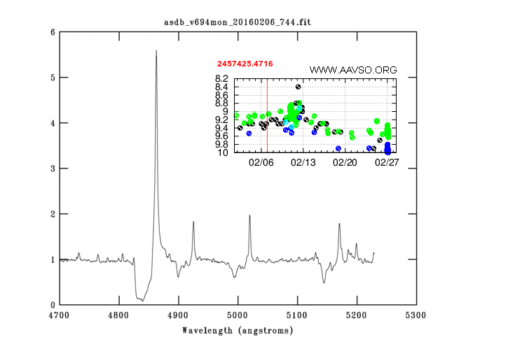

Let me present all my recent observations (including 3 new ones) around H-beta, together with acquiring data from AAVSO (putting together as an animated gif):
As you can see, only the three Fe II multiplets absorption seems to be changing (and line intensities).
Note: I have noticed a wavelength calibration problem - was using wrong calibration line on the right edge (asdb_v694mon_20160206_744, asdb_v694mon_20160211_884) - will send the fix together with the new spectra to the database soon. On this movie, the fix has already been applied.

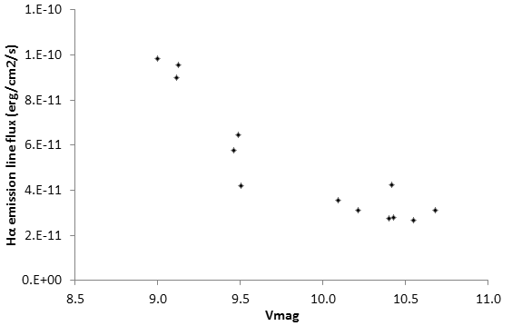

H-alpha flux vs V mag.png (7.96 KiB) Viewed 10772 times
This graph shows how the H-alpha emission line flux has varied with V magnitude as V694 Mon brightened from 10th mag in early 2015 to 9th mag in early 2016. The H-alpha flux increases by a factor of ~4, the same as the increase in the flux of the star.

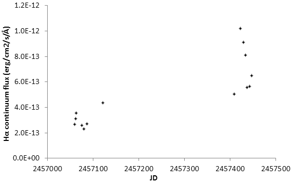

H-alpha flux vs JD.png (9.11 KiB) Viewed 10735 times
Hello Francois,
Here is the variation of H-alpha flux with JD.

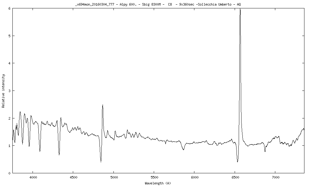

Bonsoir à tous, voici le profil de l'observation de 02/03/2016.

Salutations Umberto
