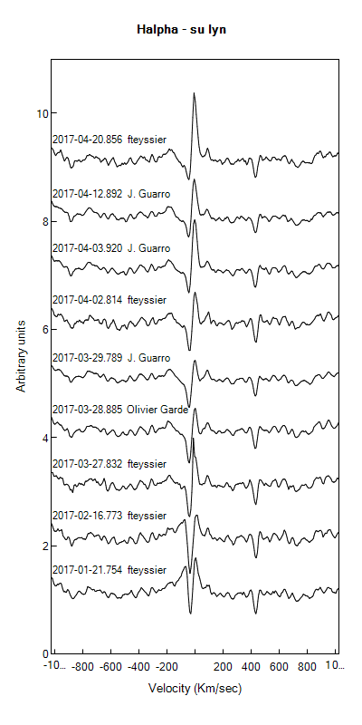

A comparison between 2 spectra taken about 1 month interval (28th march and yesterday).
H Alpha and H beta line intensity increase about 60% (corrected from heliocentric velocity)

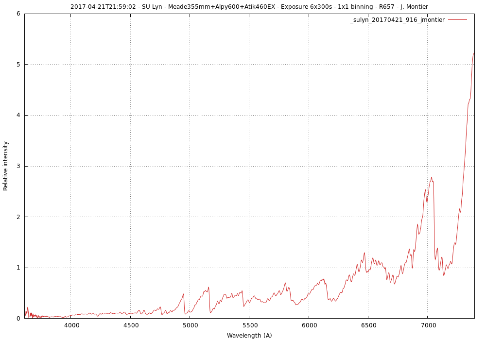

Re: SU Lyn Call for observations by Katarzyna Drozd
Posted: Sat Apr 22, 2017 12:54 pm
by Jacques Montier
My contribution to SU Lyn
Regards,

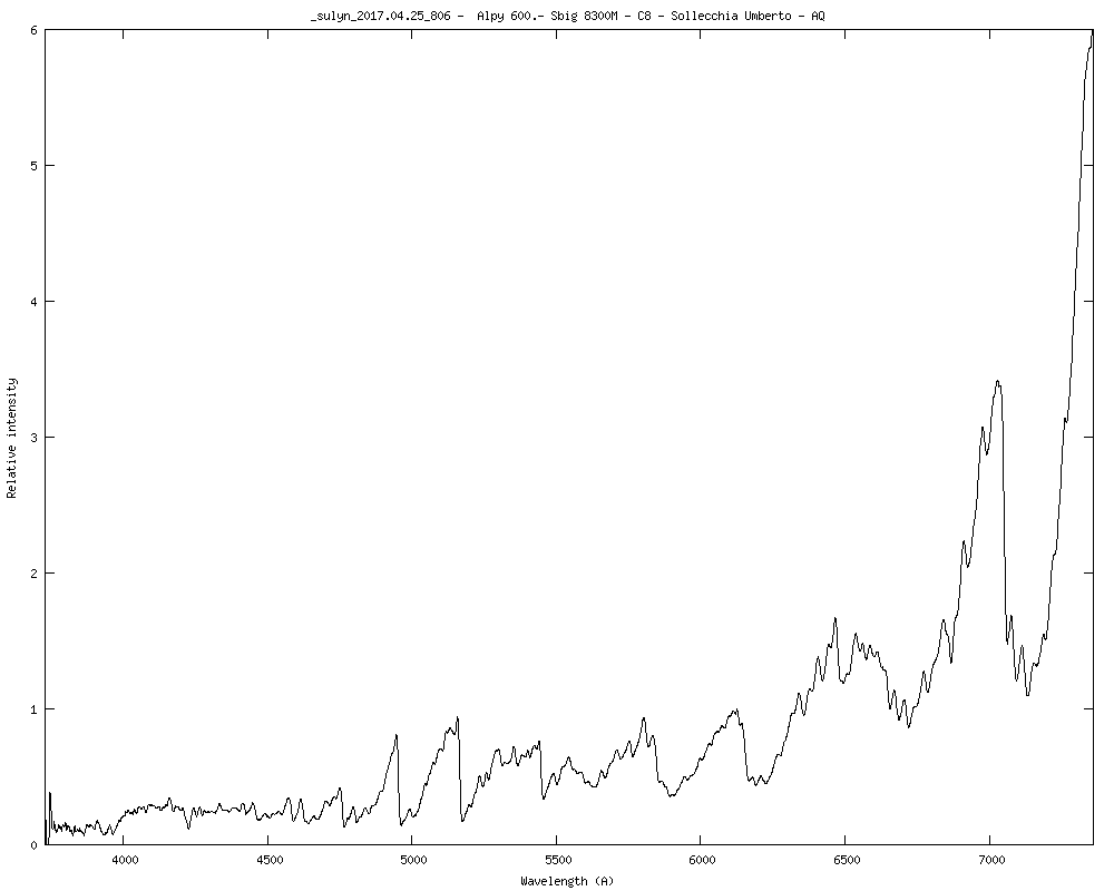

Posted: Wed Apr 26, 2017 4:26 pm
by umberto sollecchia
Bonjour, mon observation de 25/04/2017.
Profilo SU _Lyn.png (8.02 KiB) Viewed 13642 times

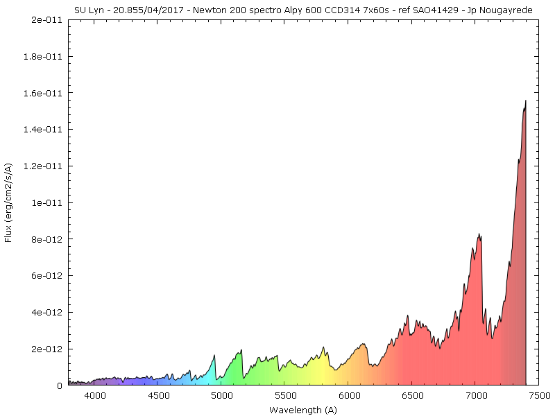

Posted: Fri Apr 28, 2017 9:10 pm
by JP Nougayrede
Buongiorno,
SU Lyn en basse résolution le 20.8/04/2017, flux absolu, pour référence HD 50420 (V 6.15 à 5293A)
Bon ciel,
Jean-Philippe
Posted: Sat Apr 29, 2017 6:51 am
Impeccable, Jean-Pierre, j'attends ton spectre pour la base

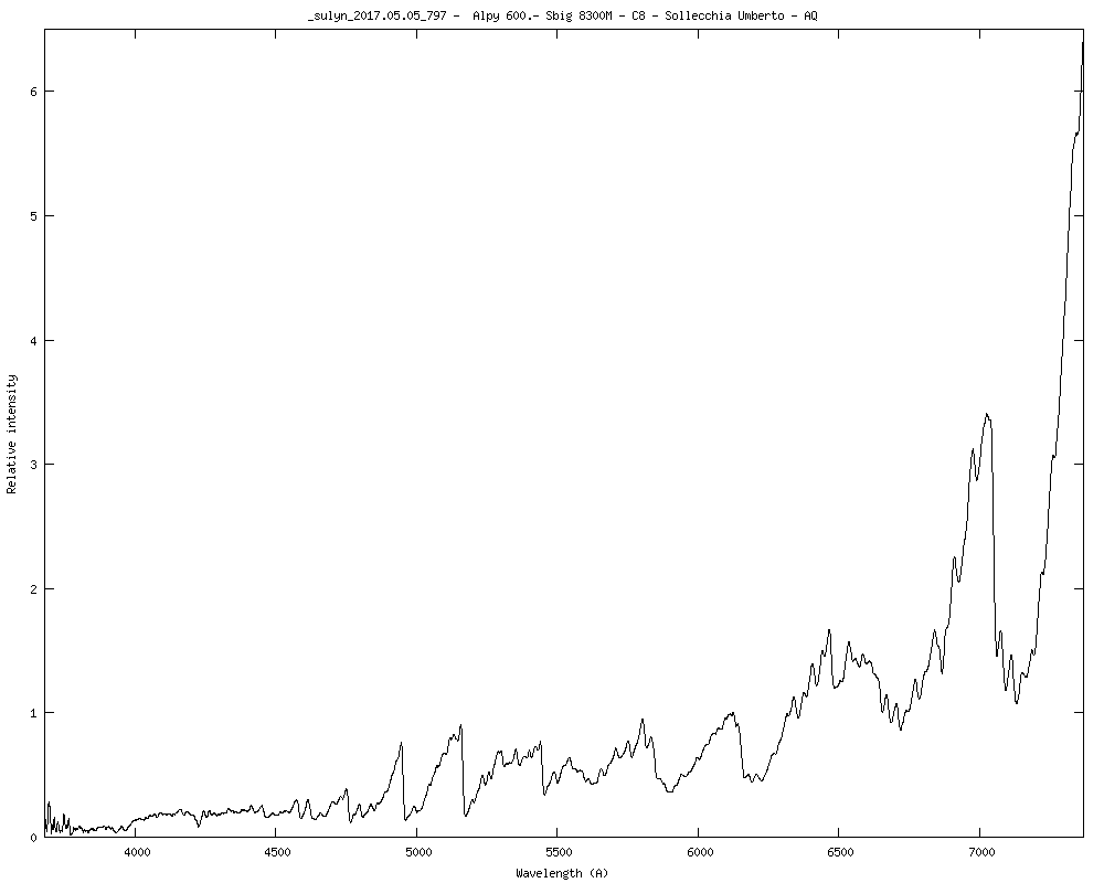

Posted: Sat May 06, 2017 9:19 am
Bonjour à tous, placez l'observation du jour 05/05/2017.
Profilo SU Lyn.png (7.75 KiB) Viewed 13488 times
