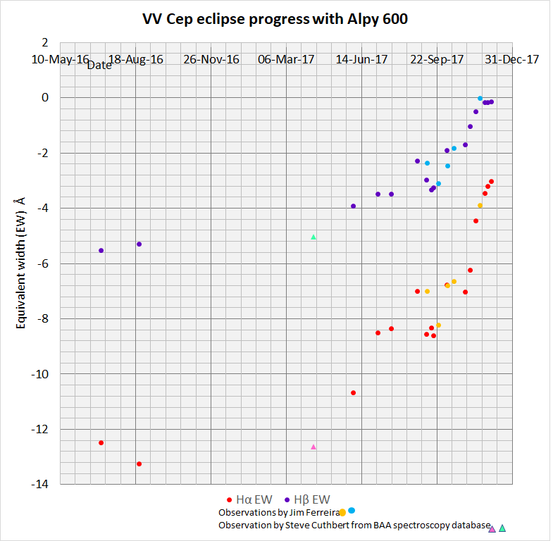

Latest estimate of the evolution Hα and Hβ Equivalent Widths based on Alpy 600 spectra, along with the latest spectrum obtained last night
Hugh
VV Cep Hα and Hβ EW evolution Jul '16 - Dec '17.png (35.92 KiB) Viewed 25671 times

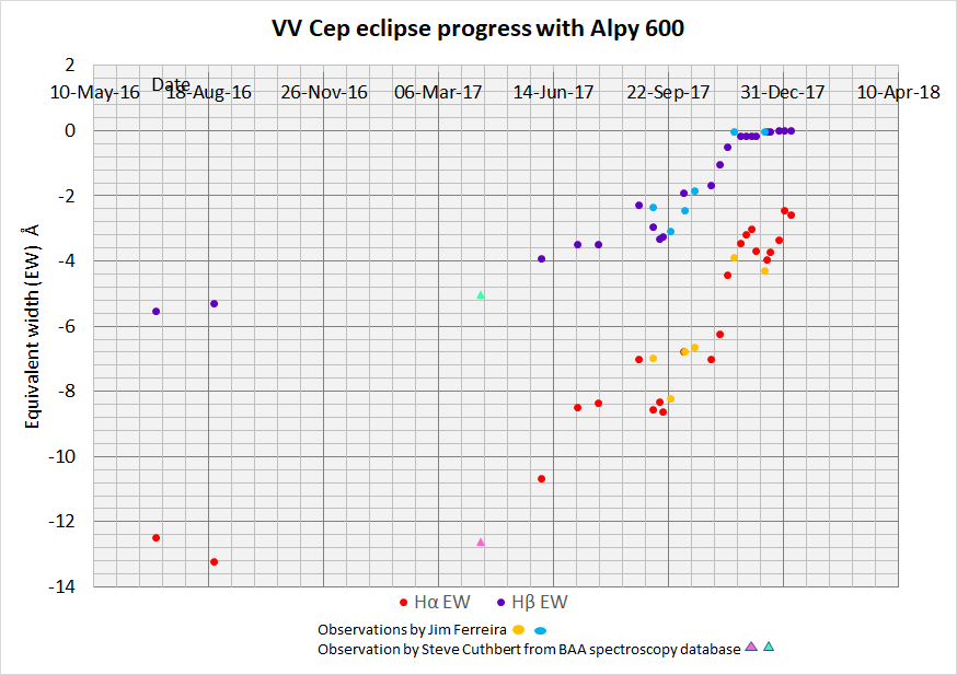

Low res observation is showing that another Hα brightening cycle is underway. The last observation on the graph is from Thursday night 7th December....
VV Cep Hα and Hβ EW evolution Jul '16 - Dec '17.png (38.48 KiB) Viewed 25629 times

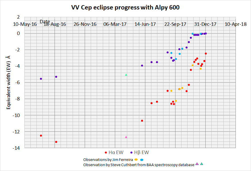

New Year's Day evening provided a windy opportunity to capture the first VV Cep spectrum of 2018. The fading of the Hα has picked up pace again after the most recent brightening cycle....
VV Cep eclipse progress up to 1st Jan 2018.png (27.83 KiB) Viewed 25538 times

Has the Hα eclipse reached second contact at last? My latest observation tonight 7th Jan suggests that the fading of the Hα emission may have reached a plateau.A cycle of brightening now would not be expected based on the approximate period that can be discerned in the earlier data. Another measurement in a few days time would be ideal....
VVCep eclipse progress to 7th Jan 2018.png (28.5 KiB) Viewed 25468 times

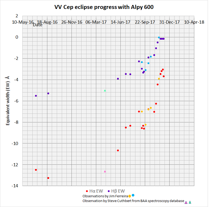

Latest update to my chart of Hα and Hβ Equivalent Widths. Thanks Jim Ferreira and James Foster for providing their spectra so that we have much better sampling of the two curves. The Hα curve had been showing a general decline overlaid by periodic re-brightening in line with Ernst Pollmann's high resolution results. The latest results are deviating from that pattern. Perhaps a sign that deepest eclipse of the Hα region has now been reached?
Hugh

by Ernst Pollmann
Hi Hugh,
in order to compare your graph with the total ARAS EW monitoring, I have drawn it for the same time section as yours. As you can see, there is an certain agreement of the variabilty in your diagram to ours.
The deviation of yours to the ARAS monitoring is caused maybe by the clear lower spectral resolution of your used spectrographs. The integration interval of EW determination of the ARAS monitoring is between 6551 to 6573 Angstr. The accuracy of the EW measurements is (+/-) 5%. Could you say something about the interval and the accuracy in your diagram?
