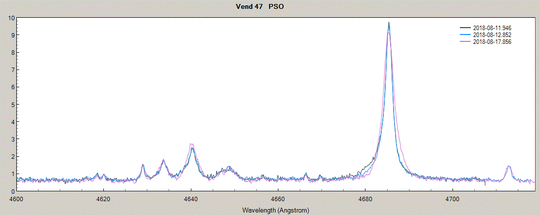

by Peter Somogyi
Interesting to learn how the eShels work, hope we can compare our dataset soon.
I decided to follow the HeII 4686 / N III region, a fresh result from yesterday (2 x 1200, 4 x 1200, 4 x 1200 s, R~8600):
The N III 4634 feature has changed a bit, and the He II 4686 velocity profile moved the most in this region.
- Peter

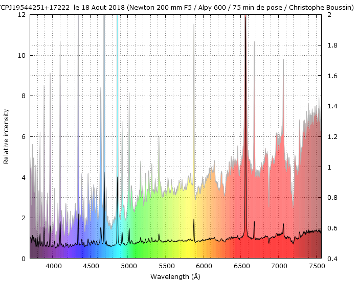

I obtained the following spectrum last night, August 18 at 21 h 29 TU with a resolution of 509 (JJ = 2458349.4237) and an acquisition time of 75 min (15 x 300 s) :
TCPJ19544251+17222 on August 18, 2018
_tcpj19544251+17222_20180818_896_Christophe Boussin_3700_7570.png (104.64 KiB) Viewed 27028 times

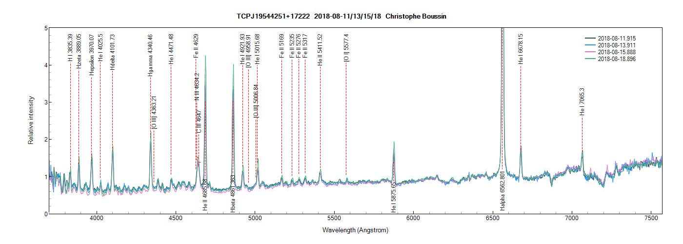

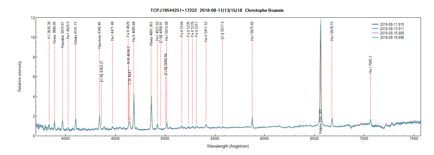

The comparison of spectra obtained between August 11 and 18 show an increase in the relative intensity of the lines at low resolution :
TCPJ19544251+17222 on August 11th, 13th, 15th and 18th, 2018
TCPJ19544251+17222 on August 11th, 13th, 15th and 18th, 2018 (zoom)

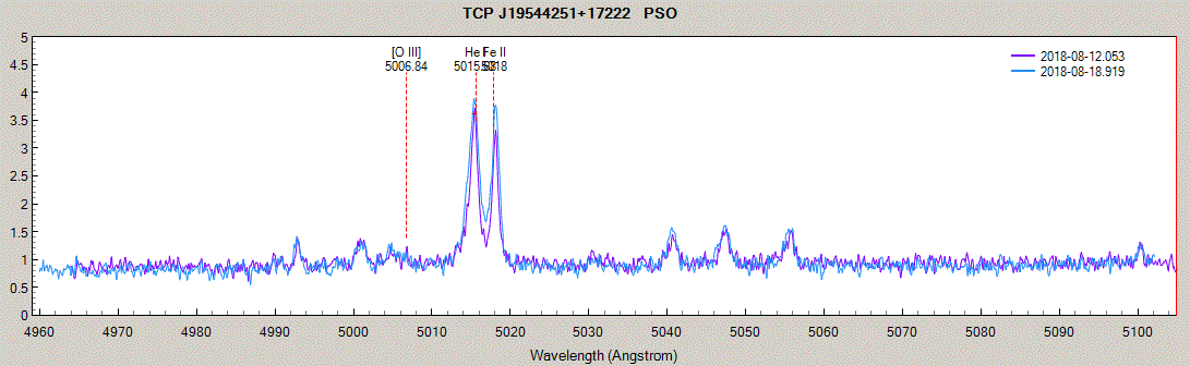

by Peter Somogyi
Nice and valuable serie Christophe with so many prominent lines measurable, hope you can continue!

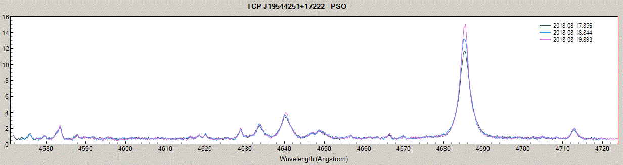

Here is the weekend progress:
The HeII 4686 peak increased linearily without profile change, whilst the other features mostly remaied constant.
I did retry the O3 region:
There is certainly something -1 A away, but not where O III would be expected.
- Peter

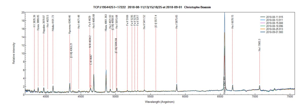

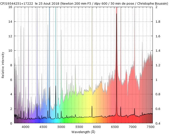

Enjoying the return of good weather, I obtained the following spectrum on August 25 at 21 h 54 TU with a resolution of 523 (JJ = 2458356.4301) and an acquisition time of 50 min (10 x 300 s) :
TCPJ19544251+17222 on August 25, 2018
_tcpj19544251+17222_20180825_913_Christophe Boussin_3700_7570.png (103.8 KiB) Viewed 26943 times

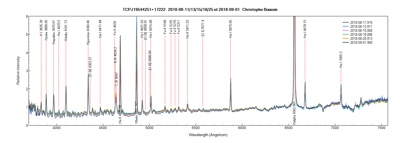

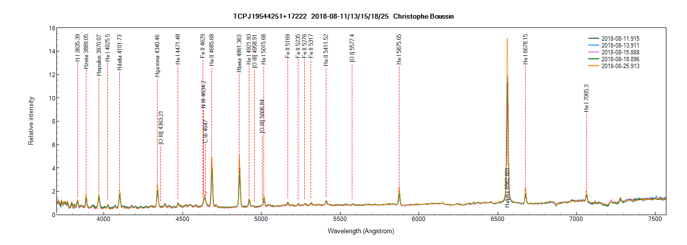

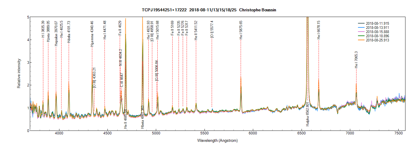

The comparison of the spectra obtained between August 11 and 25 shows an increase in the relative intensity of the lines and especially between August 18 and 25.
TCPJ19544251+17222 on August 11th, 13th, 15th, 18th and 25th, 2018
This increase is clearly visible on the Balmer lines and HeII line at 4686A but the [OIII] lines remain undetectable at low resolution.
TCPJ19544251+17222 on August 11th, 13th, 15th, 18th and 25th, 2018 (zoom)

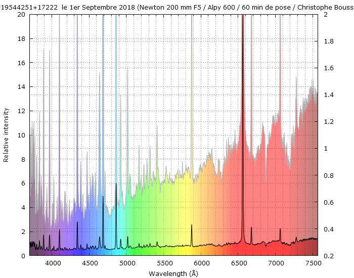

After a beautiful sunny afternoon, I obtained the following spectrum on September 1st at 21 h 36 TU with a resolution of 507 (JJ = 2458363.421) and an acquisition time of 60 min (12 x 300 s) :
TCPJ19544251+17222 on September 1st, 2018
_tcpj19544251+17222_20180901_900_Christophe Boussin_3700_7570.png (109.71 KiB) Viewed 26813 times

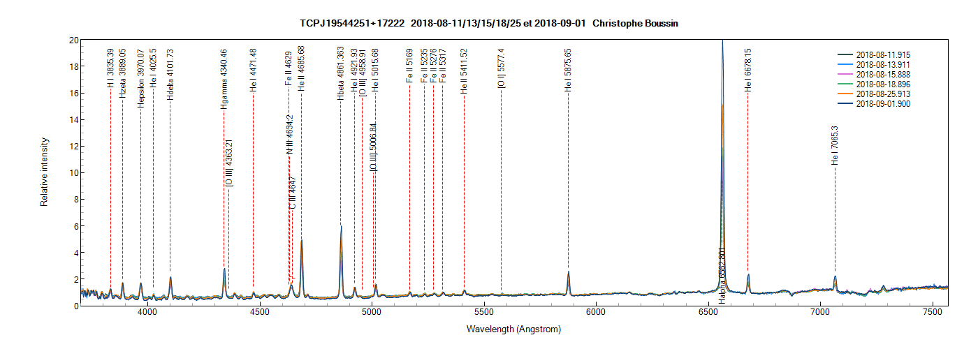

The comparison of the spectra obtained between August 11 and September 1st clearly shows an increase in the relative intensity of the Balmer lines since August 18.
This increase is particularly evident for the Halpha line and especially between 25 August and 1 September.
TCPJ19544251+17222 on August 11th, 13th, 15th, 18th, 25th and 1st September, 2018
Has anyone else noticed this evolution ?
The relative intensity of the HeII line at 4686A remains unchanged since August 25.
The [OIII] lines at 4363, 4959 and 5007 are always undetectable at low resolution.
TCPJ19544251+17222 on August 11th, 13th, 15th, 18th, 25th and 1st September, 2018 (zoom)

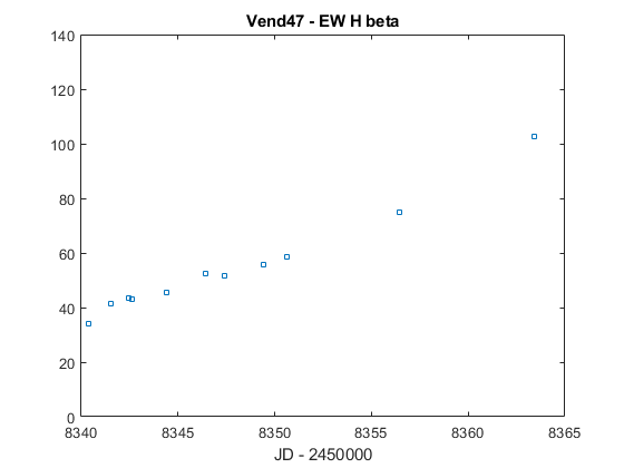

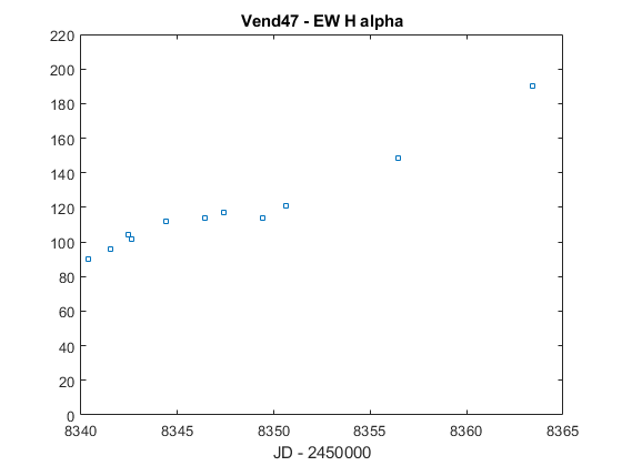

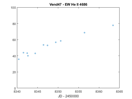

Posted: Wed Sep 05, 2018 10:38 am
Belle série, Christophe!
The outbust is declining (~ 0.4 mag below the maximum)
Equivalent widths from selected spectra of the database
Vend47 H alpha.png (12.39 KiB) Viewed 26777 times
Vend47 H beta.png (10.4 KiB) Viewed 26777 times
Vend47 He II 4686.png (9.66 KiB) Viewed 26777 times
Confirmation of Christophe observations
Further observations of the decline are welcome at low resolution.
Temperature of the hot component will increase and high ionization lines are expected, notably [Fe VII] and perhaps Raman OVI
