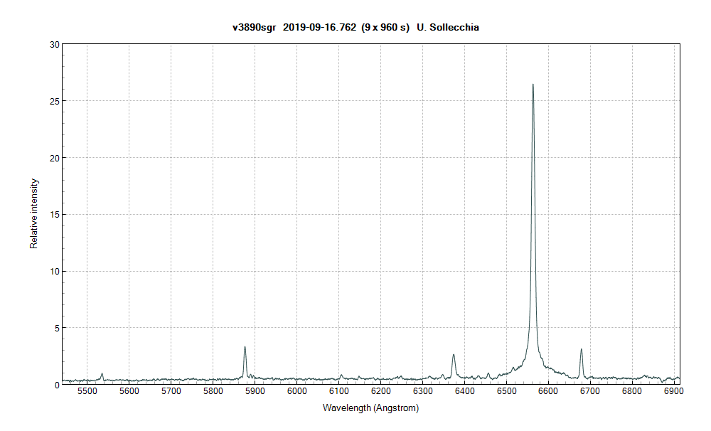

by umberto sollecchia
Bonsoir, voici le profil de l'observation de ce soir 16-09-2019.
v3890sgr_20190916_762_U. Sollecchia.png (26.46 KiB) Viewed 10907 times

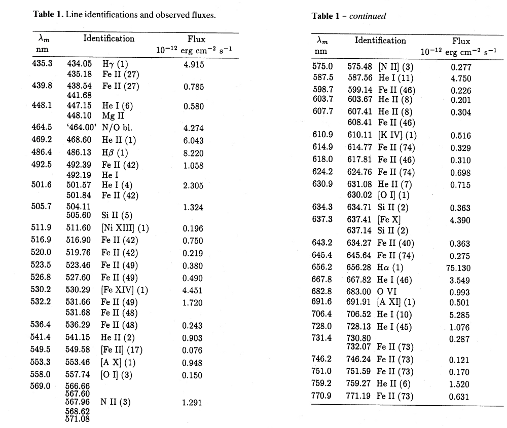

Nice spectrum Umberto! What instrument are you using?
What are the minor emission lines?
Re: Eruption of recurrent nova V3890 Sgr
Posted: Wed Sep 25, 2019 4:19 am
Lines identified in a spectrum obtained +18 days after maximum during 1990 outburst
http://articles.adsabs.harvard.edu/pdf/ ... .269..105A

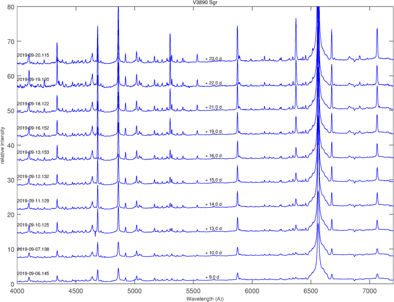

Posted: Wed Sep 25, 2019 4:23 am
Recent evolution

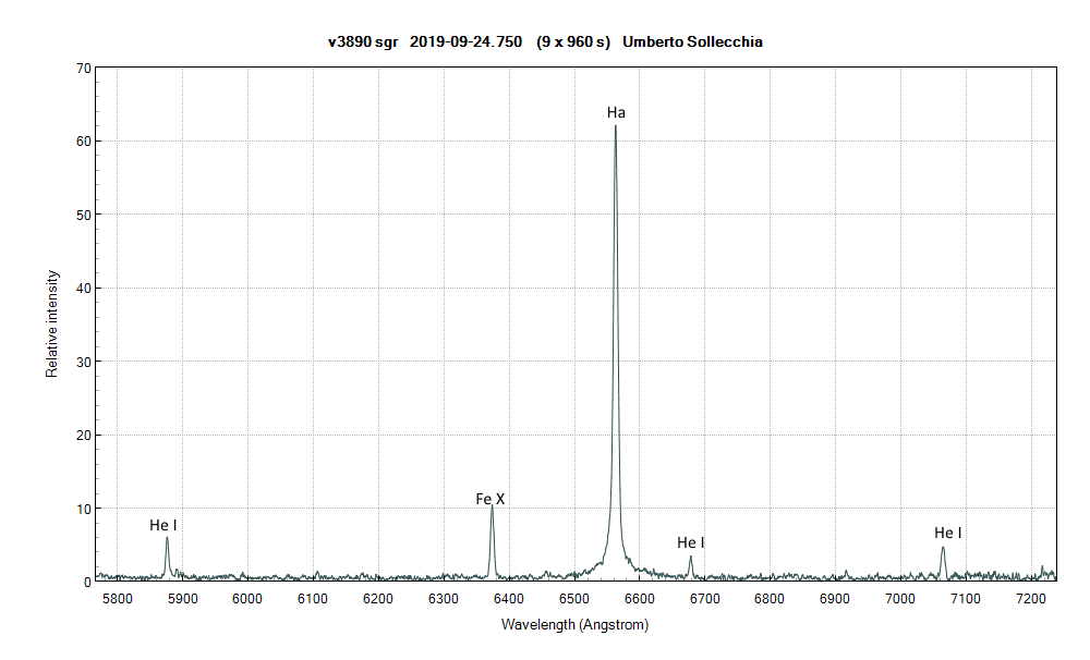

Bonjour Ahmsh, merci beaucoup, j'ai utilisé le LhiresIII avec une grille de 600l / mm. et un C9.25 ".
Merci François pour la liste des lignes d'identification.
J'attache le profil d'observation du 24/09/2019, même configuration, la nova était de magnitude 13.
Salut.
v3890sgr_20190924_750_U. Sollecchia.png (29.04 KiB) Viewed 10739 times

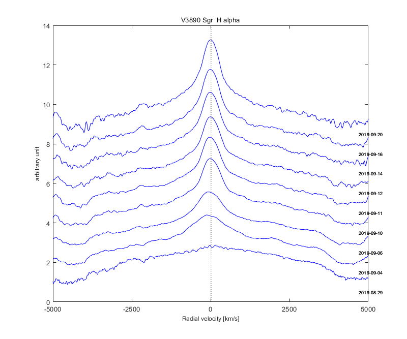

H alpha line from spectra obtained by Umberto at reolsution 5000 to 2000
log(Intensity) shifted by +1 for each spectrum
v3890 sgr_Ha.png (47.09 KiB) Viewed 10704 times
