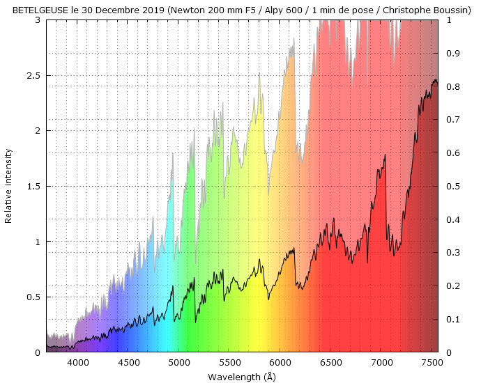

After a long period of cloudy nights, here is my contribution to the monitoring of Betelgeuse with two spectra.
The first one was obtained on December 29th, 2019 at 00 h 02 TU (Alpy 600, resolution 503, JJ = 2458847.502, 6 exposures of 10 s) :
Betelgeuse on December 29th, 2019
_betelgeuse_20191230_002_Christophe Boussin_3700_7570.png (97.85 KiB) Viewed 17364 times

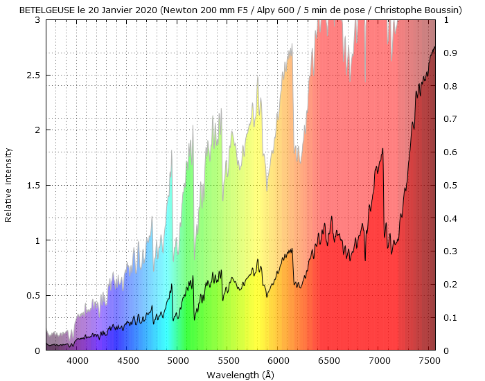

The second spectrum below was obtained on January 20th, 2020 at 20 h 49 TU (Alpy 600, resolution 501, JJ = 2458869.3675, 15 exposures of 20 s) :
Betelgeuse on January 20th, 2020
_betelgeuse_20200120_868_Christophe Boussin_3700_7570.png (95.4 KiB) Viewed 17364 times

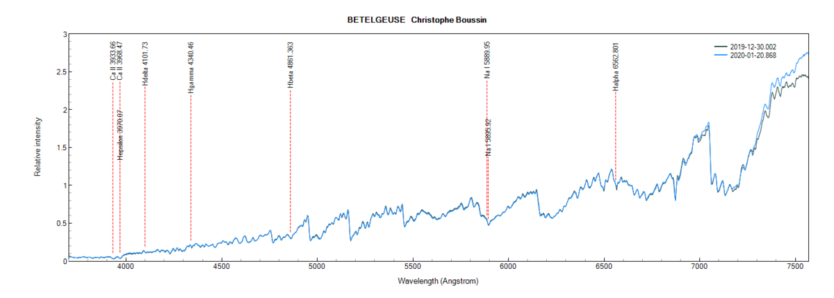

Comparison of the spectra :
BETELGEUSE on December 29th, 2019 and January 20th, 2020 (identification of some lines from PlotSpectra)
Since December 29, I have not noticed any significant changes in the spectrum of Betelgeuse except maybe in the red part of the spectrum ?

Hi Christophe,
My spectra also confirm the change you are seeing. There has been a continuing increase in the IR compared with the visible region this year (This is consistent with the decrease in V magnitude compared the H,J magnitudes in the AAVSO data)

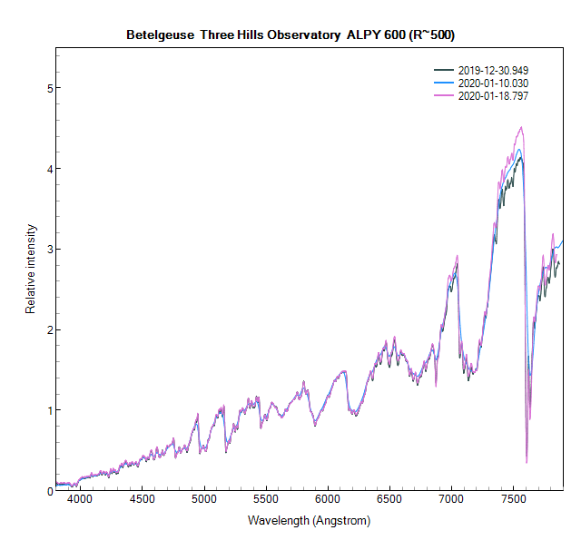

Here is my Betelgeuse spectra from 22 & 23 January 2020, shot with the Alpy600(22Jan20) and the LISA-IR(23Jan20):
All identified spectral lines are tentative. Lots of energy being pumped-out of this star in the IR!
