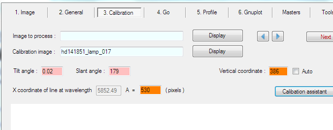

Peter Velez wrote:
Slant - I can measure it manually with ISIS and know roughly what it should be. However, with some calibration frames it adjusts automatically to an odd result - I know my slant is around 0.12 degrees. With some calibration images it jumps to 3 or 4 degrees negative. If there were an option to turn off the automatic slant and tilt measurement I could be more accurate with calibration
Hi Peter
What is this automatic slant measurement ? I have not seen this before in ISIS. (Is this using the calibration assistant? I don't use that) I just use the measured slant which ISIS automatically enters in the box and it then uses this figure for all data reduction until I tell it otherwise. (see attached screen shot, dont worry about the crazy slant angle in the image it is not real !)
The slant measurement is made by drawing a box tightly round a well exposed isolated line near the centre of the field covering the height of the line between the outer sky background limits.

I measure the slant and tilt in the manner you suggest. However, when I run the Calibration Assistant, ISIS seems to measure slant and tilt again, populates the fields on the screen in the way you illustrated and then determines the calibration fit. What I find is that on occasions the slant and tilt automatically filled depart wildly from what I have measured - usually when the calibration fails.
Unfortunately, I rely on Calibration Assistant to refine the calibration. Using either the Predefined mode or a .lst file, I rarely achieve an RMS below 8 (though yesterday a few test calibration frames did work). So I then use Calibration Assistant to tighten up the match. For example, I just calibrated using the .lst file applying the lines David suggested yesterday. I manually set the slant (0.13) and tilt (-0.13) that I measured and achieved an RMS of 3.4. I then ran the Calibration Assistant. It corrected the slant to 0.23 and tilt to 0.01 and achieved an RMS of 0.19.
This is when I have a calibration frame that ISIS likes. Changing to another Ar Ne frame - 10 seconds rather than 20 but taken at the same ambient temp and using the same method, I achieve an RMS of 8.5. I measured the slant and tilt for that data set at 0.08 and -0.08. Running the Calibration Assistant, the slant and tilt are auto corrected to -11.80 and 0.01 respectively. The tilt is acceptable but the slant is way off. As a result, the RMS achieved is only 4.97. Better, but not usable. I attach a screenshot.
I can overcome this by taking multiple Ar Ne frames at different exposure lengths and thereby determine which works. Sometimes longer exposures work better and other times not - probably because my focus is not tight enough. At least I have a handle now on why the calibration may be failing. It would be great if I could achieve a reliable calibration with the .lst file every time - which I can when not binning my images. More work to be done!
