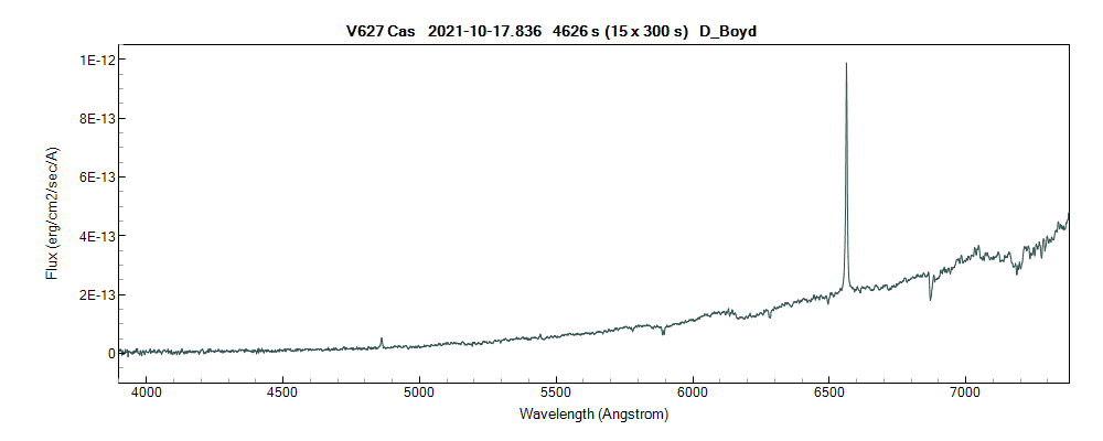

Here is a spectrum of V627 Cas taken on 17th October with a LISA spectrograph. The spectrum has been calibrated in absolute flux using a concurrently measured V magnitude of 11.99. The spectrum has been submitted to the ARAS database.
