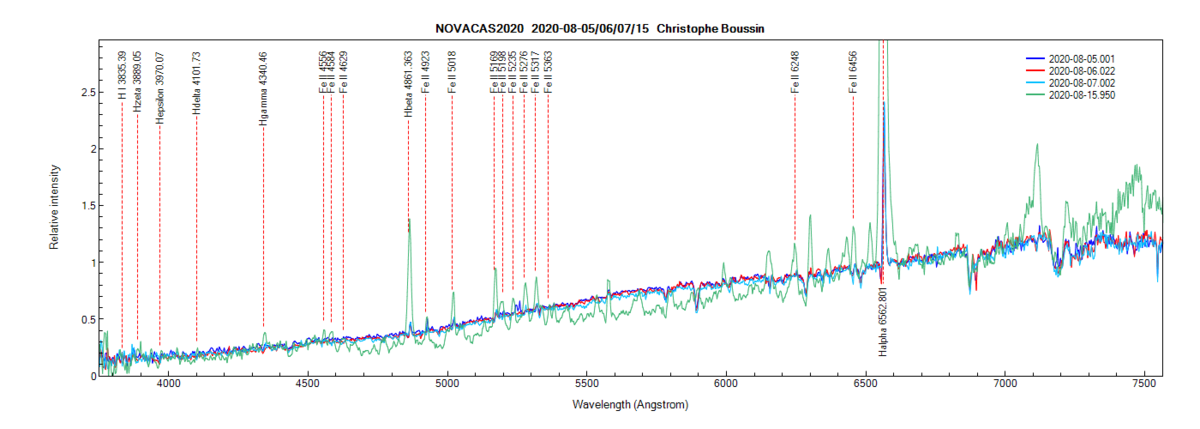

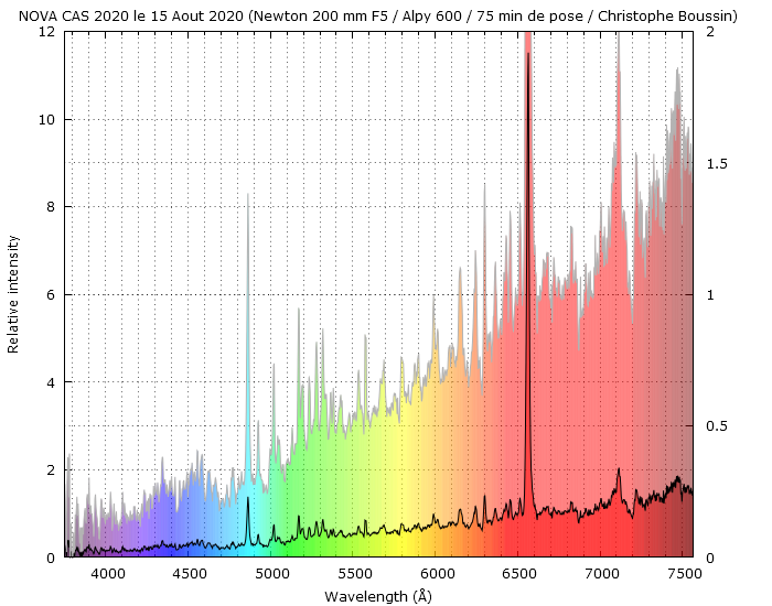

I obtained the following spectrum of the nova Cas 2020 the 15th of August at 22 h 48 TU with my Alpy 600 (resolution of 507, JJ = 2459077.4501) and an acquisition time of 75 min :
- Nova Cas 2020 on August 15th, 2020
- _novacas2020_20200815_950_Christophe Boussin_3750_7565.png (89.63 KiB) Viewed 9958 times
- Nova Cas 2020 on August 5th, 6th, 7th and 15th, 2020 (identification of lines from PlotSpectra)
As in the spectrum of Vincent, I note a very strong increase in the relative intensities of the Balmer and Fe II lines, the modification of the shape of the Halpha line and the development of new lines !!
Good luck and clear skies to all for the monitoring of the nova !
Posted: Tue Aug 18, 2020 6:42 am
Yes!
You have also [O I] 6300. This is the [O I] flash: the ejecta is becoming optically thin in the visible range.
Recall: evolution of a classical nova Del 2013:
http://www.astrosurf.com/aras/novae/Nova2013Del-2.html with Steve Shore comments

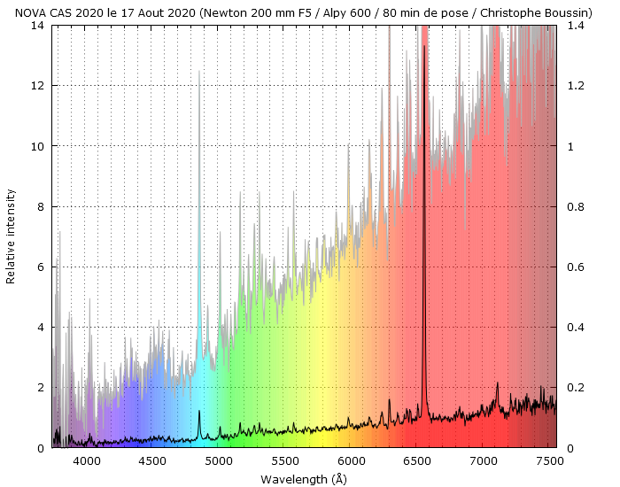

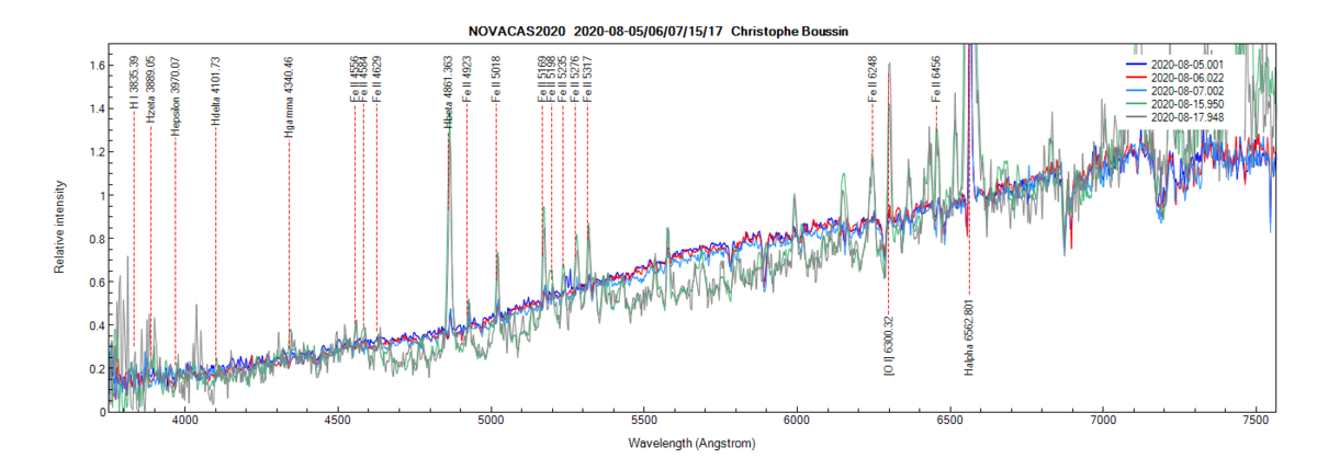

Taking advantage of a new more durable weather window, I obtained the following spectrum last night of the nova Cas 2020 the 17th of August at 22 h 45 TU with my Alpy 600 (resolution of 507, JJ = 2459079.4481) and an acquisition time of 80 min :
- Nova Cas 2020 on August 17th, 2020
- _novacas2020_20200817_948_Christophe Boussin_3750_7565.png (104.48 KiB) Viewed 9886 times
- Nova Cas 2020 on August 5th, 6th, 7th, 15th and 17th, 2020 (identification of lines from PlotSpectra)

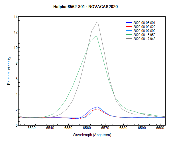

Evolution of the Halpha line :
- Halpha line on August 5th, 6th, 7th, 15th and 17th, 2020
- novacas2020_20200817_948_Christophe Boussin_Halpha.png (24.74 KiB) Viewed 9886 times
The relative intensity and the shape of the Halpha line seems to continue to change but, of course, this requires confirmation at high resolution...
Evolution of the [OI] line :
![[OI] line on August 5th, 6th, 7th, 15th and 17th, 2020](./download/file.php?id=7071&sid=a916160ea36b7ff39ae7a99c47ec864b)
- [OI] line on August 5th, 6th, 7th, 15th and 17th, 2020
- novacas2020_20200817_948_Christophe Boussin_OI.png (26.79 KiB) Viewed 9886 times
The relative intensity of the [OI] line seems to have increased since the 15th...to be continued

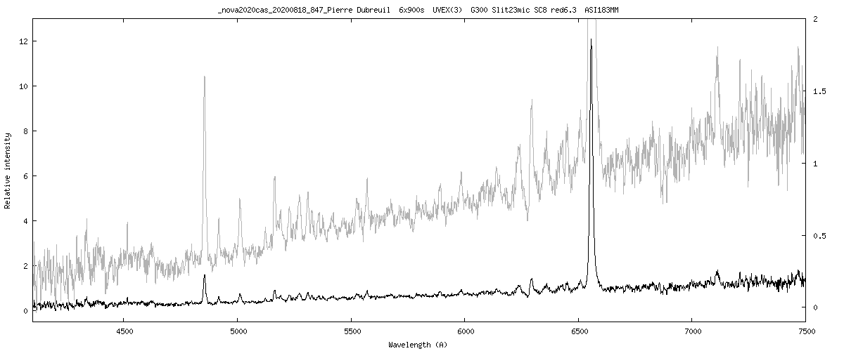

Clear sky last night for the NOVA
UVEX(3) SC8 red6.3 6x900s

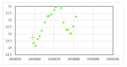

The nova shows oscillations at maximum.
- novacas.PNG (5.84 KiB) Viewed 9806 times
The light curve is atypical for a classical , with a very slow rise and now the oscillations.
Daily monitoring at all resolutions is encouraged.
