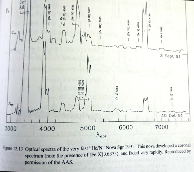

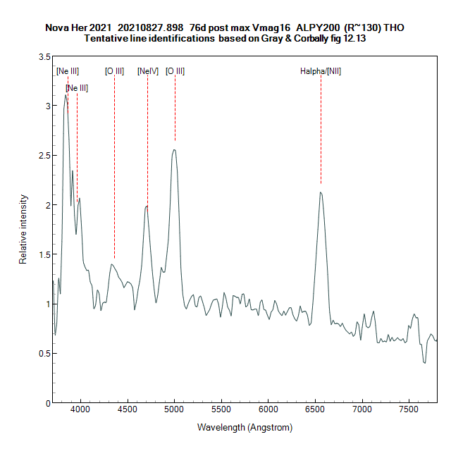

Now mag 16 so time to use the ALPY200 at R~130
Line identifications are based on a spectrum of another very fast nova Sgr 1991 in Gray and Corbally at similar date which looks very similar but should be treated with caution at this resolution.
If it is the same as nova Sgr 1991 there could be very strong [Ne V] lines at 3346/3428 A . Too far into the UV for me but perhaps a good target for the UVEX ?
