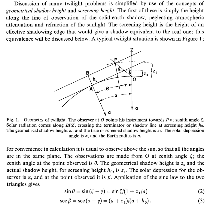

I described previously the terrestric origin of Na-airglow visible in some spectra. In the meantime I also looked at the literature (with the help of Peter Schlatter) and found some supporting literature. Very profound and giving all the relevant details is the following review by D.M. Hunten:
http://adsabs.harvard.edu/abs/1967SSRv....6..493H
From this the geometry of the Na layer illumination can be seen in more detail:
geometry of sun Na-layer and observer
twilight geometry.png (135.08 KiB) Viewed 12972 times
together with some equations for the calculation of the shadow effect. It confirms my basic assumptions. To be more precise I should have talked about resonance scattering instead of fluoroscence.
Much more about the phenomenon can be found in the article. Nowadays the observation of the Na airglow is not so important any more, more precise measurements of the height and density of the layer can be made with LIDAR especially also for the Na layer as a guide star for adaptive optics.
Since the effect varies quite fast during twilight, it is important to subtract the background taken under similar conditions (same sun elevation at the same sky elevation).
Regards, Martin

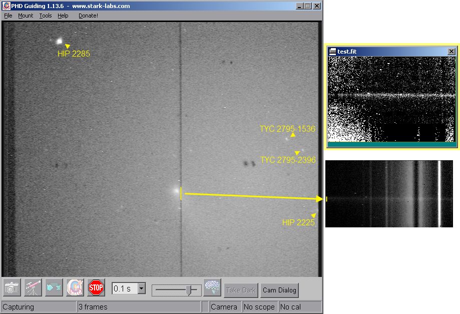

After what has been presented, I feel somewhat ashamed for this post, because it is a very noisy and bad spectrum.. But I tried to go after the tail, and it is difficult.. I also think the resolution I have of the light pollution is very low, so something was likely done wrong.. (collimator focus? Too fast F/6.8 refractor?)
WO-80mm F/6.8 (I know I am wasting light, but I wanted the focal length)
LhiresIII + 300l/mm
KAF-402 binned 3x3 3x300s :-(
slit view + 2D spectrum + sky subtracted spectrum
slit view + 2D spectrum + sky-subtracted spectrum

Fil, as you can see on a light curve:
http://www.aerith.net/comet/catalog/2011L4/2011L4.html
Pan-STARRS comet decreased its brightness from mag 0-1 at mid march to mag 4-5 at the time of your observation. Ok for decreased twilight but there is a 40x factor in brightness intensity! Furthermore you observed outside false nucleus and coma.
Anyway your observation confirms that now there isn't any relevant D1D2 emission in comet tail and around coma (I note no intensity into HPS self-absorption). Na emission was also weak (EW -1.8A) at nucleus in last Robin observation.
Concerning resolution I suspect can be caused by the thermal gradient if you spent a lot of time between the doublet set-up and the start of spectrum capturing. Otherwise I have no idea...
