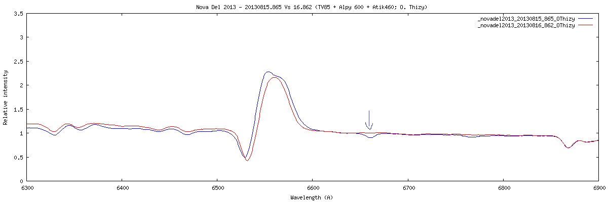

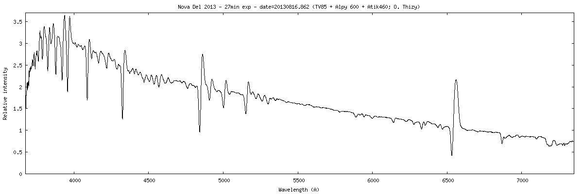

after some cloudy evening, the sky go clared and this is my third nght in a row on the new nova. It is brighter than last night and I had to shorten my individual exposure from 5min to 3min. Equipment is still my small 85mm refractor and Alpy 600 spectrograph with Atik 460EX (-10°C) camera.
Spectrum is very nice but I see several changes compared to last night. The P Cygni profile are less pronounced (blue absorption less visible compare to last night) specially on Fe lines. Halpha changed profile and the line at 6660A (He I 6678A blue-shifted at a speed of ~800km/s!) disapeared. Not sure what is hapening there...
I am now using hd196544 as reference star and MILES database in ISIS to calculate the instrumental response of my setup. But I do not take into account difference in airmass.
