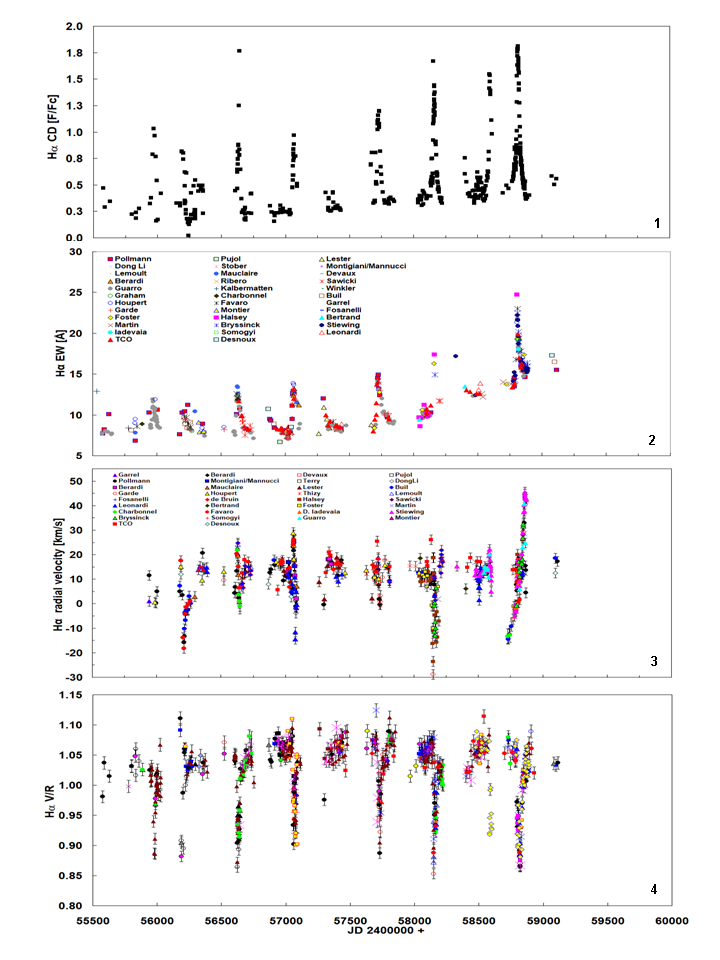

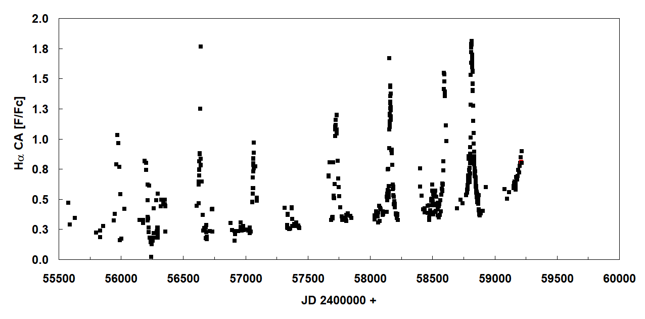

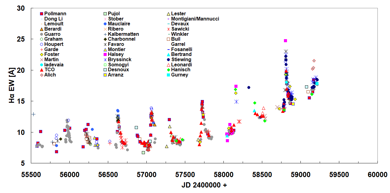

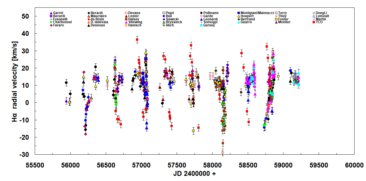

The observation period of 28 Tau has began.
A wonderful opportunity to complement our monitorings of the central depth (1), EW (2), radial velocity (3) and V/R (4) of Halpha.

Dear colleagues,
don´t forget to observe the next periastron passage on February 1th 2021!!
This time there are very good opportunities to observe totally the rise and the descent of the parameters EW, V/R, RV and CA.
Posts: 461
Re: 28 Tau ARAS monitoring
Post by Ernst Pollmann »
Dear colleagues,
Attached you can see the current state of observations.

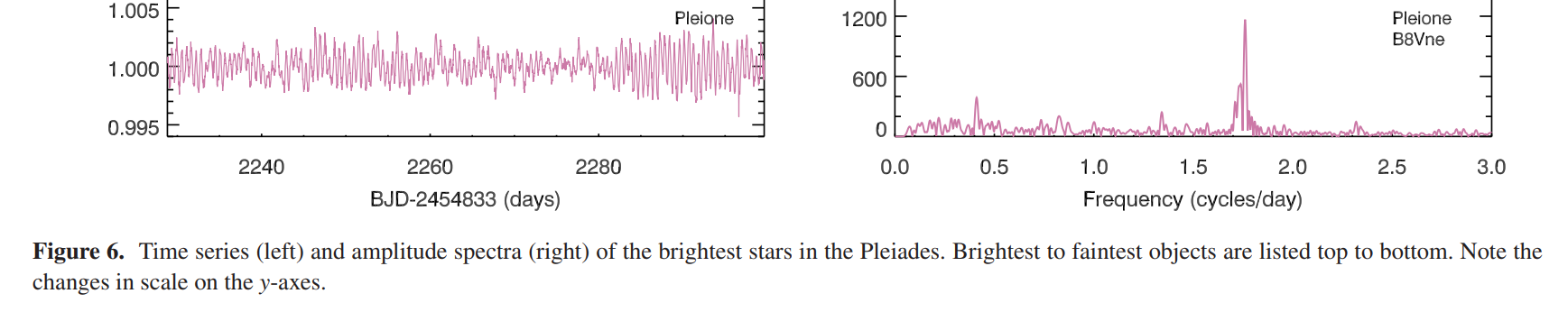

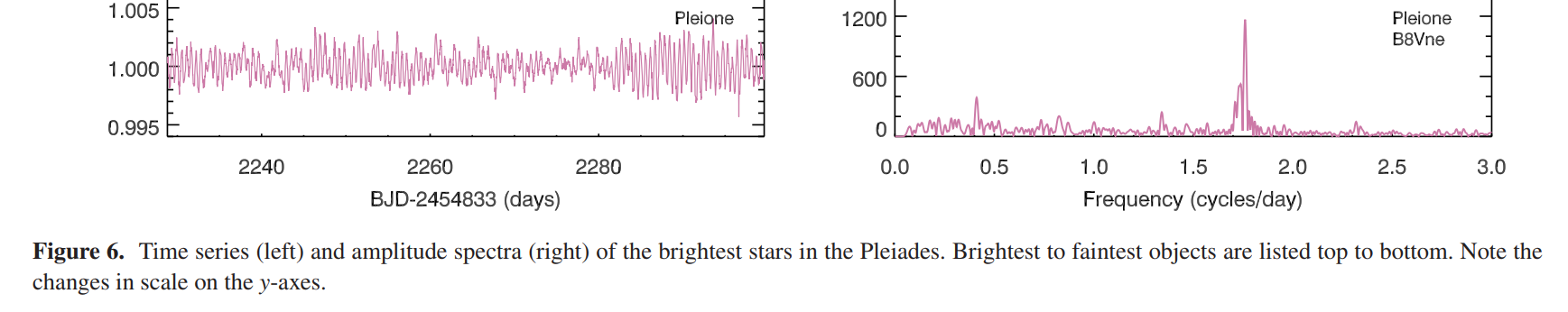

Pleione (and the other bright members of the Pleiades) was observed by K2, as shown in the Fig. below (from White et al. 2017; 2017MNRAS.471.2882W). Pleione has photometric signals similar to other Be stars of relatively late spectral type (probably mostly SPB pulsation).
However, I think the TESS data will be even more interesting, especially if the September 2021 periastron is well observed with spectroscopy. For the K2 data, it was extracted and processed in a way that removed low frequency signals, so it got rid of any signals that may arise from tidal changes in the disk (like probably what causes the observed spectroscopic behavior). The TESS data can be processed more carefully to keep these longer-term signals intact. Especially since Pleione is in a shell phase, tidally-induced disk variability near periastron, should, I expect, cause photometric variability.

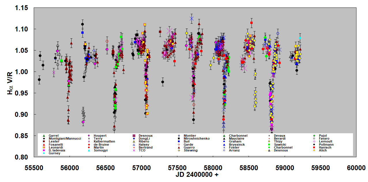

This next plot shows data from Halpha on BeSS over the past few years (similar to Ernst's plots), and the shaded rectangles show the TESS observing window (but propagated back in time according to orbital phase). The point is, the shaded rectangle shows the sort of spectroscopic activity that will probably happen during TESS observing. The horizontal black bar shows the orbital phase that K2 observed.
Also, I am very many years late to the party for 28 Tau, but is it perhaps interesting that in the plot of V/R, there seems to be 'extra' structure shortly after periastron? I mean that there seems to be a first quick spike (like near 8800 in my plot) on top of the bigger and slightly slower signal. I must caution that I haven't looked at the data very closely.
