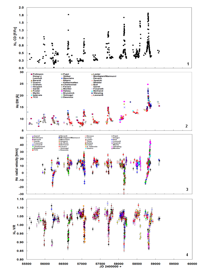

Re: 28 Tau ARAS monitoring
Posted: Sun Jan 10, 2021 9:21 am
by Ernst Pollmann
Dear colleagues,
don´t forget to observe the next periastron passage on February 1th 2021!!
This time there are very good opportunities to observe totally the rise and the descent of the parameters EW, V/R, RV and CA.
Attached you can see the current state of observations.

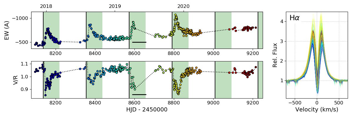

Posted: Sun Jan 24, 2021 4:14 pm
by J Labadie Bartz
Hi Ernst,
I'm looking ahead at interesting Be star targets that are being observed by TESS over the next ~1.5 years. 28 Tau ( = Pleione) is one of them- it is being observed by TESS for three months between 2021-Aug-20 - 2021-Nov-06. I believe this window also includes a periastron passage. Going by the ephemeris published in BLANK (...actually I can't find the paper now... will update when found), there is a periastron passage very late in August 2021
Ernst, do you expect periastron on/near this time?
Pleione (and the other bright members of the Pleiades) was observed by K2, as shown in the Fig. below (from White et al. 2017; 2017MNRAS.471.2882W). Pleione has photometric signals similar to other Be stars of relatively late spectral type (probably mostly SPB pulsation).
However, I think the TESS data will be even more interesting, especially if the September 2021 periastron is well observed with spectroscopy. For the K2 data, it was extracted and processed in a way that removed low frequency signals, so it got rid of any signals that may arise from tidal changes in the disk (like probably what causes the observed spectroscopic behavior). The TESS data can be processed more carefully to keep these longer-term signals intact. Especially since Pleione is in a shell phase, tidally-induced disk variability near periastron, should, I expect, cause photometric variability.
This next plot shows data from Halpha on BeSS over the past few years (similar to Ernst's plots), and the shaded rectangles show the TESS observing window (but propagated back in time according to orbital phase). The point is, the shaded rectangle shows the sort of spectroscopic activity that will probably happen during TESS observing. The horizontal black bar shows the orbital phase that K2 observed.
Also, I am very many years late to the party for 28 Tau, but is it perhaps interesting that in the plot of V/R, there seems to be 'extra' structure shortly after periastron? I mean that there seems to be a first quick spike (like near 8800 in my plot) on top of the bigger and slightly slower signal. I must caution that I haven't looked at the data very closely.
-Jon
